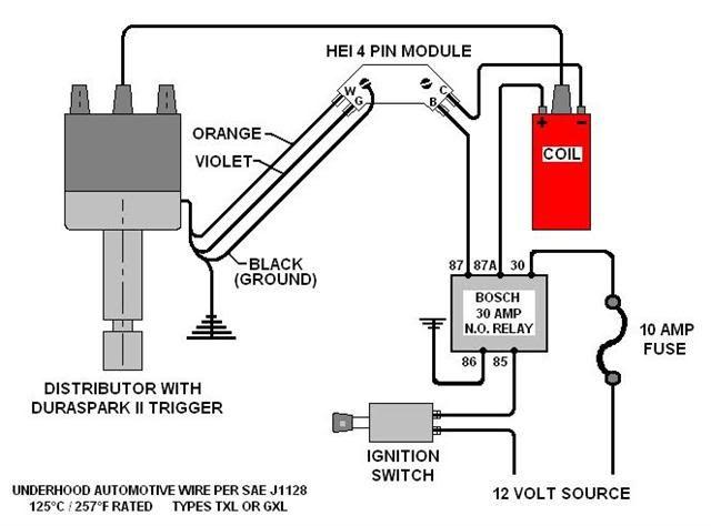

    You can HEI convert without the hideous giant cap using a Duraspark distributor. Popular in newer truck and other circles. Just use a coil compatible with the HEI module. Alternately you could run a complete Duraspark setup.
    Google "Ford HEI module conversion" and you will get lots of threads on the conversion.
