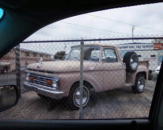

    I have the opportunity to trade my o/t daily driver for a 1964 Ford F100, what are your thoughts? It's a 6cyl, 3 spd(on the floor :() Has some new chrome. Needs bodywork(not a biggie cause that's what I do), no floor in bed. The cab floors seem solid.
    What are problem area's I need to watch for? Any advice on trading a reliable(albeit high mileage) auto for an old truck?
    My wife is a little unsure but is being very supportive, she knows that I am an old car nut. So she is trying to understand. She did suggest that I ask the thoughts of everyone here.

    It's a 98 Nissan Altima, 194 k, wife bought it new. I don't think the trucks engine has been rebuilt, well it's had a spray can rebuild

    What engine is in there? Run a compression check and put a mechanical oil pressure gauge on the oil system to get an idea of the engine condition. As for a daily driver, I drove my '56 F100 with a stock 292, 3 speed and 3.73s for about three years as a daily driver, got about 20 miles to the gallon. After I swapped in the 429 and 4 speed the mileage dropped but I still drove it across the country twice.
    I say go for it if the motor is good. The missus has the other car so its no big deal if you have to work on the truck from time to time.

    I'd trade, but I like putting around in old ****. :p It most likely has a 223 which is tough as nails and they use a lot of Y block parts. Do a compression and vacuum test first, then drop the Nissan like a bad habit and get the truck and throw in a sheet of plywood for a bed. :D

    Decent lookin ole truck,but I would bet the front cab mounts are bad,they all are (around here) on those old fords, all the way up thru the 70s,and it definately wont handle like the nissan,It will feel like your gonna turn the truck over when you go around a sharp curve,Ive owned a few.
    I say if you like the truck and have a spare vehicle to drive if you need to,you have nothing to lose,I would trade.
    p.s. check to make sure the rag joint between the steering column and steering box is good before doing much driving,It should be pretty inexpensive to change if you need to.

    Is this really even a serious question to be asking here? Come on, look at this thing. If your wife's OT car is good and reliable for the family stuff, I don't think there is even a question on this. If the Altima had 100K miles, maybe, but not 200K. Not only is it ugly, but at that mileage anything could go wrong with it at any minute and cost some serious money to fix.
    Now that truck needs some work for sure, but at least it is worth fixing.
    Don't kid yourself on the mileage though if that is critical. No way the Ford is going to get the same kind of mileage as the Altima. And no, it isn't as "safe" either. But, that's not why we are here.
