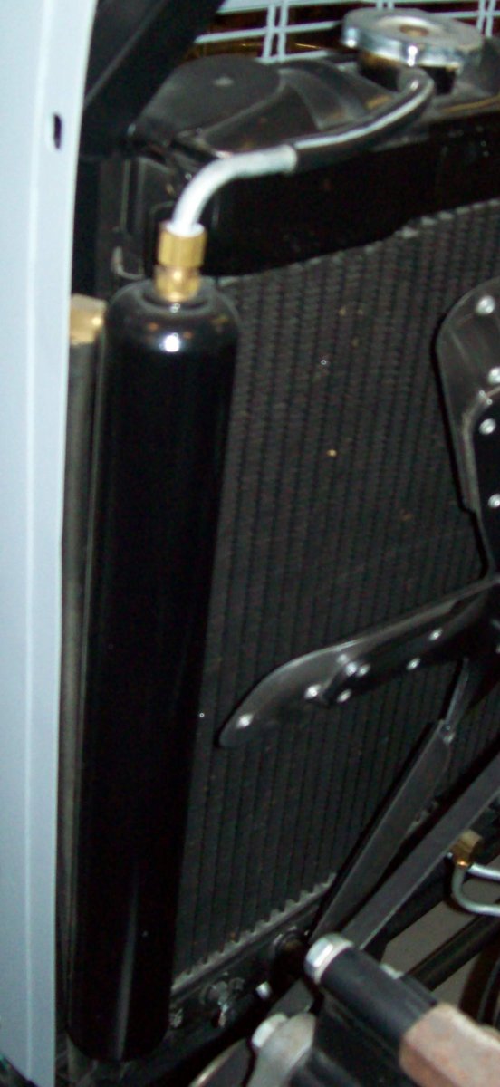

    Mine's nothing special. A piece of aluminum electrical conduit with end caps tigged in and the whole thing turned in a lathe. The compression fitting on top is drilled out so that the tube goes to the bottom making it a recovery system. I like to make stuff. 001.JPG
