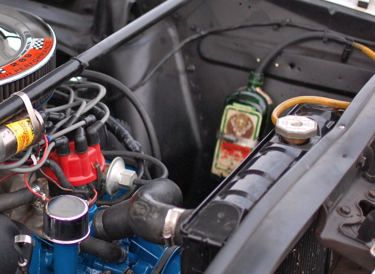

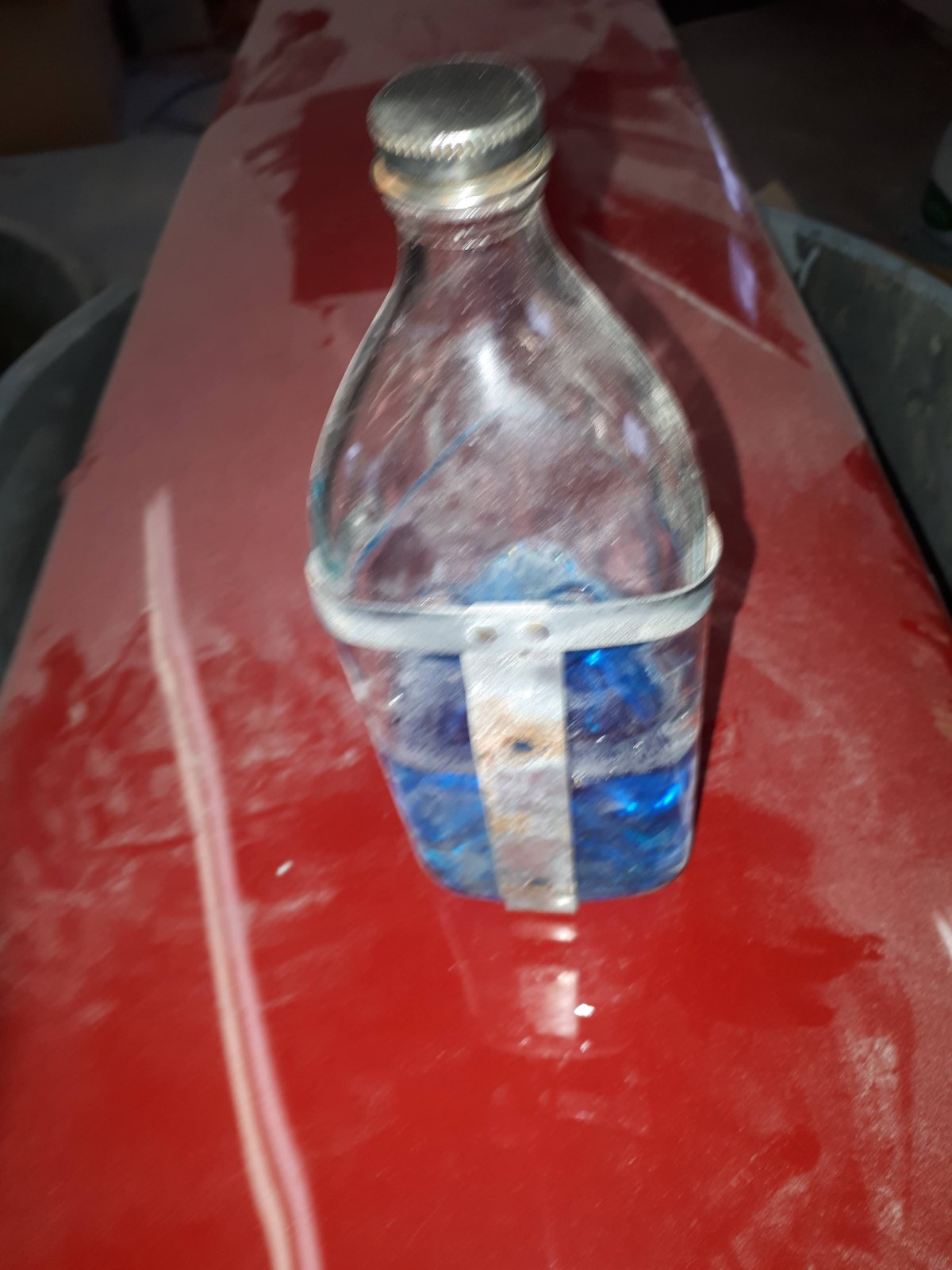

    DSC_8924.JPG Whiskey bottle. There's always plenty of them laying around by the end of a build.

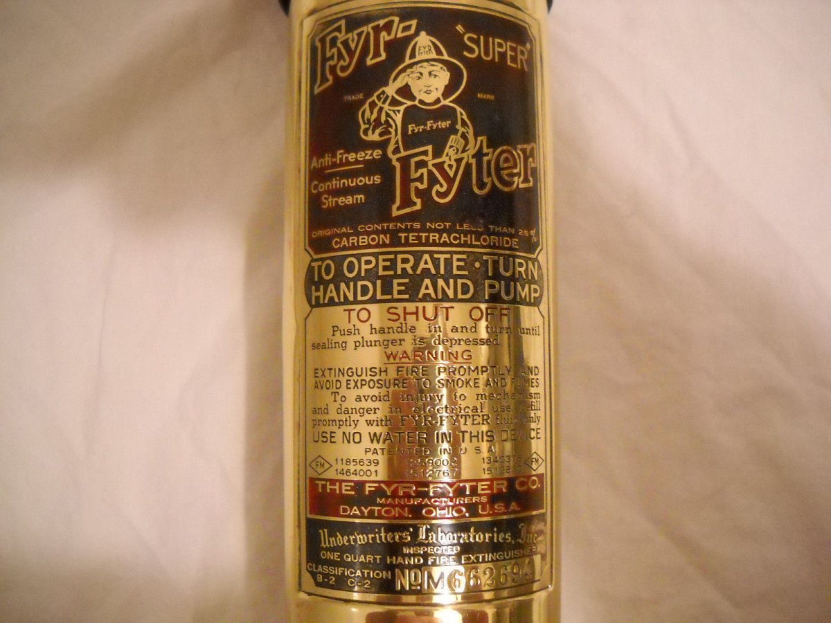

    I use an old pump style fire extinguisher. Tapped out the squirt nozzle and run a small hose from radiator to extinguisher. Mounted on firewall, not many people realize what I'm using it for.

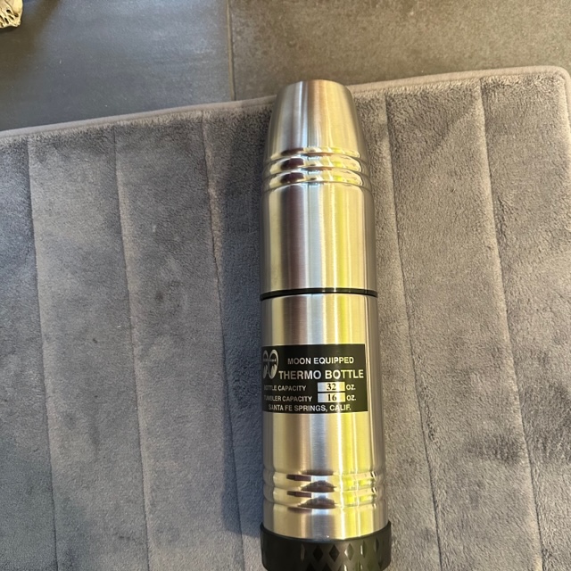

    Like this one? I will be using this for my bottle.

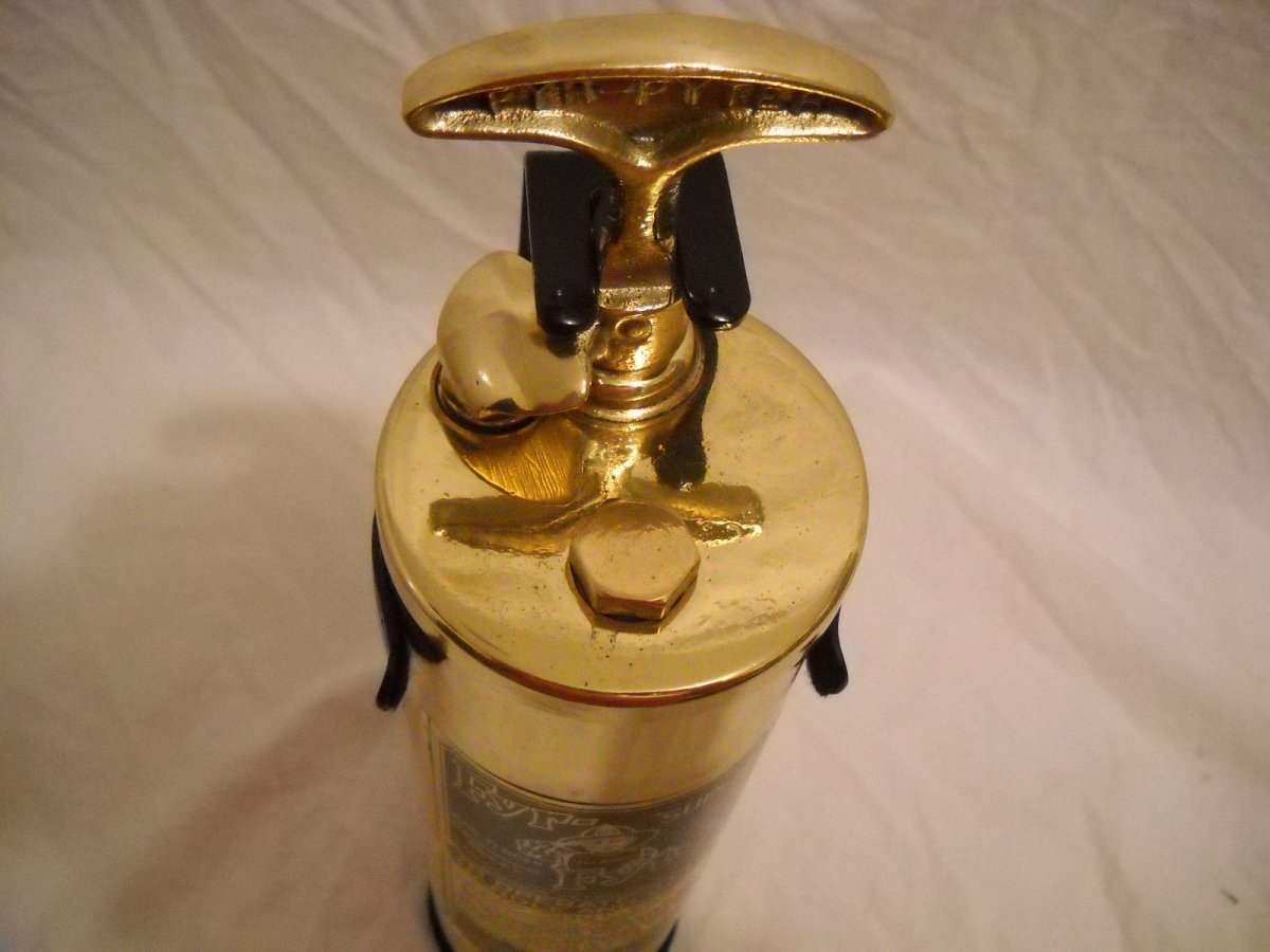

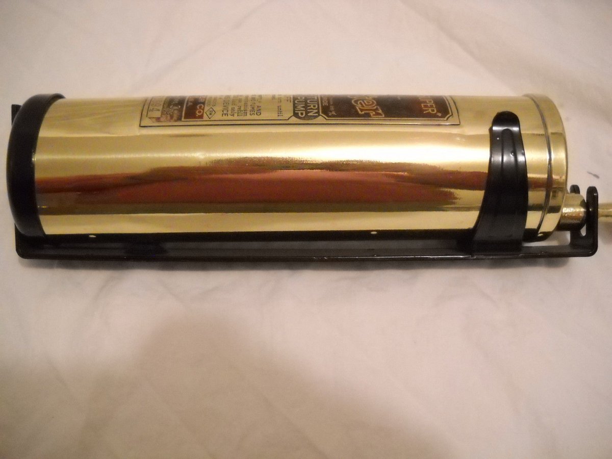

    Pyrene fire
    xtinguisher

    I have a similar fire extinguisher for mine.

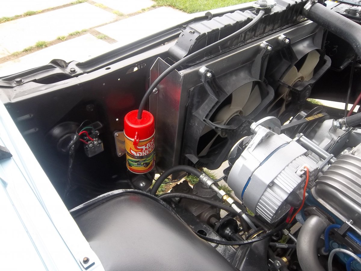

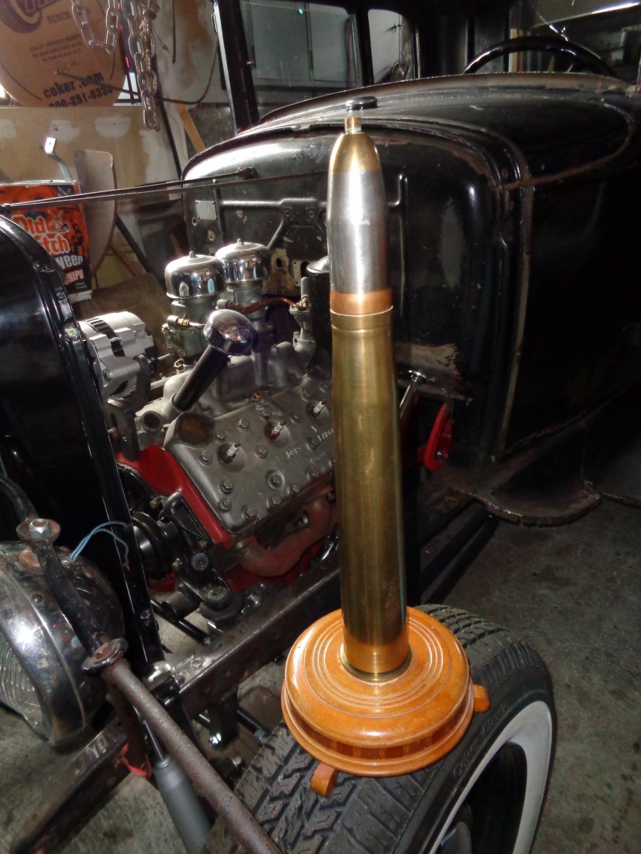

    I have considered using this old 40mm artillery shell that was re-purposed as a lamp once already.

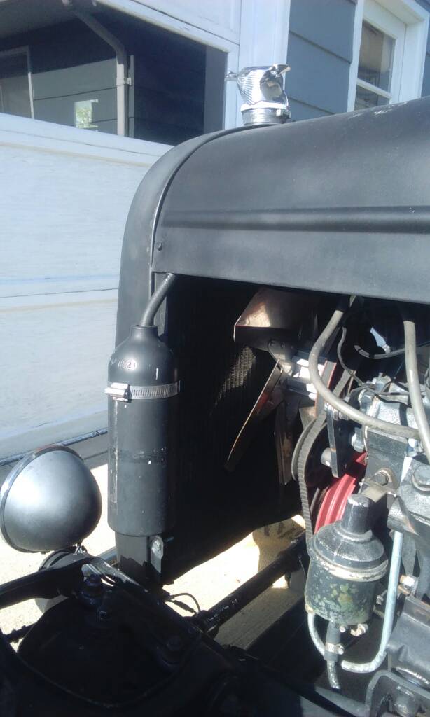

    I had posted earlier that I use a CO2 canister from a paintball gun. Finally got a picture. 1495602334011.jpg 1495602345010.jpg

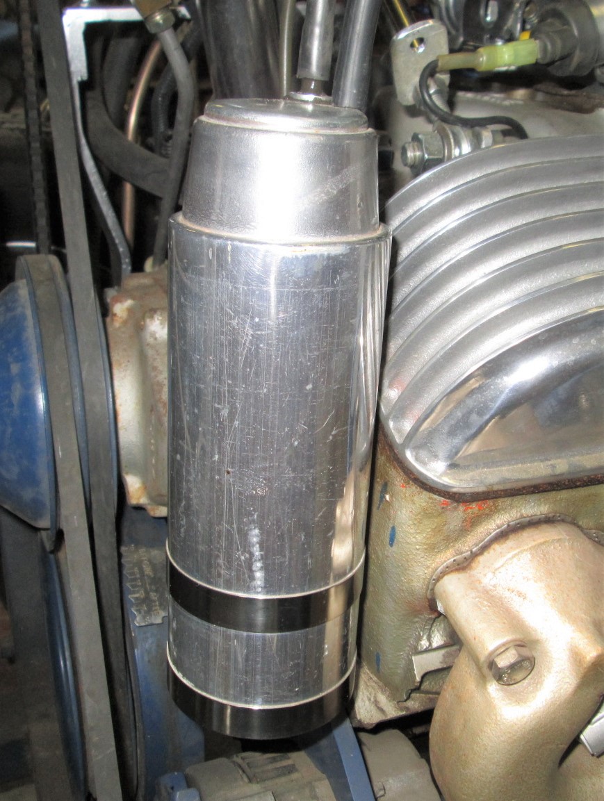

    Home made. Starting at the bottom...aluminum angle for mounting bracket, 2 hose clamps, s**** piece of 2.5" thick wall aluminum pipe, a piece I cut off of an old barstool, a soft plug (core hole plug to you purists), 2 pieces of 1/4" tubing, and some JB weld.
    Works!.

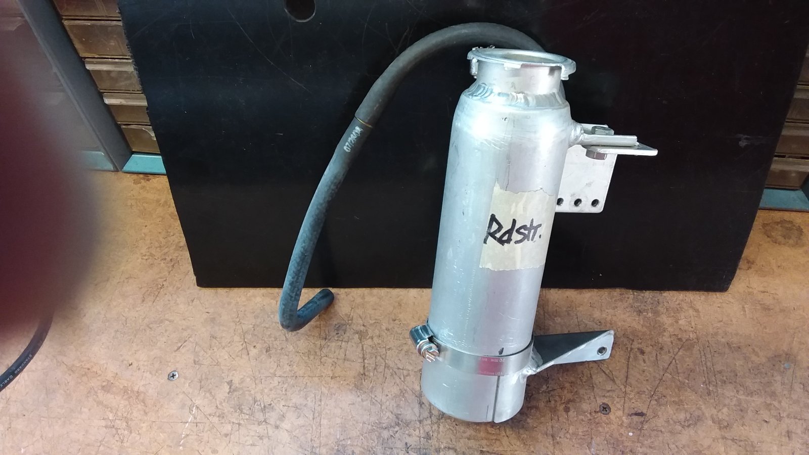

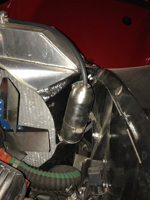

    I think this was originally an A/C receiver/drier canister, built it many years ago, don't recall the application.

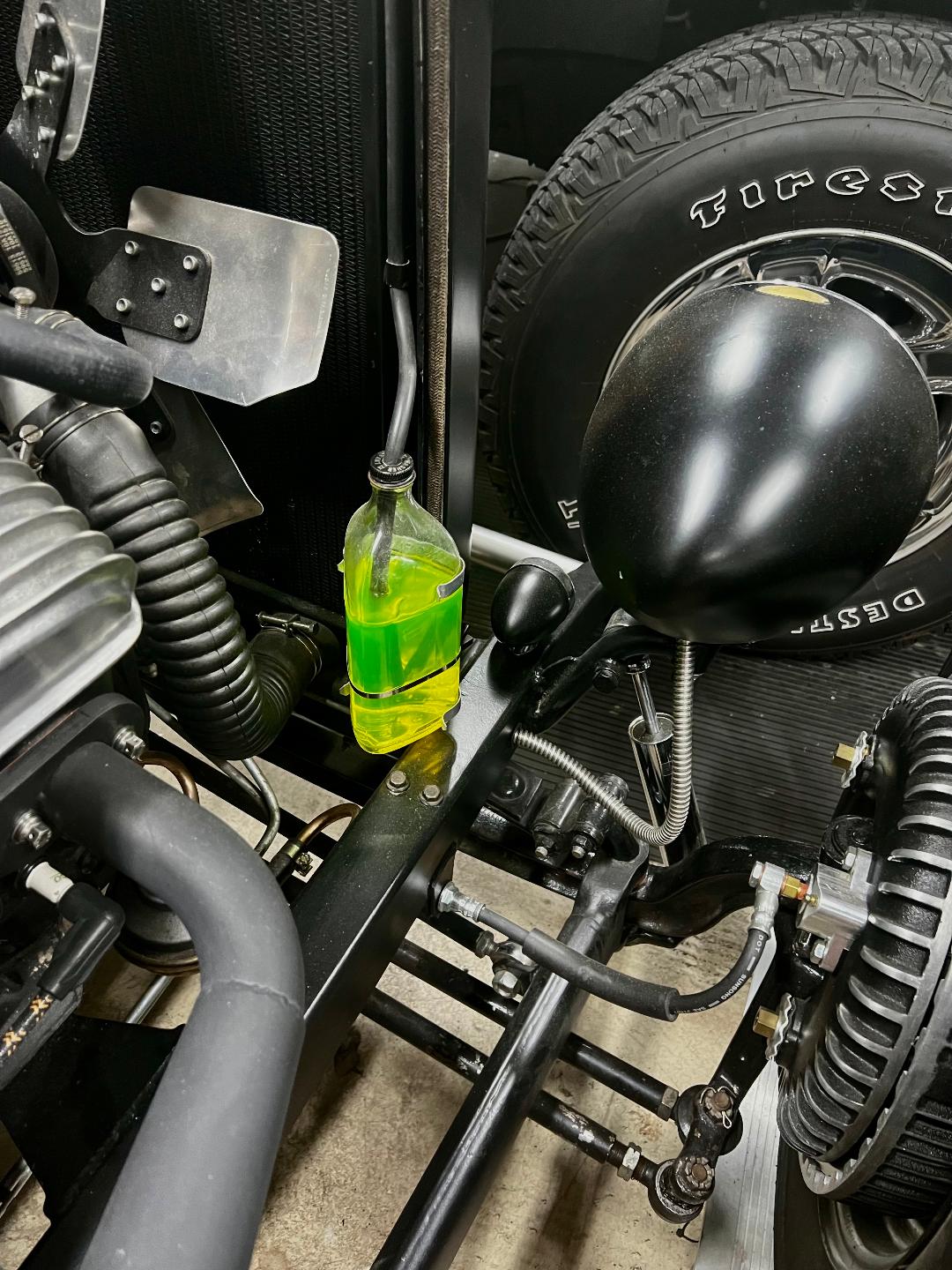

    I ended up using another Gatorade bottle. It’s out of sight, and does the job.
