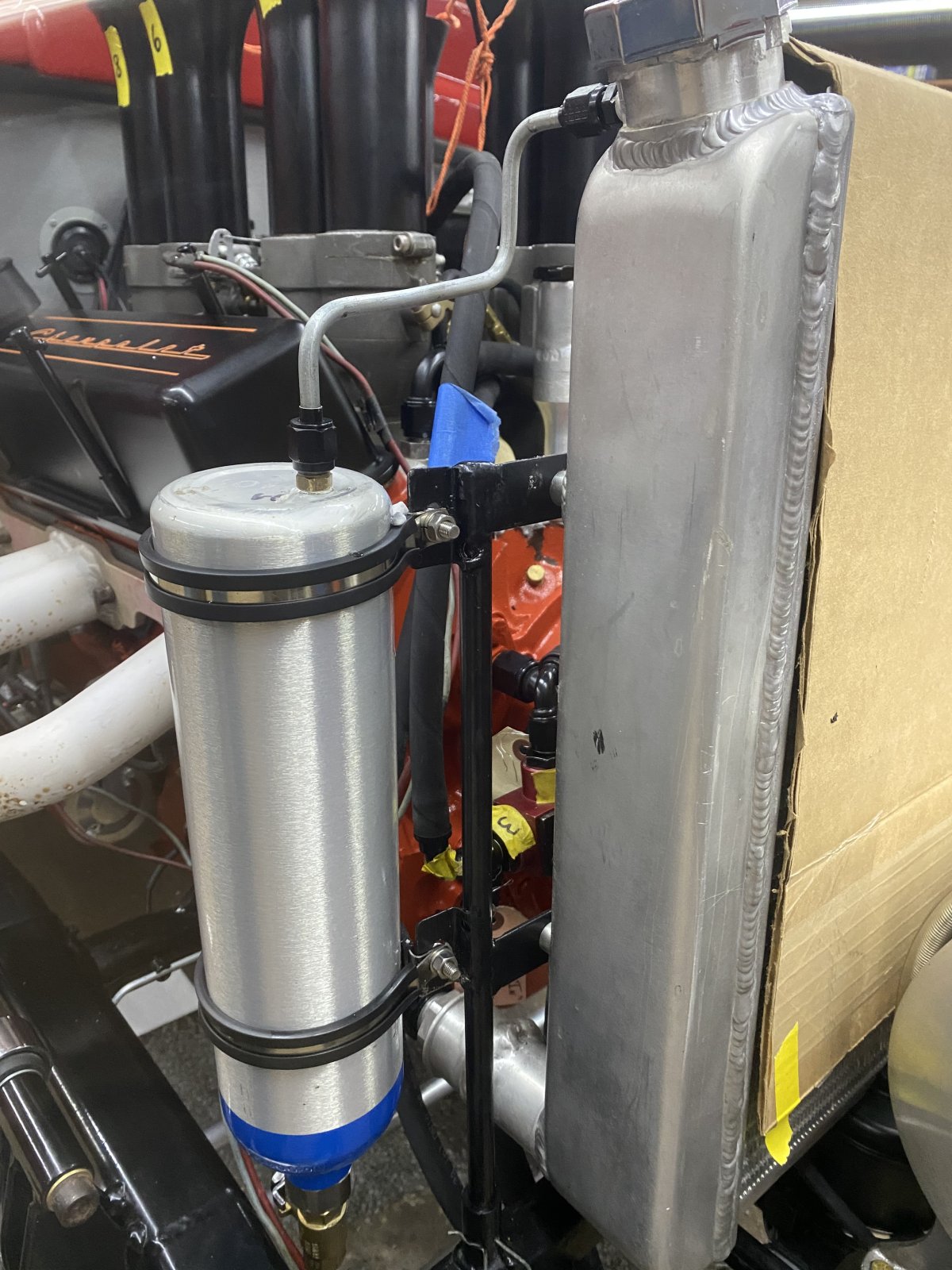

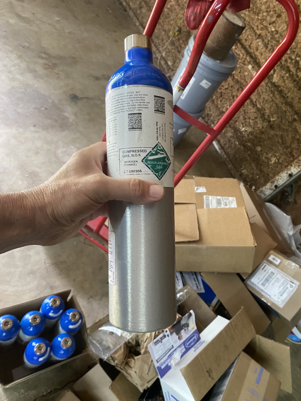

    Wes came up with 10 of these NOS bottles. They are used to check for leaks etc. The spring loaded check valve is actually made of chrome plated br***. I drilled the br*** fitting knocked the check valve out and tapped it. Then got a lever ball valve on bottom and then tapped for a hard line from the radiator. Used big adel clamps. Allows adjustments and mods if needed. IMG_0838.jpeg IMG_0837.jpeg

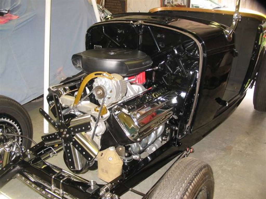

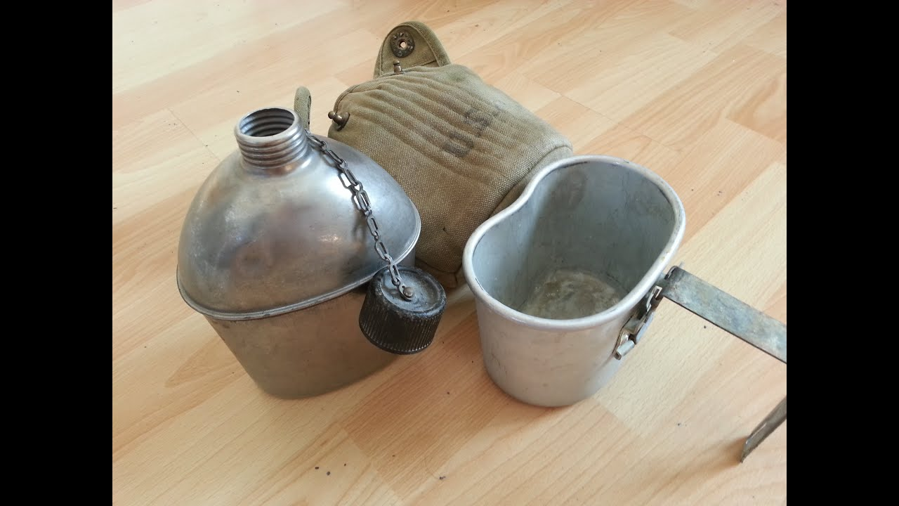

  5. I was told this is a WW 1. Canteen, it works good.

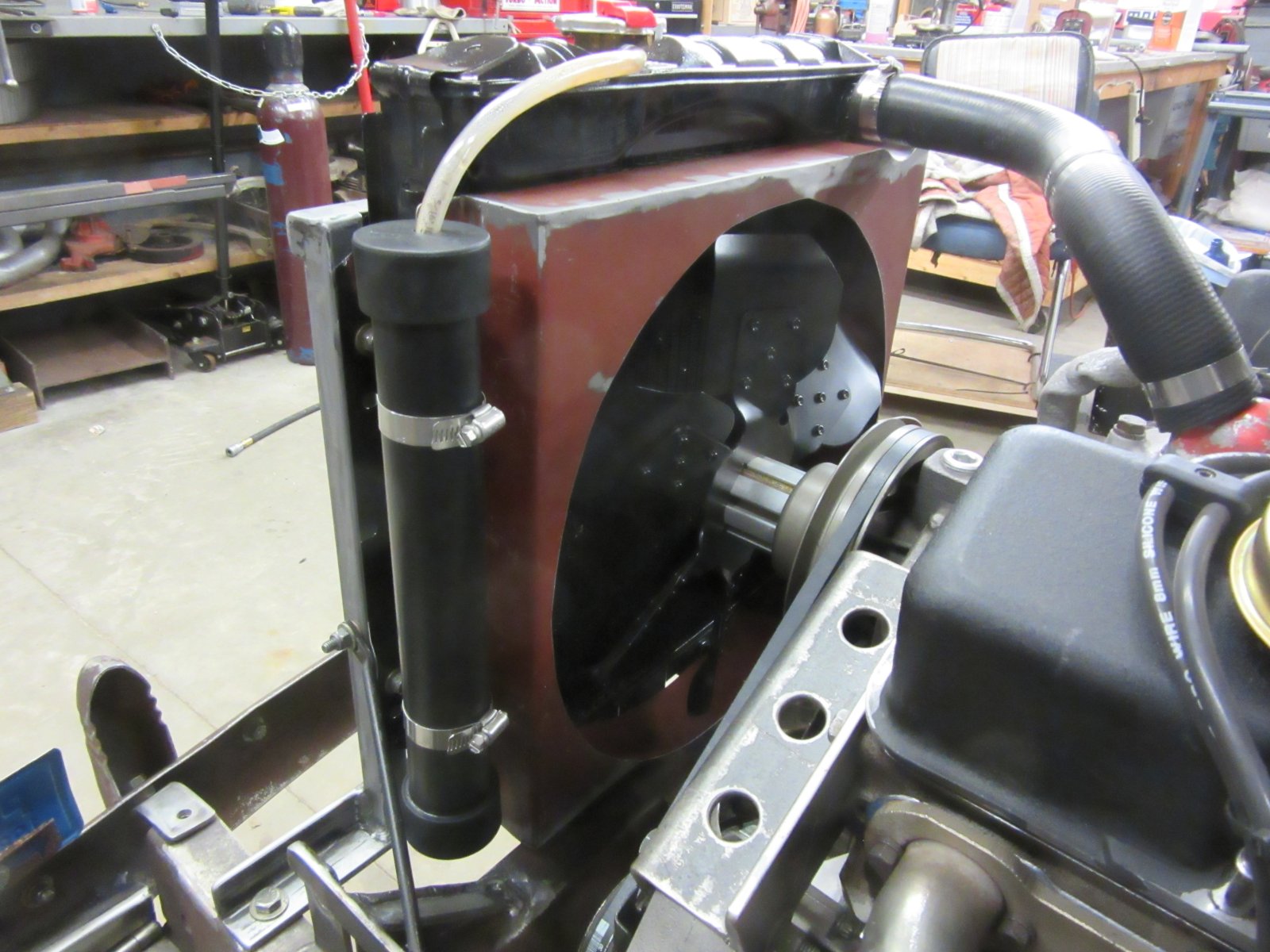

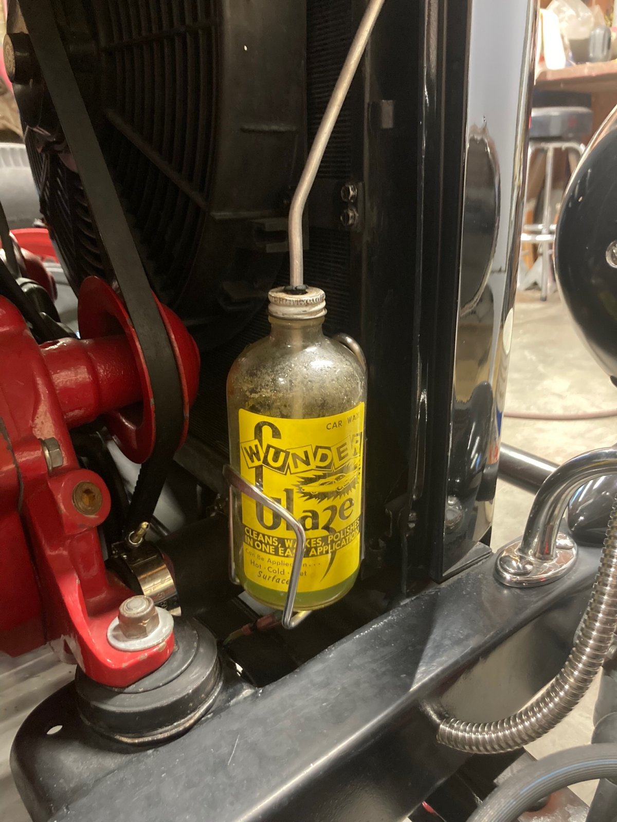

    I’m using an old wax bottle,
    It’s pretty kool to watch it fill up after a long drive,
    then slowly drain back into the radiator as it cools.

    How long has it been on there mate? Im about to put a jack daniels gold edition on mine and worrid its gonna smash or blow from the heat
  13. Harleyv89
    Joined: Dec 26, 2022
    Posts: 169
    Harleyv89
    Any issues with the gl***? I was worried about one smashing and blowing a tyre etc haha

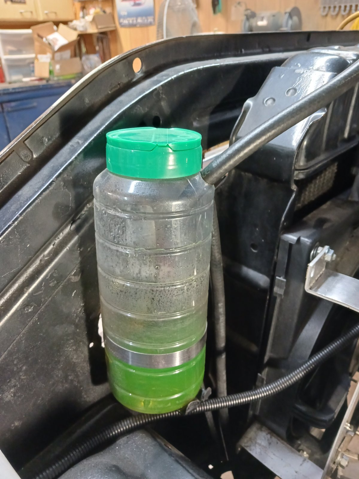

    Grated parmesan cheese container. Clear plastic and the rings let me judge the level at a glance

    Not at all,
    installed about a year ago, prolly at least 1000 miles

    What I really like about my WWII canteen overflow tank, is that it comes with a coup that serves as a bracket.
    Or - if you really want to go fancy, bolt the canvas cover with 2 self tapping screws at the inner fender and use this as a holder.
