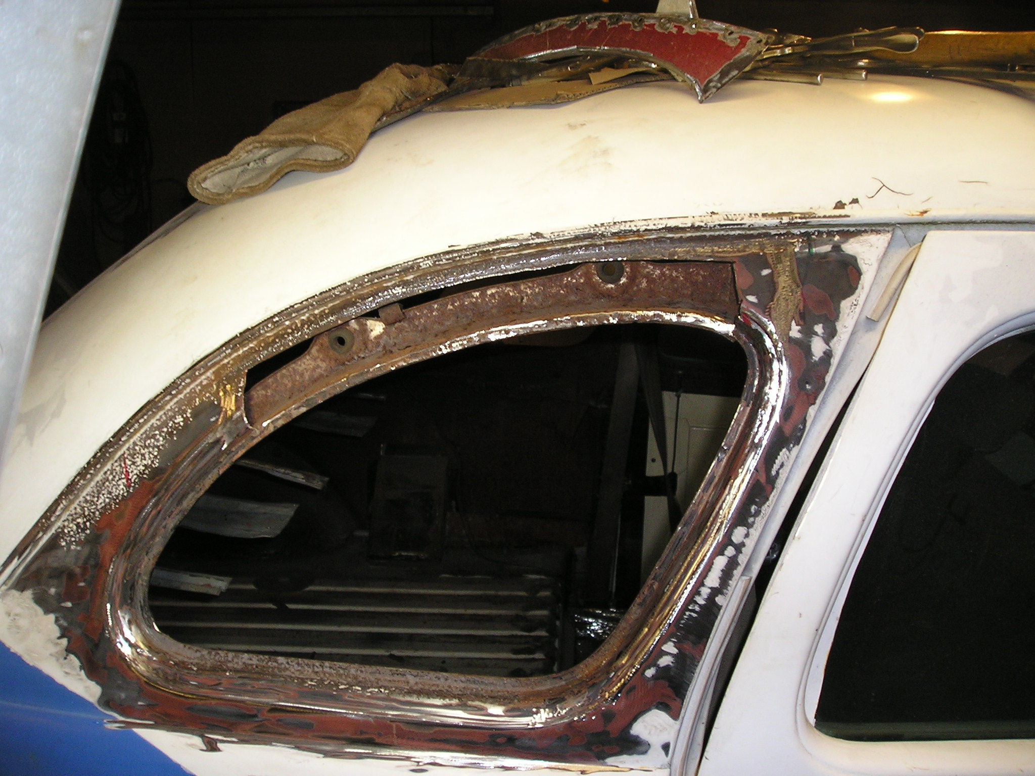

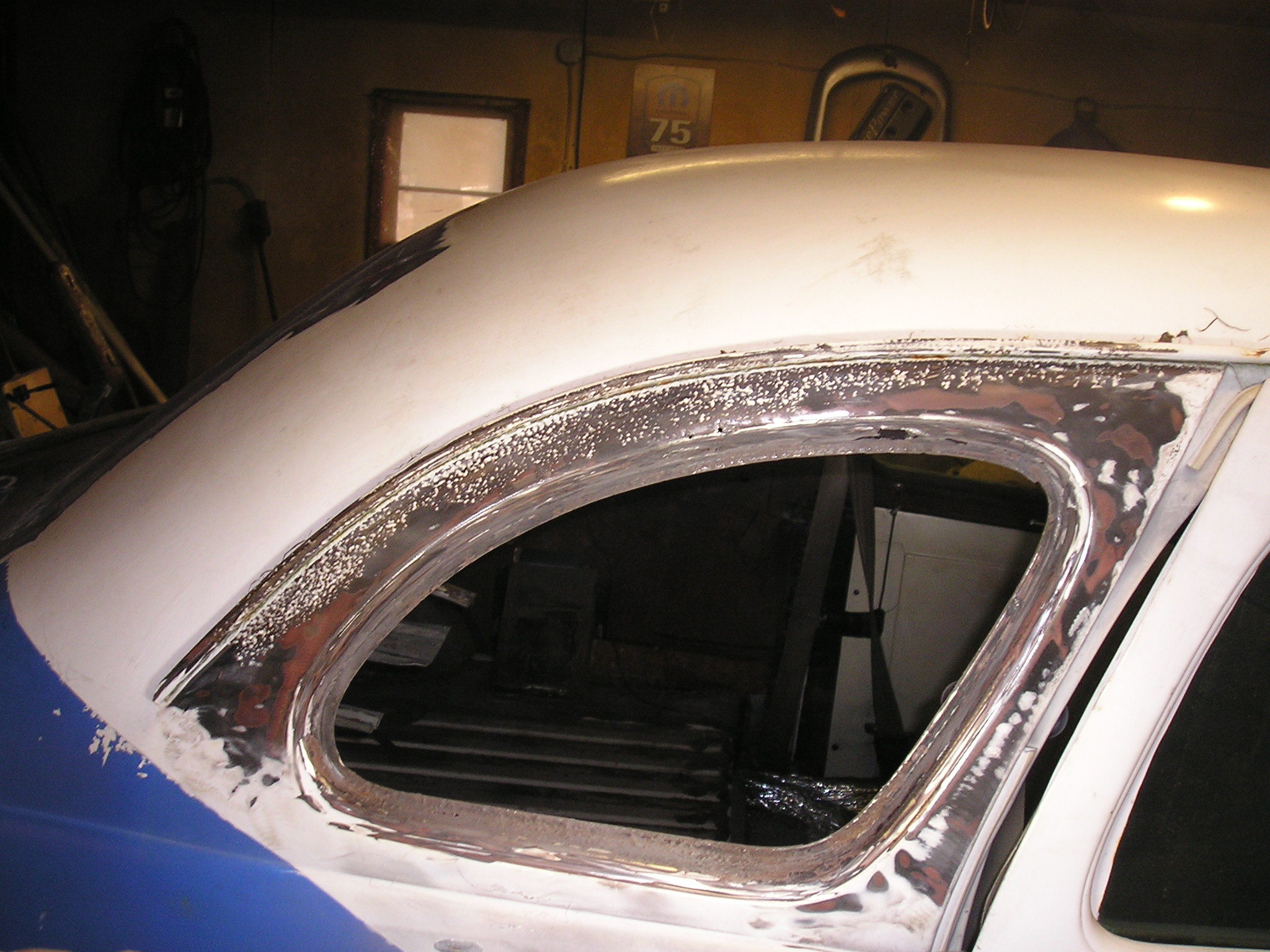

    I welded in some patches on the roof of my coupe that had rusted through, back in 2011. There were still other places that had some deep pits. I bought the brush on Ospho and followed the directions.
    This is how much of that area I replaced in 2018.
    This is how that area looked last summer. The car sits outside all year around.

    The metal around those pits was sanded before the Ospho treatment, should have seen it before that! That area has been sanded several times by now. The pictures just highlight how deep the pits were (and still are), and how they have not expanded after the treatment (no expanded rust from the original pits, and no new pits). The cut out section shows the condition of the surrounding metal (inside of an enclosed section of the body). The area that was replaced was paper thin in 2011. I didn't expect the car to last more then a couple years back in 2011, so for it to make it to this point gives you an idea how well the Ospho has worked for me. 14 years and still going. Could I have treated inside of the enclosed area, it likely would have been in much better condition when it was cut open in 2018.
    There is a difference between sanding a surface you want to save, and trying to grind out rust pits. You can't grind out rust pits, you either replace the metal, or you sand lightly, treat it, finish it, and hope for the best.

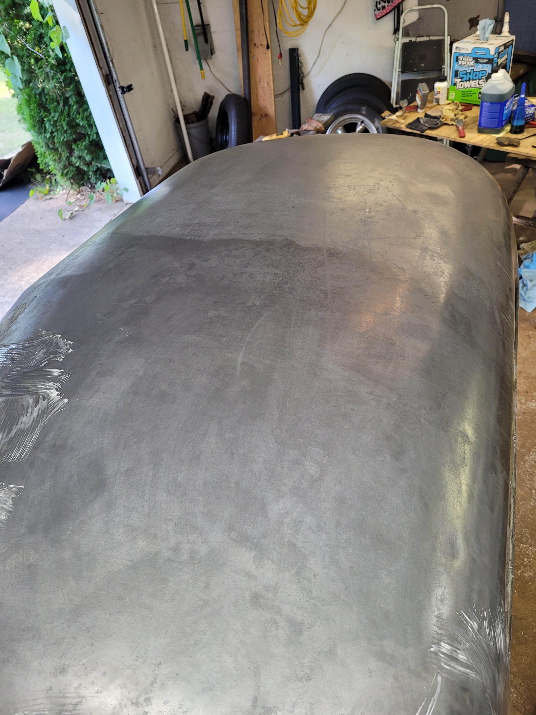

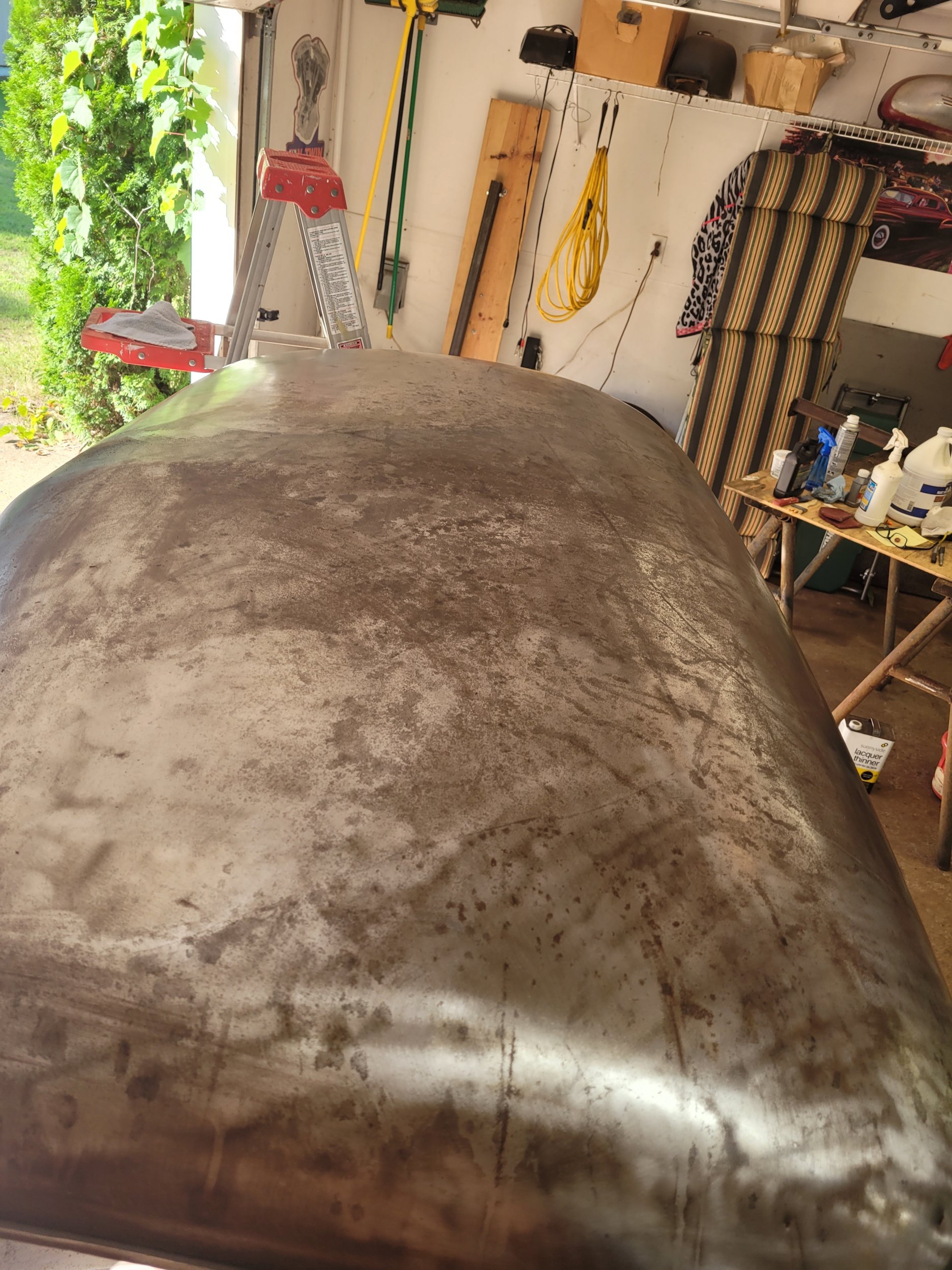

    This was after a paint stripping disk. Pitted rust can be difficult.
    Then this was after using rustoleum rust remover gel ( gel for curved surface). Cheap and you can buy it at Menards. On a flat surface, like your floor I'd use citric acid mixed with water. Can also soak that with a smooth rag and keep wet. If you have pitted rust or not is the question.
