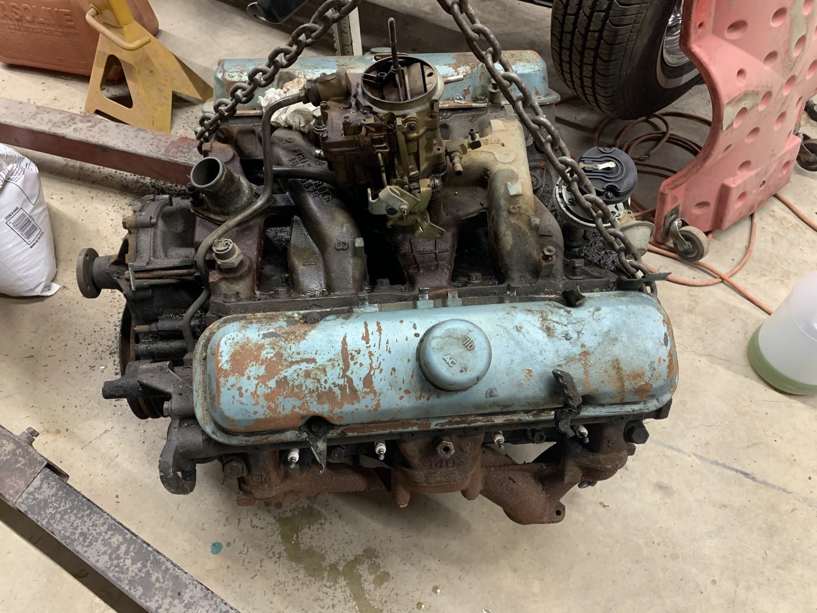

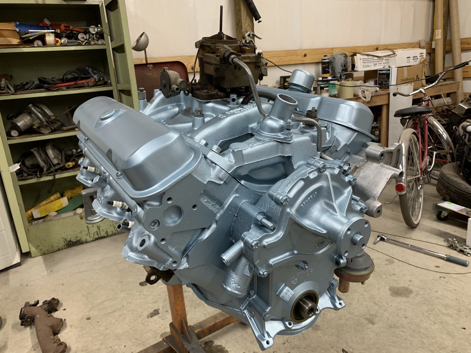

    Lol! That is the “rebuild” I just did on this Pontiac motor although I would never call it that. This was only a rear main seal replacement that got out of control while the engine was out. However, the owner could claim a rebuild I suppose... :rolleyes:
