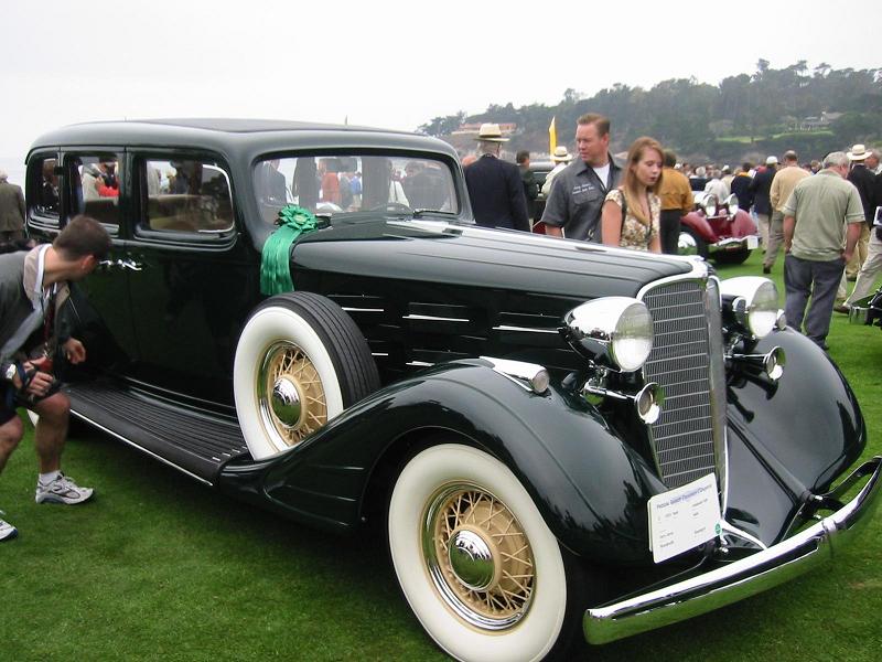

    Wouldn't a Caddy V16 have that as well?
