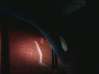

    i just got a 49 ford shoe box...
    it has a small block chevy in it.
    i got a picture of the head casting mark.
    can any one tell me what it is..
    i think its a 283 but not sure

    Going to need more than a picture of the head casting design. Look,if you can get to it on the drivers side rear of engine where ****** and engine meet,there will be a casting no. there that will tell you exactly what you have.Post the no.

    283 heads? not positive though...
  5. Diavolo
    Joined: Apr 1, 2009
    Posts: 824
    Diavolo
    Uhm, not sure really, but we used to call them "power pack" heads. We believed they were not high flowing heads but more the stock economy type head. 2 bumps, camel hump. One bump or a triangle, power pack.
    This was long ago and we were kids so we didn't know much.
    OK, I googled it.. here is what I found
    http://wiki.answers.com/Q/How_do_you_identify_283_power_pack_heads
    the power pack head will have no acc. holes on the face and will have a casting mark shaped like a rectangle with a triangle on it, also know as the pyramid.
    Further reading show them as 283 heads and have higher compression due to a smaller combustion chamber. I hope that helps and that I am not lying out my ****...

    To confuse you further, they also came on early 327 engines. (210 and 250 hp versions

    That will only tell you what the heads are from....they could have been swapped. Get the casting number off the back of the block, sort of behind the drivers side head.....

    in addition to the casting number and casting date on the back of the block. look for the stamped number sequences on the front of the block deck surface, just in front of the p*** side head. Post those numbers/letters, they'll tell us what it is.

    after looking that head casting mark up in my small block interchange manual, my money is on a mid 70's 350

    no hole for power steering and Alt pre 1968 it looks like a 68 cc head
    were the guide plates there when you got the heads or did you put them on

    Looks like a right triangle to me, that would make it a.....drum roll please....
    "Large chamber (76cc) light weight head" maybe off a 350 but I don't think it's from the '70's, I am thinking earlier. I found this link in an old H.A.M.B. post from 2008

    i found these numbers on the head 3947040.
    this number on the p*** side of the block v1029tck and ccj115303.
    i cant see the numbers on the back side of the block the way its been set in the car
  18. davidbistolas
    Joined: May 21, 2010
    Posts: 960
    davidbistolas
    '040- 64cc 327 head circa 1968. Doesn't mean that's what the block is though. I've got camel humps on mine, that doesn't make it a '64 corvette motor.
    You need to get to that rear casting number to be sure.

  22. 1973 307 cid from a truck

    CCJ would be a 1982 chevy truck engine. C means chevy truck, second C is the model year (numbers in the 70s, letters starting with A in 1980), truck was ***embled in Janesville WI.
    If it were a 1973 truck engine, then it would be C3J....
    The suffix TCK could be from 73, or it could be from some other year. Chevy did use the same suffix for way different engines in different years.
    Without the numbers on the back of the block it's hard to say for sure what it is. I don't have truck suffix numbers from the 80s.

    V1029TCK
    V=Flint
    10=Oct
    29=29th
    T=Tonawanda plant
    CK='73 model 307cid from a C20-3500 series
