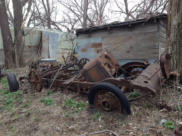

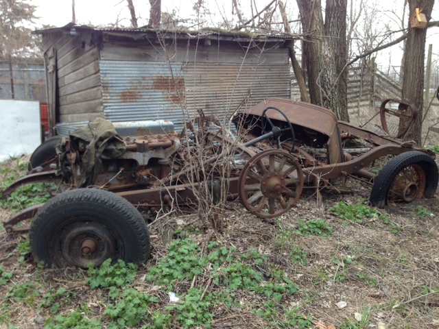

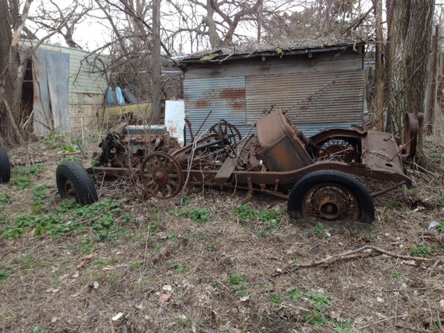

    For a couple years now, I can't get the image of a early board track racer out of my mind. Found this at my local salvage yard. It's a Chevy....possibly 1930. I will rescue it in a couple weeks, but the deal is done. So what did I buy? Any help will be appreciated. Gary M.

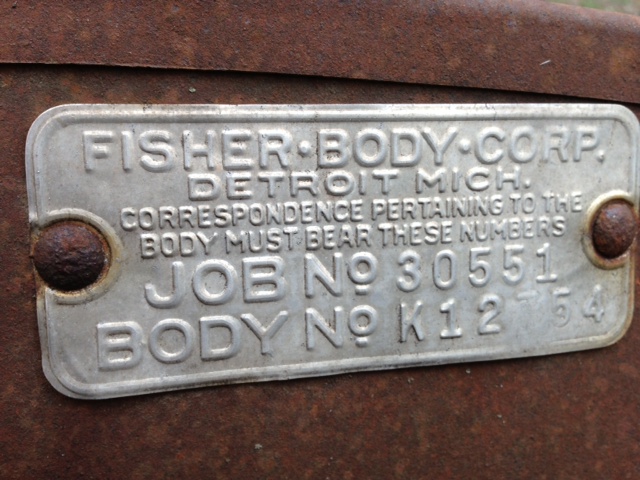

    Job No. 30551 denotes it as a "1930 Universal Coach" in my reference material.

    looks to be a 28/31 Chevrolet about like the frame I bought last year that was a lot less complete to do almost the same thing with.
    You can see the basic similarities but someone hacked mine pretty bad.
    I've got a six lug 55 chevy pickup rear end for mine but an older Toyota pickup rear would be narrower.
    When you get it drug out of the dirt and cleaned up and get more accurate photos someone will no doubt be able to give you a better id on it.

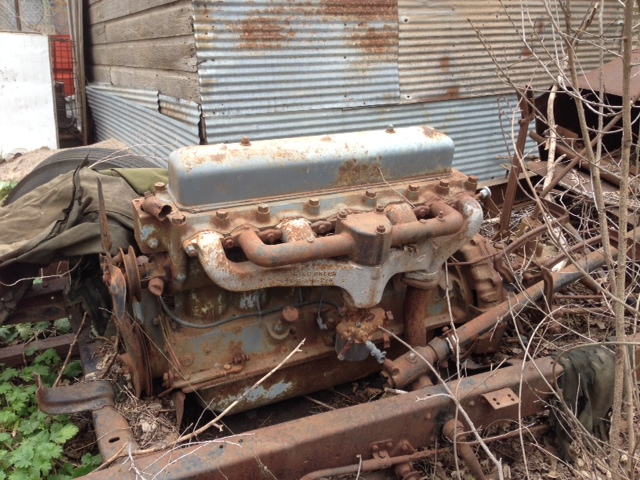

    One last picture for now.

    That is correct, and it means 2 dr sedan.
    https://www.fillingstation.com/articles/id.htm
    It was also built at the Kansas City plant (the K in Body no.).

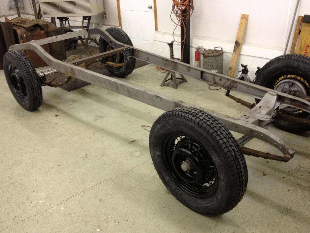

    Well it's on the road. It's been a fun build...approx. 4 months start to finish...but it's never done. Response has been awesome. Gary car-2.jpg TAIL.jpg TAIL.jpg steve-3.jpg

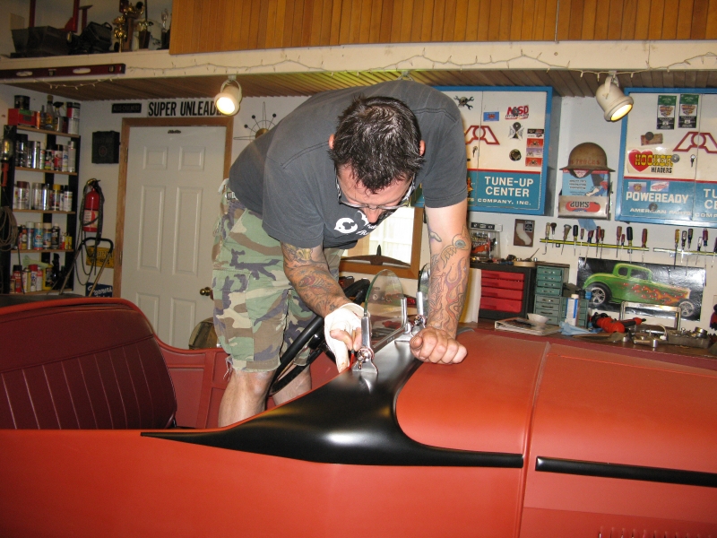

    I just kind of take it for granted. First I had the help of two talented builders, Dave Scheimann Jr. and his father, Dave Sr. They saw my vision and were totally onboard for the journey. Quick details....30 Chevy frame (boxed), 1954 Chevy half tone pick up front axle and brakes (bolt on), 1995 Nissan Pathfinder rear axle (perfect width and is six lugs)
    1968 Chevy 292 six cylinder, turbo 350 trans., 1930 Chevy steering box and column, Tanks gas tank, custom drive shaft, 1998 Plymouth mini van middle seat (shortened and narrowed), Stewart Warner curved glass gauges, new radiator, Coker Excelsior vintage radial tires, 1936 or 1937 deluxe 17" wire wheels (six lug), stock leaf springs and lever action shocks (with two hidden tube shocks in the rear). Pin striping by Steve Gillette from Council Bluffs Iowa. Brook lands windscreens from Xke's unlimited in California. enough rambling....I'll post some pictures 30-1.jpg 30-1.jpg IMG_2097.JPG MOUNT-2.jpg

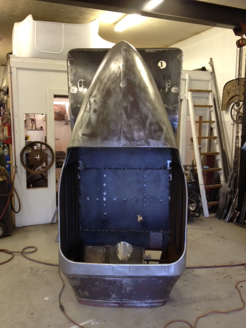

    Joined: Sep 11, 2007
    Posts: 998
    2NDCHANCE

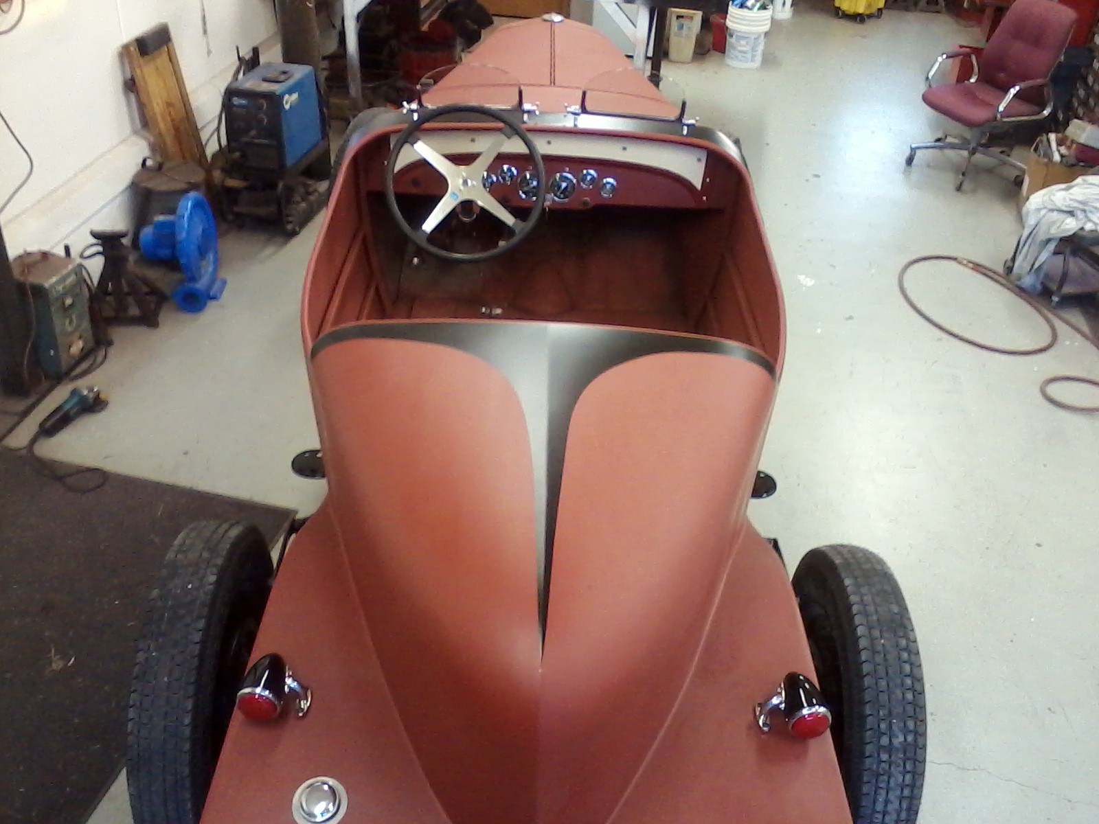

    BUTT-1.jpg cigarbut-1.jpg mockup-4.jpg A couple more for now BUTT-1.jpg cigarbut-1.jpg

    In my eye, and do NOT take this as a criticism, that car is on 21's with skinny tires.
