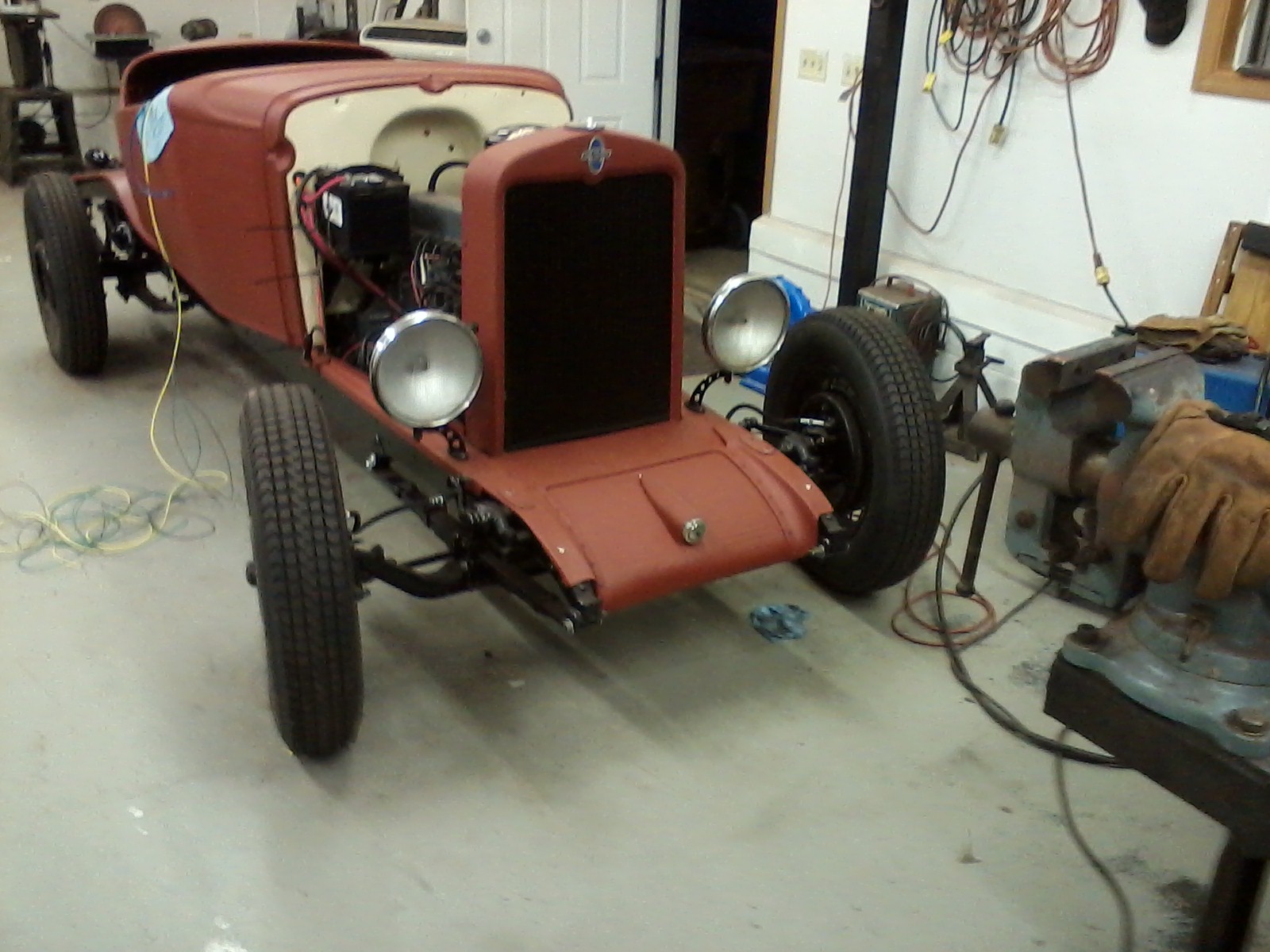

    front-view.jpg My buddy at the local salvage yard had two hoods to try for a good fit. The hood we used is a one piece (possibly Chevy) and you might be right . Here are some front end shots. wiring.jpg about it being a 41'
    kiwijeff and volvobrynk like this.

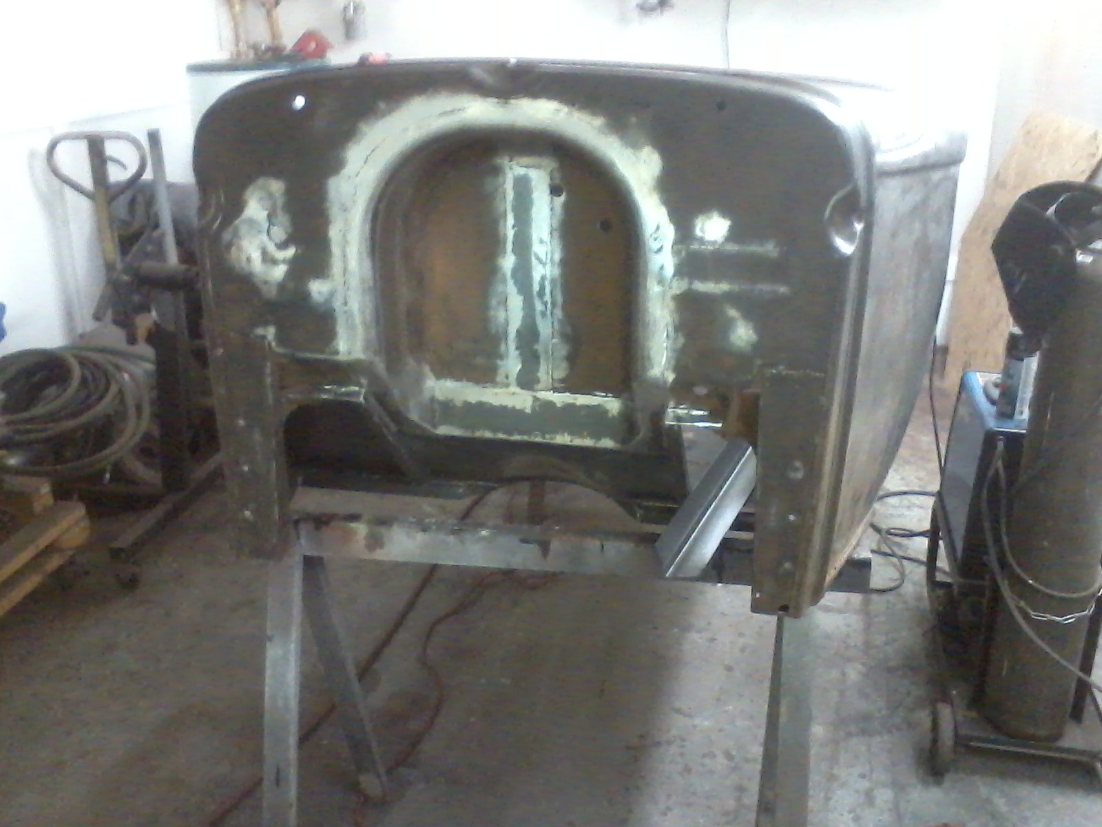

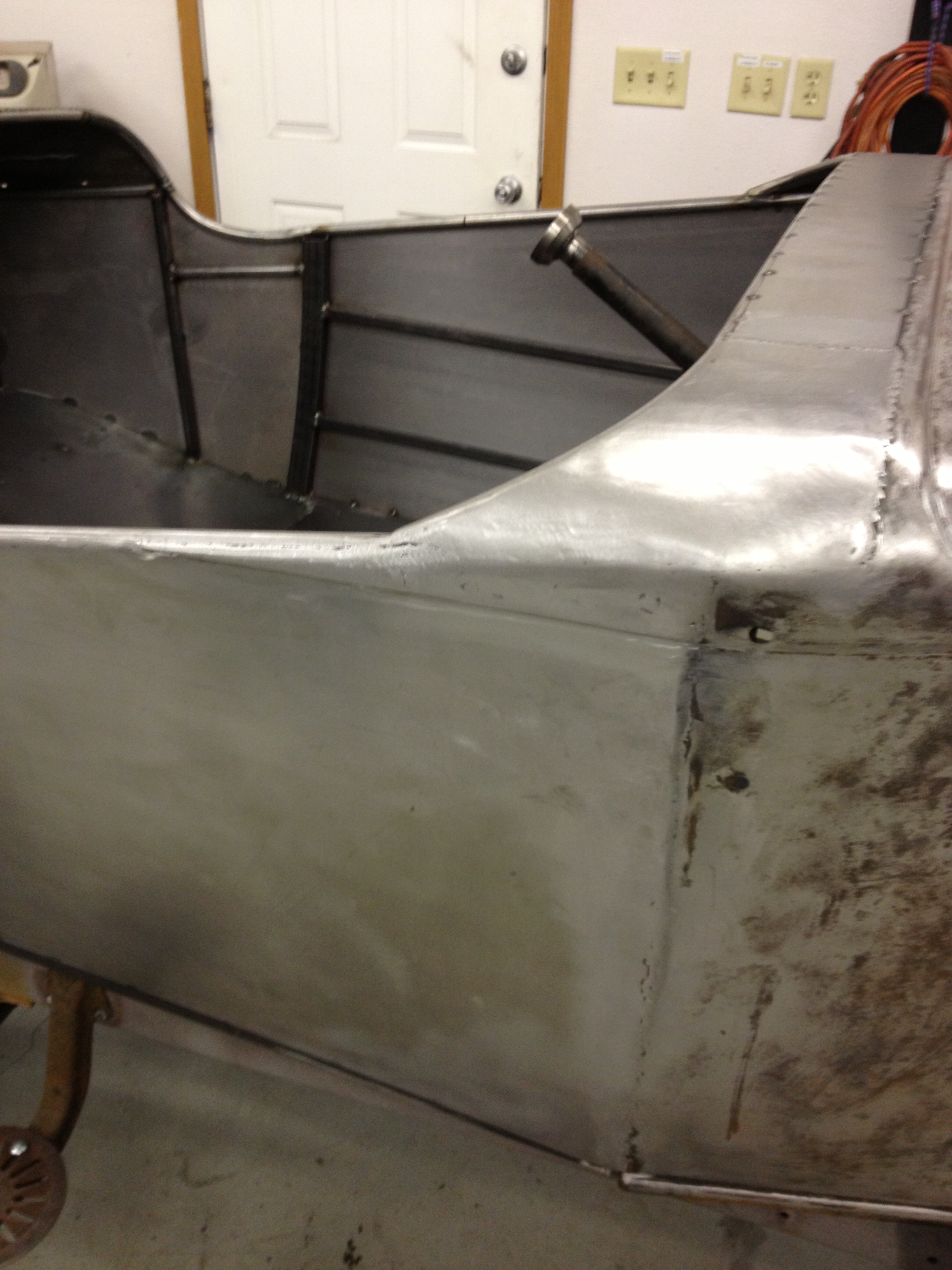

    Here are a few of the cowl and firewall IMG_7562.jpg IMG_2191.JPG area. 0430142208.jpg

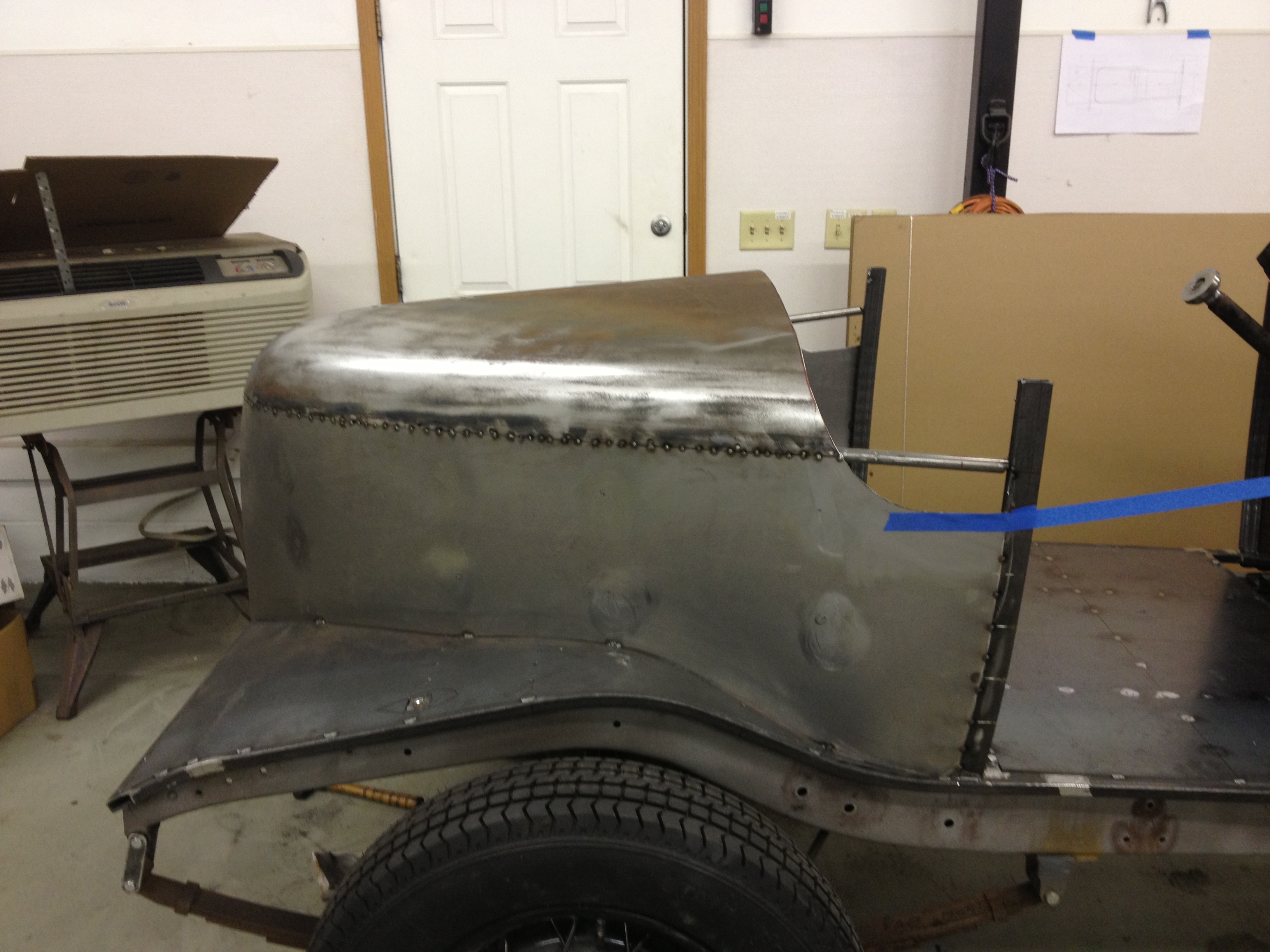

    IMG_2126.JPG The whole body from the radiator shell to the back of the original cowl is relocated 7" rearward. We fabricated the rest. Plus the big 292 six required the firewall to be redone and deepened about another 4 inches. Wheel base is stock, stock frame dimensions, stock 1930 steering box moved back 7 inches, Inside the tail is a metal tubing frame work. Brake pedal assembly (and master cylinder) is from Speedway Motors. Sub rails are 3/4" x 1-1/2" rectangle tubing masterfully bent over the frame rails. seat-1.jpg seat-1.jpg

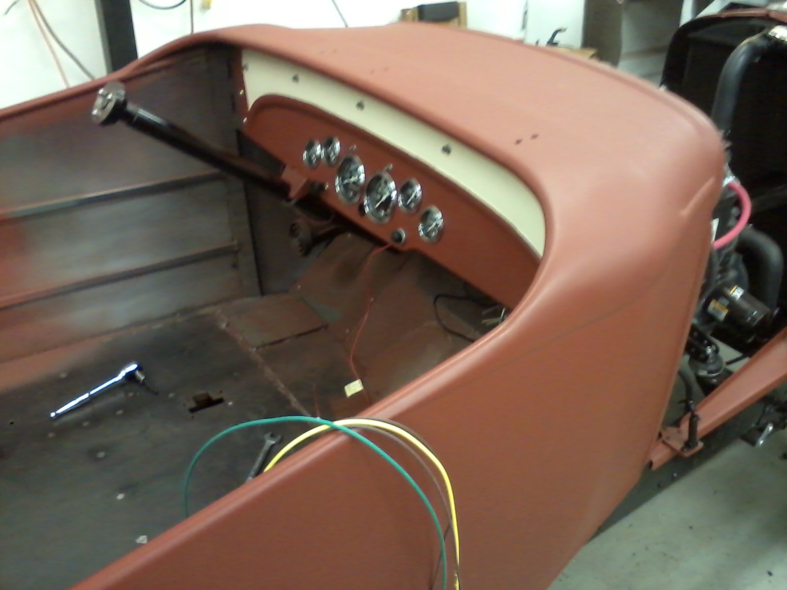

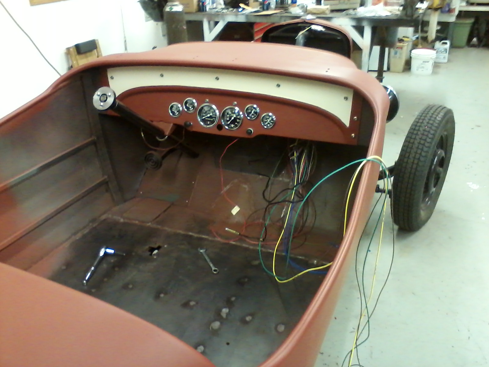

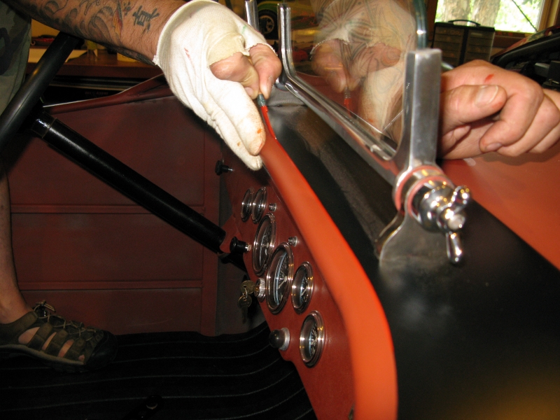

    Heres a dash picture DASH.jpg DASH-1.jpg DASH.jpg DASH-1.jpg engine-bay.jpg DASH.jpg DASH-1.jpg engine-bay.jpg
    volvobrynk likes this.
