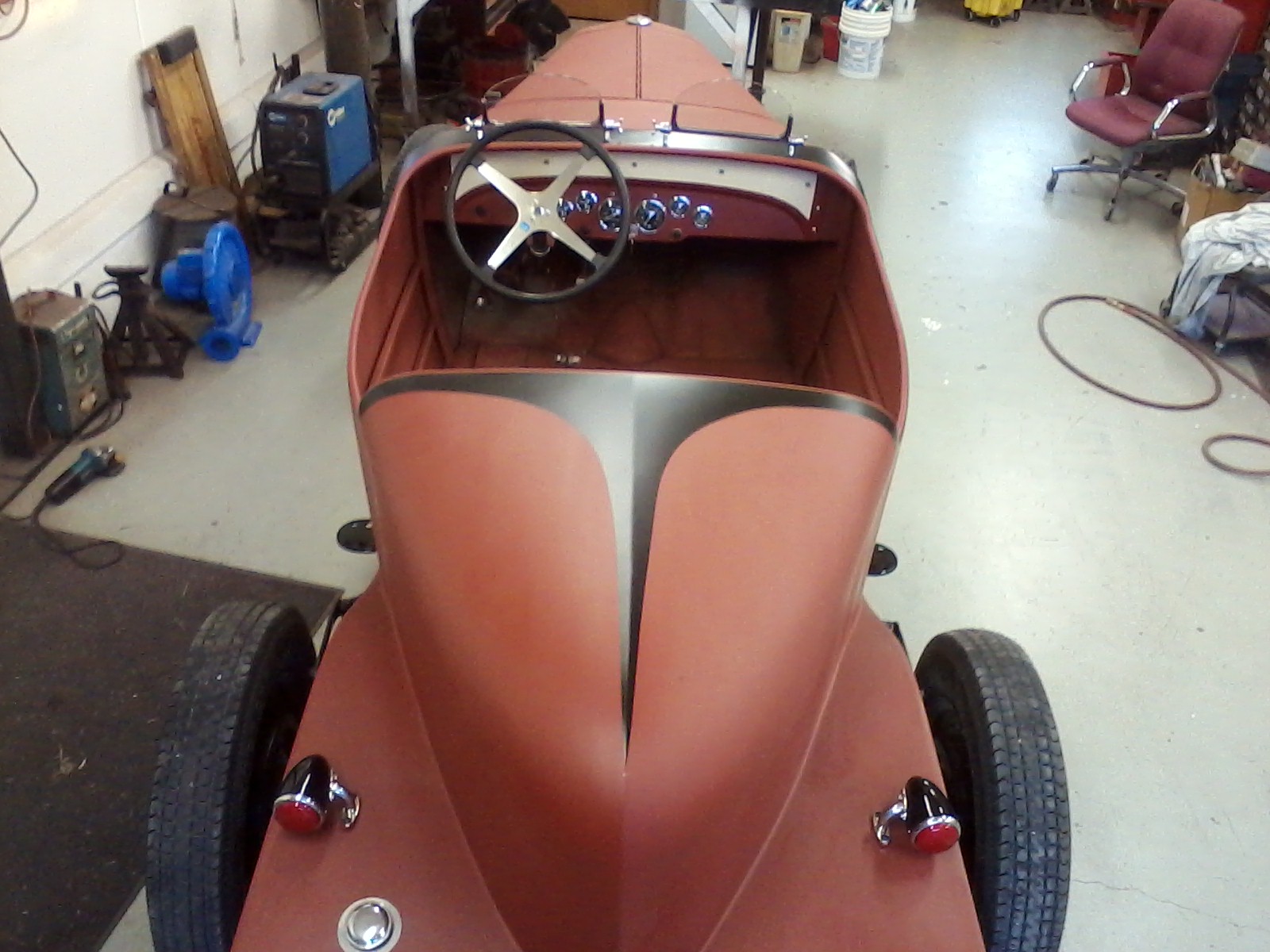

    oldschool66 thanks for the comments. As for the gauge layout... I was going to make an aluminum insert then decided to see what the stock dash would let me do. After ordering the Stewart Warner gauges I made some circle templates and just altered the stock gauge holes with a dye grinder. Slow and steady, with many test fits......I wanted to keep it a simple as possible. Gary

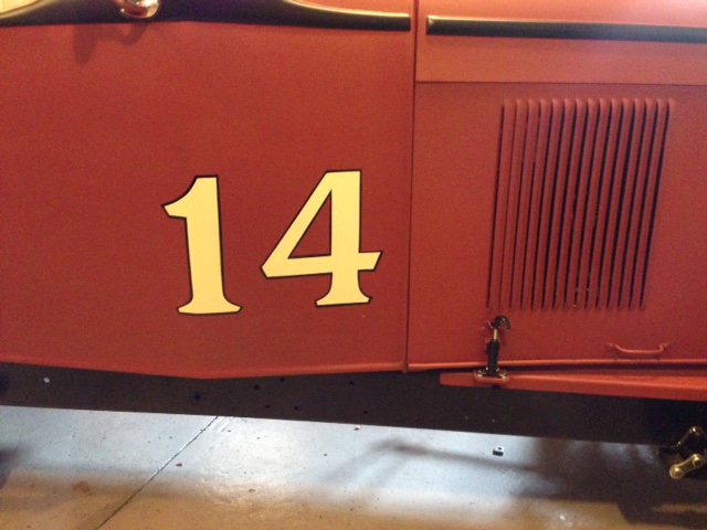

    I'm getting ready for the 2015 Omaha World of Wheels car show. I re-did the small numbers and painted the large numbers on the tail. It really changed the at***ude of the car. Gary 30-1.jpg 30-2.jpg 30-3.jpg
