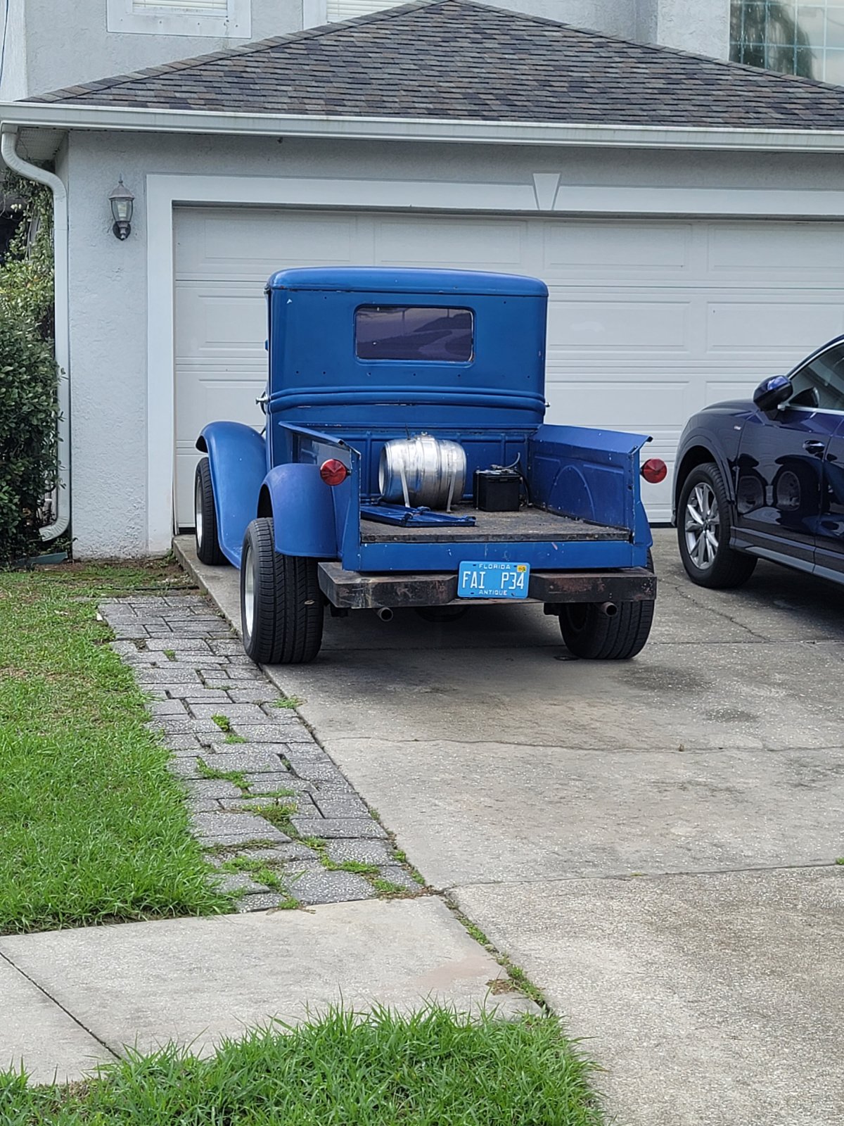

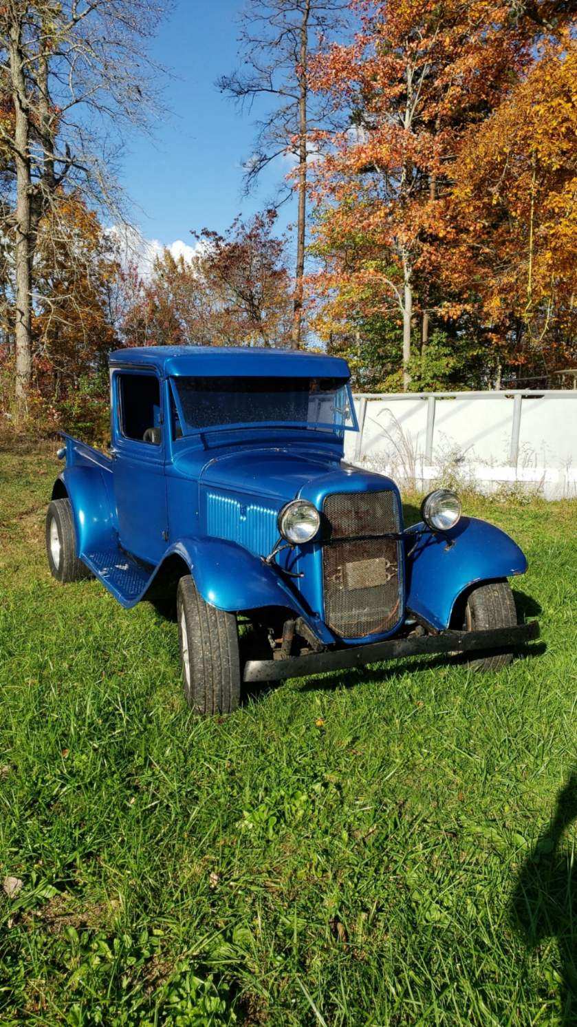

    Its a 1934 SOMETHING- which is the 1st question. What have I got?

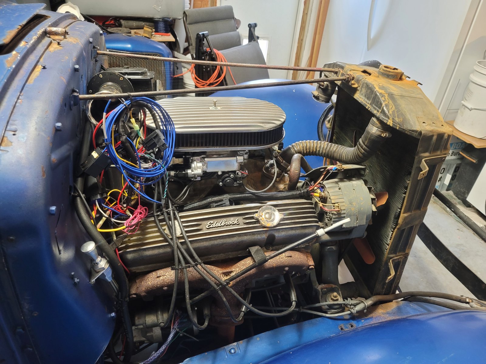

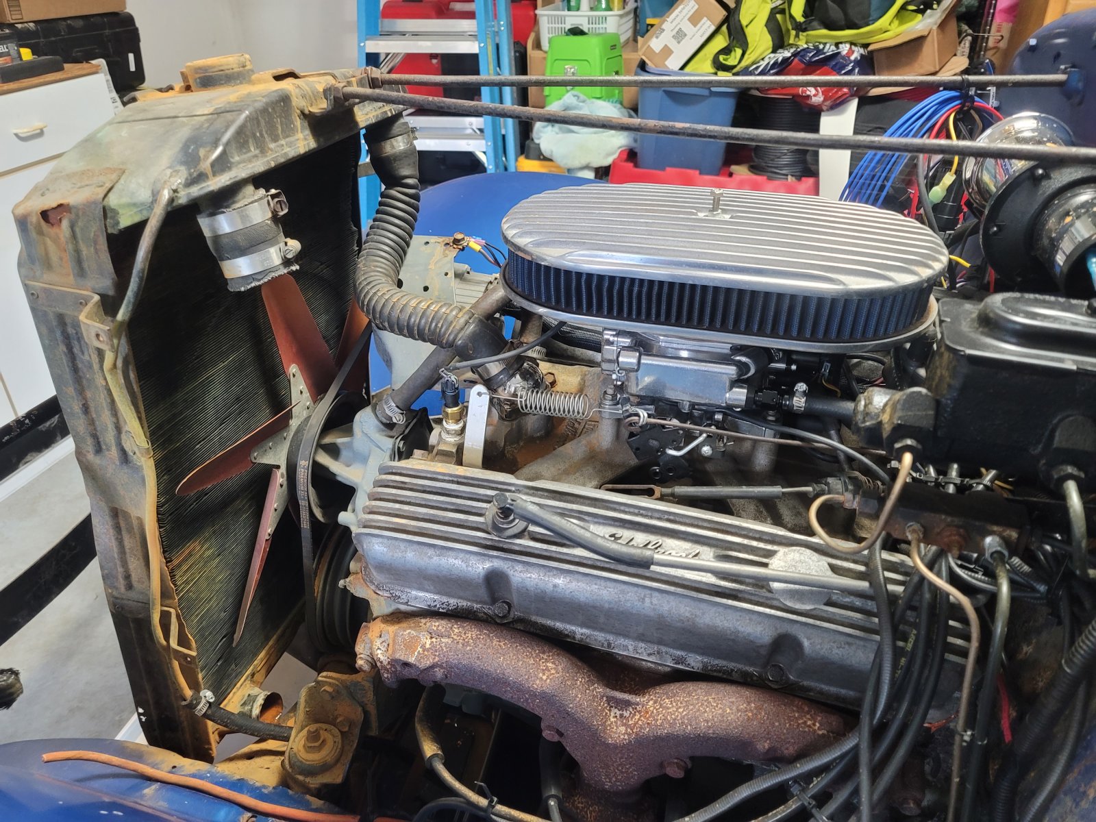

    Next question, WHY would someone put a CHEVY engine in a FORD truck?
    Had a terrible time getting the new Holley carb to get it running right, so I dropped a Sniper TBI in it. Purrs just fine now.

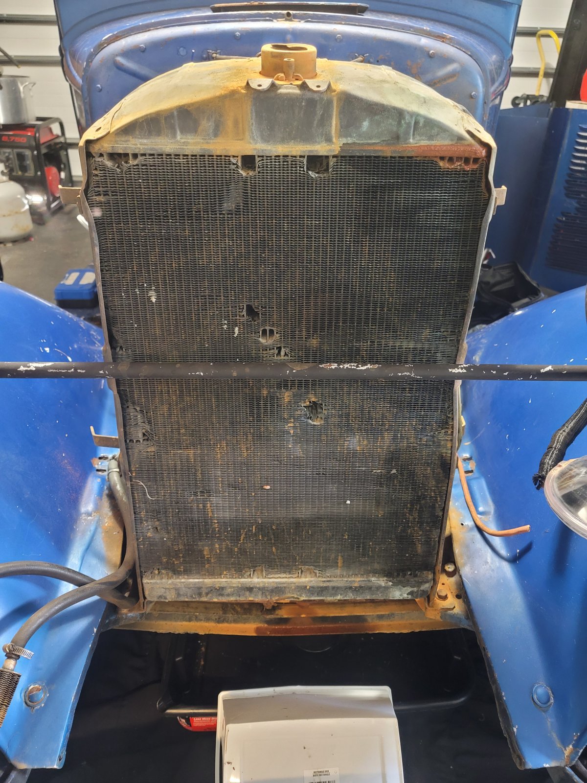

    But it runs HOT and I need to widget a new radiator in here, which doesn't have the top tank that sticks out 6" or so. It DOES have a bracket to rest the rods on, but is it OK to just buy longer rods?
    Anyone ever deal with a work around? Got any words of wisdom for the rear of the cab, which has some carriage bolt square holes?

    From the license plate, I'd guess it is a 1934 Ford.
    Chevy engines are used in hot rods very often. They are small, light, and relatively inexpensive.
    On the radiator, I'd start by trying to find a local radiator shop and see if your unit can be rebuilt for under $600.
    Finding a shop is getting more difficult.
  4. or if youre on a budget, theres always Ebay aluminum rads... not exactly traditional but much more affordable

    Seems the price was right for a very cool 34 Ford pickup. Stick around here a while and you can get lots of ideas how to make it even cooler.

    I was thinking April Fools, but... Looking at the pic from the rear, I honestly don't know what you've gotten yourself into. Best advice is don't do anything until you learn a helluva lot about hot rods. NOTHING>

    First thing I'd do is take that radiator out, turn it upside down and flush it out real good with the garden hose and see if anything comes out that might have been inhibiting flow.
    Gotta have good Flo.
    And plenty of Clarence.

    Why a Chevy engine?
    Manufacturer of parts is irrelevant. You use what fits/what you have.
    Replacing a flathead with an SBC is as traditional as a pointy bra and easier to work with. :):)
    The overall dimensions of a SBC is similar to a flathead.
    Overheating.
    For a new to you ride, I’d make sure the thermostat worked, the water pump pumped water, and the system was clean and obstruction free.
    Then you can diagnosis.
    Overheating needs defined. Boiling over or just hotter that you think it should be.

    The square carriage bolt holes in the back of the cab are used to support and stiffen the back panel. They also go through a wooden piece of wood bent and molded to fit on the inside. Like a gusset.
    I’d dump that gigantic radiator and buy one that fits your profile.

    And remove that god-awful rear bumper made of square tubing.

    This is not a 34. The reason people put sbc in them is because it's cheap and easy. Looks like a awesome ride and you will learn a lot on here. The knowledge here is unreal.

    And yes you have a 33-34 ford cab there. I can’t see much else to judge the bed

    Overhead engines were taking over the rodding hobby in the early 50’s
    The power the engines (chevy, olds and caddy’s provided was just the next step in speed. The y- block was big, cumbersome and had a poor ignition when they first arrived.
    The other engines were small and powerful and reliable.
    It only made sense and it still does.

    Small block Chevrolet engines fit in early Fords like they were made for them. It was a cheap and foolproof way to double the horsepower of an old Ford at exactly the same time the flathead V8 was waning in popularity. The SBC had a 10 year head start before the Ford engines you mentioned existed, they clear chassis and steering parts better, and they are just easier to deal with.

  26. Here is the theology. The small Chevy fits where a flathead was easier than any other engine. It’s cheaper and yes it plentiful.
    Ford replaced the flathead with a y block around 54.
    Chevy replaced their straight 6 with the small block Chevy in 55.
    the first available small Chevy was probably quickly swapped over into a ford. Why? It’s just a better design than the Y. You guys can flame me all ya want. I’m a ford guy. But I’m replacing a flathead with a Chevy. Why? Well I first test fit a Y block ford. That would require extensive front crossmember modifications. And had exhaust issues. The Chevy fit the same hole with no mods. Hooked up to the Ford trans and was able to use gm exhaust manifolds. So the answer is it’s easier. By the time Ford built a real small block in the early 60s the Chevy had dethroned the flathead.
    I’m building a work ride cruiser. I could care less what makes it go. I’d rather wear out a cheap plentiful sbc than a Y or a flatty.
