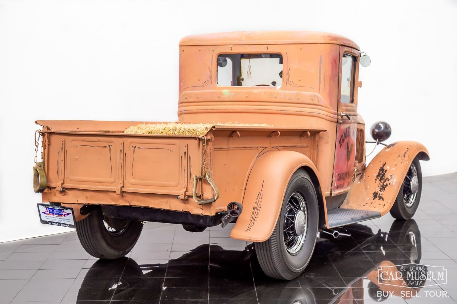

    the hood is 1934, the cab is 1933. I have one

    I concur with Manyolcars. You have a 33 Ford cab with a 34 hood

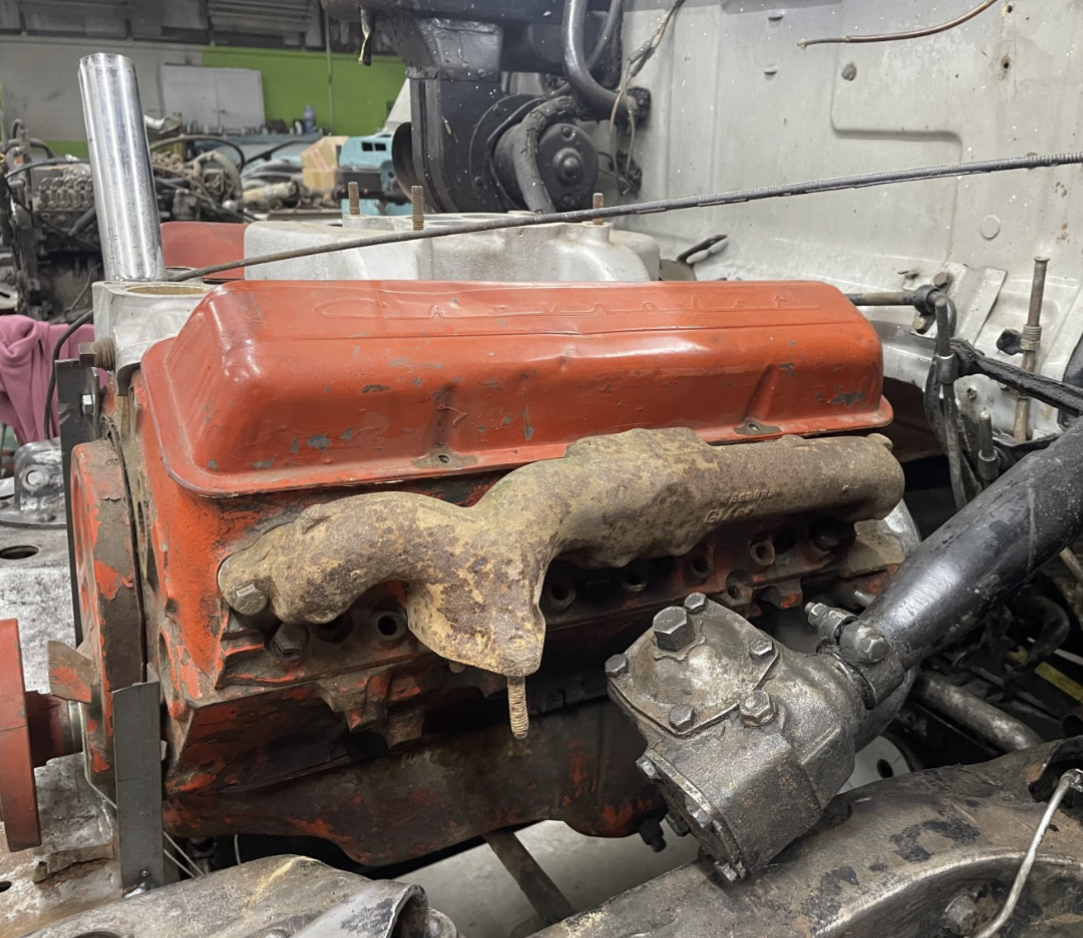

    In pics That fan is not a good choose ,Ditch it !!! ( skinny drag fan)
    6 blade 16-17 inch fan ,,,
    All so looks to be V8 radiator for flat head Ford originally,
    By pics it plumed wrong !!!
    Driver side hose need to go to top of intake ,,, cap off top p***enger side .
    Lower p***enger side looks to be correct, to water pump for Chevy engine (V8 )
    ( driver lower needs to be caped off)
    By pics water is cycling pretty much on
    Right / P***enger side of Radiator ,
    Not efficient for cooling

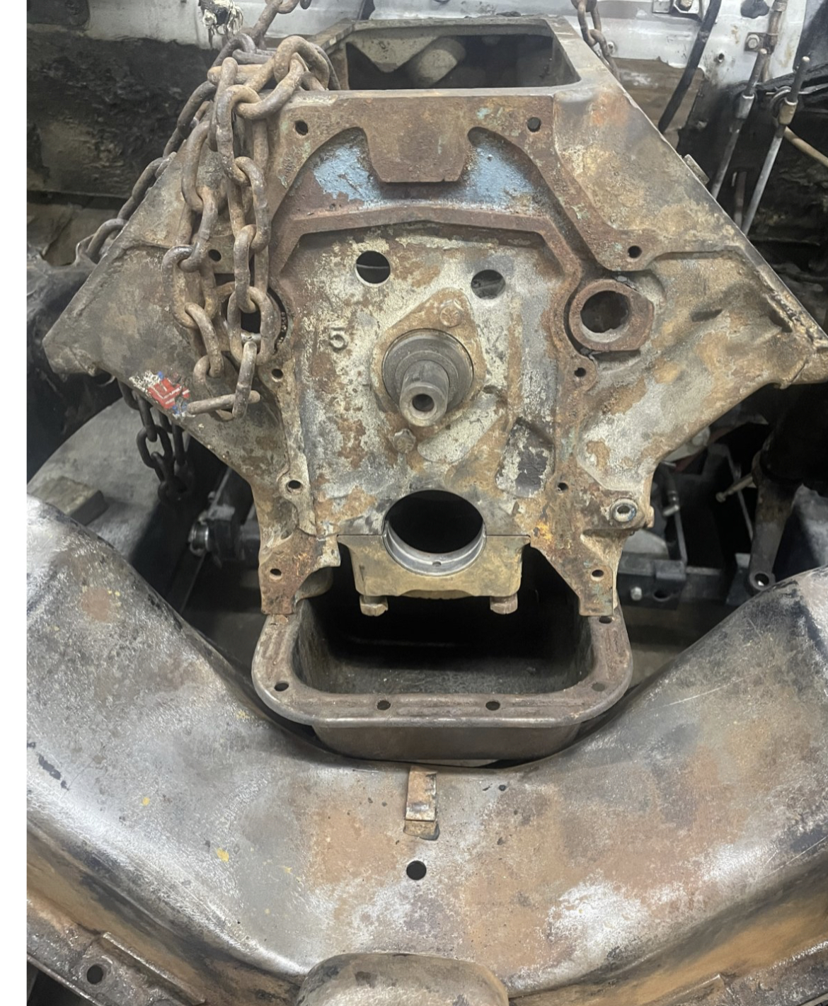

    chevy engines also have the oil pump in the rear, there are crossmwmber issues, lots of work arounds but chebbys are the easy ****on

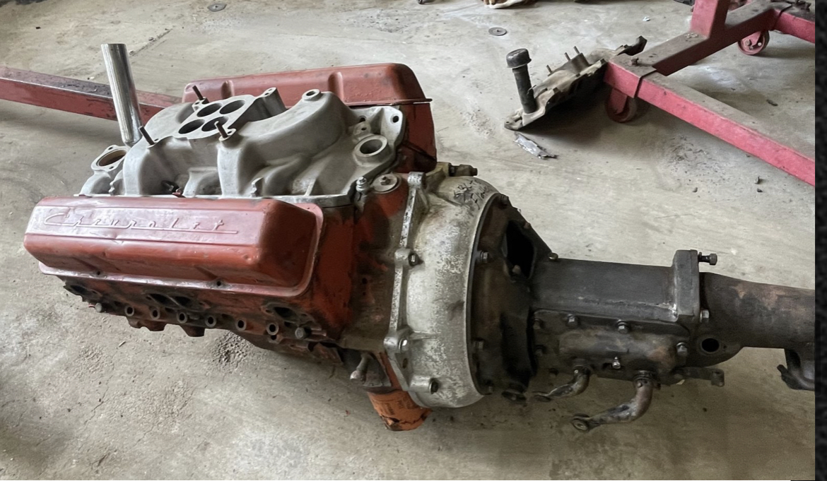

    For a y block you just need a truck oil pan, pick up tube and oil pump, then the ol y block fits like a glove
  12. well, the Y block was waay better than the first sbcs out. size wise they are about the same. lots of Y block rods were/are out there. from what ive read most of the small block rods werent 1950s, it was mid to late 1960s when it really kicked off.
    and through it all, there were still hot rods with flatheads, because you cant beat the look or sound of one.
    oliver westlund likes this.
  13. Nope.
    It was fit with a truck pan.
    Hits the crossmember and still too high. Raising the other end would require floor and frame mods
    This fit like a glove
    exhaust is perfect and we kept the master cyl in its OE location and exhaust cleared the box Using the original merc trans. No mods needed. Factory shift and clutch linkage intact. No driveshaft cutting. Only had to build engine mounts.
    I love cutting cars. But this project is a daily cruiser. Its motivation brand is irrelevant as long as it motivates.

    Looks like a '33 Ford pickup cab, the hood & radiator shell appear to be '34, the reason behind using a sbc is because they fit and the dimensions are not to different from that of a flathead V8.

    As for the radiator, it appears to be original, if it were mine I would remove it and take it to a local radiator shop that repairs radiators and have it vatted ,remove the extra top outlet and the extra bottom one also, if the core is shot they can get you a new core and the radiator will work with no further modifications.
    I also noticed the fan is too low, there is a company that make a product called a zips riser that will reposition the fan 5" higher on the radiator which will improve cooling.

    The easiest way to identify a 34 is the extra top body line hump on the back of the cab that the 32 and 33 doesn't have

  26. It’s low because the merc clutch linkage is like the 48 and down fords. That sets the position of the bell housing.
    IMG_3339.jpeg 283 to Mercury trans.
    I had the adapter, pilot bushing, flywheel and clutch in stock at the house.
    Easiest swap ever

    Agree with both of these comments. The wide belt line gives away a '34 cab. I have one...

    The '33 and '34 cabs are identical with exception of the extra tall rib on the back of a '34. They both use the "outie" style firewall that is riveted into the cowl.
    The cab on this particular truck is indeed a '33. The bed is as well (given that '33 and '34 beds are the same).
