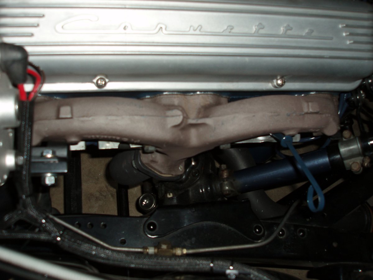

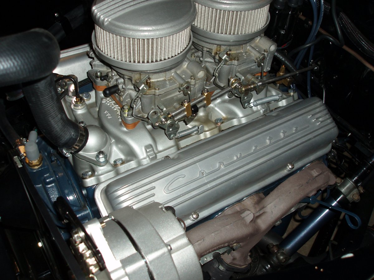

    Here are pics of my 46' with a 283 installed. As mentioned earlier, use the ram horn manifolds. As you can see on the left side, the manifold clears the steering box. Hope this helps. P1010014.JPG P1010015.JPG P1010015.JPG P1010016.JPG

    The earlier ram horn with the tilted outlet sure looks to be the ticket though I've got a normal set on mine. Makes a very quick bend right away and clears
