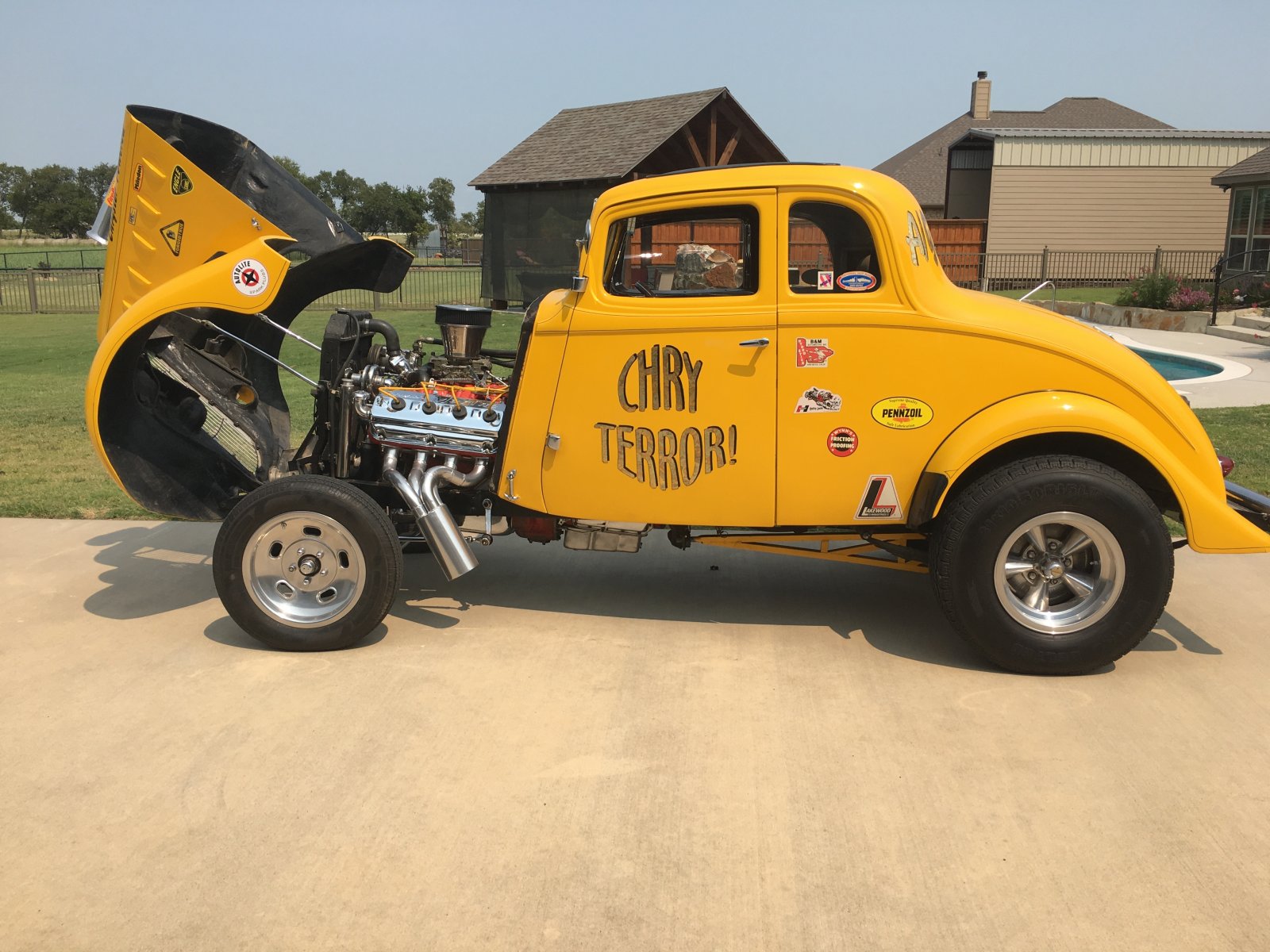

    Here are my two big examples.
    Welded my '36 Willys front end together, made a 'gl*** mold off that and made a 'gl*** tilt hood.

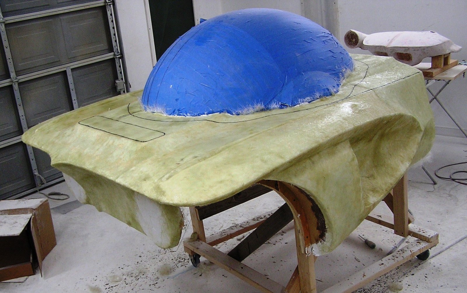

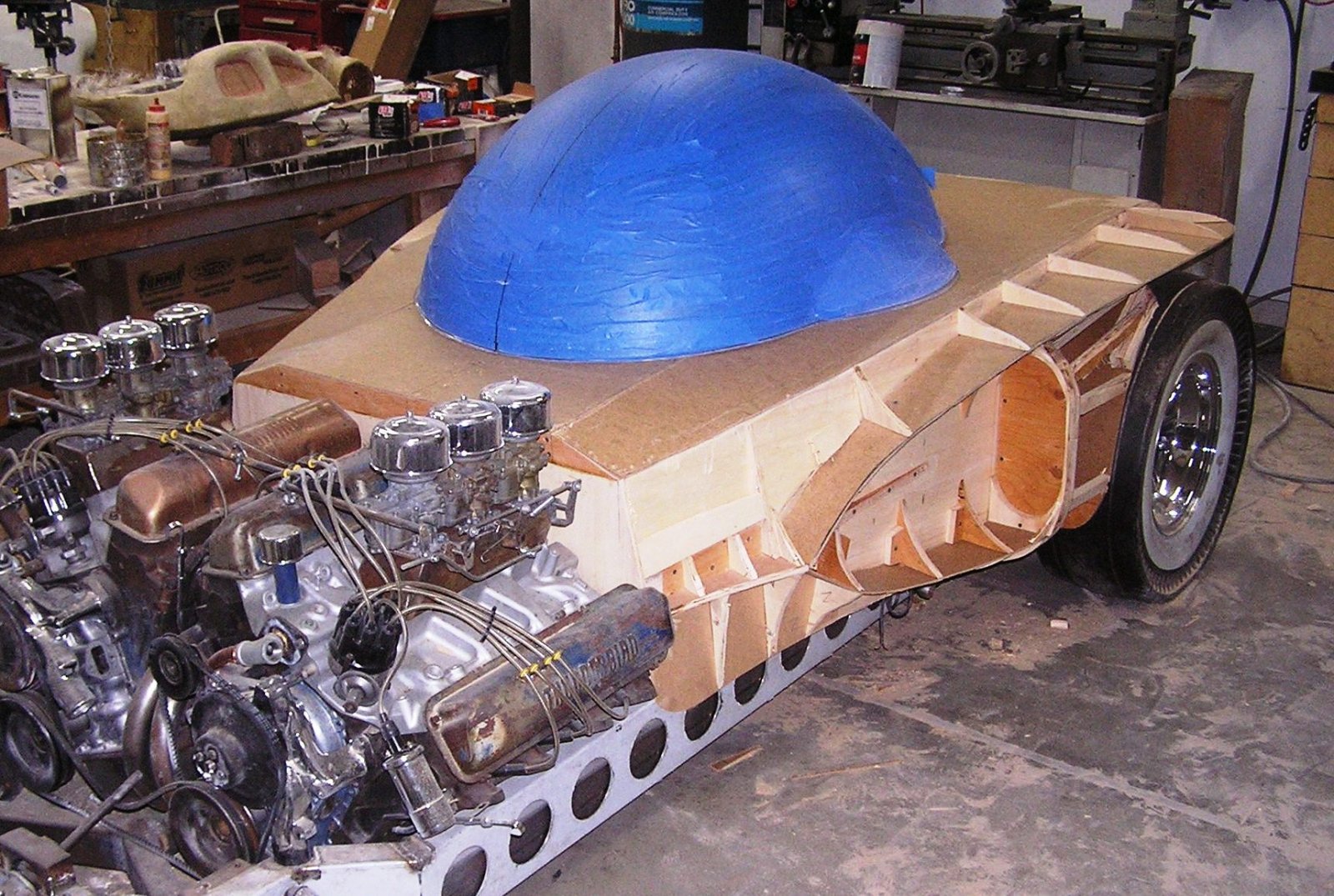

    Made the'gl*** body for my Ed Roth Mysterion reproduction.
    body pattern 19.JPG body pattern 'glas 2.JPG Cowl mold.JPG P1010440.JPG Molds on buck.JPG P1010449.JPG P1010480.JPG

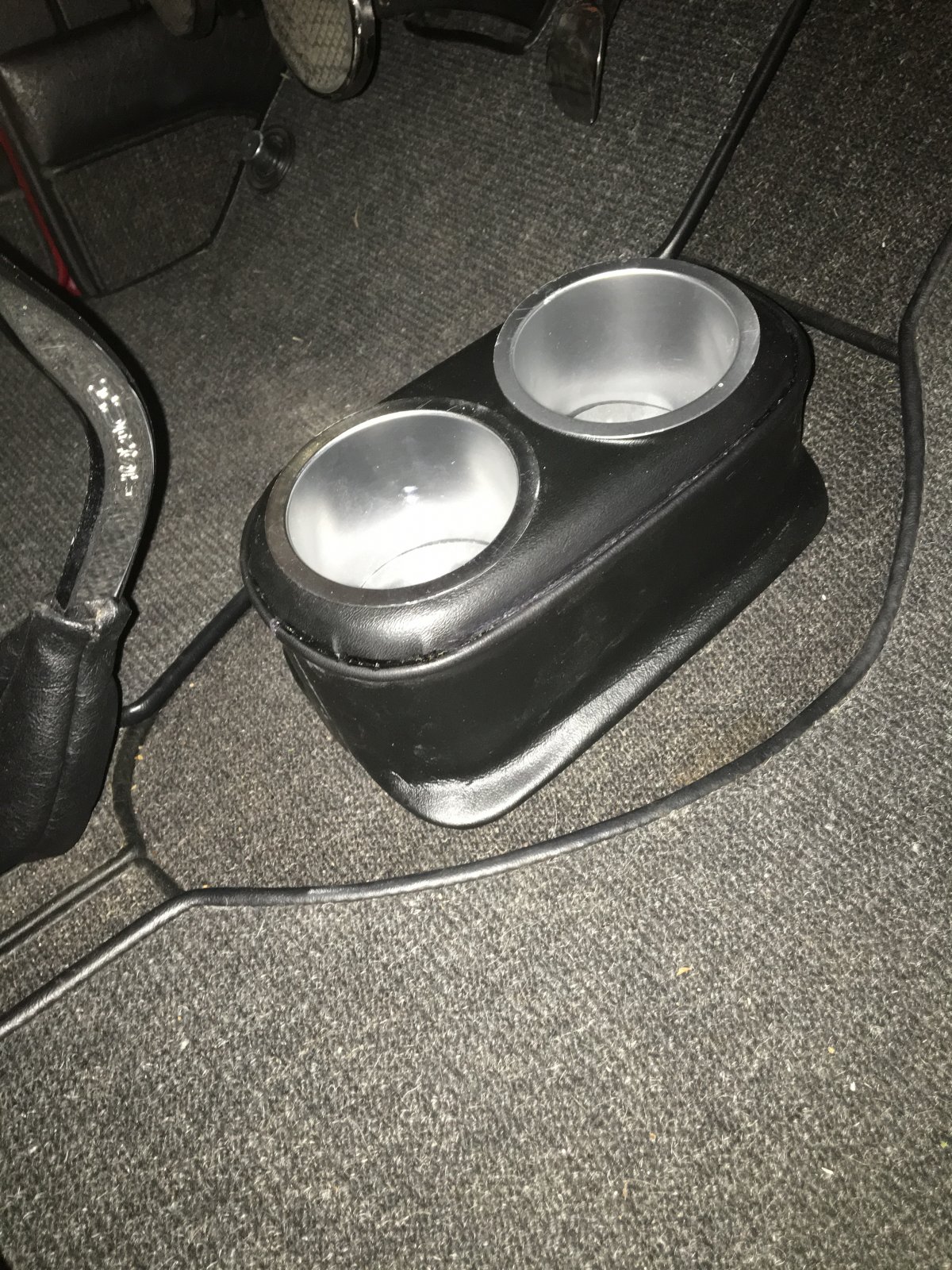

    You guys are WAY out of my league. The biggest thing I’ve ever made out of fibergl*** is a cup holder for my roadster. FFCFE707-C72F-45BA-BFBA-68422AB81B4C.jpeg

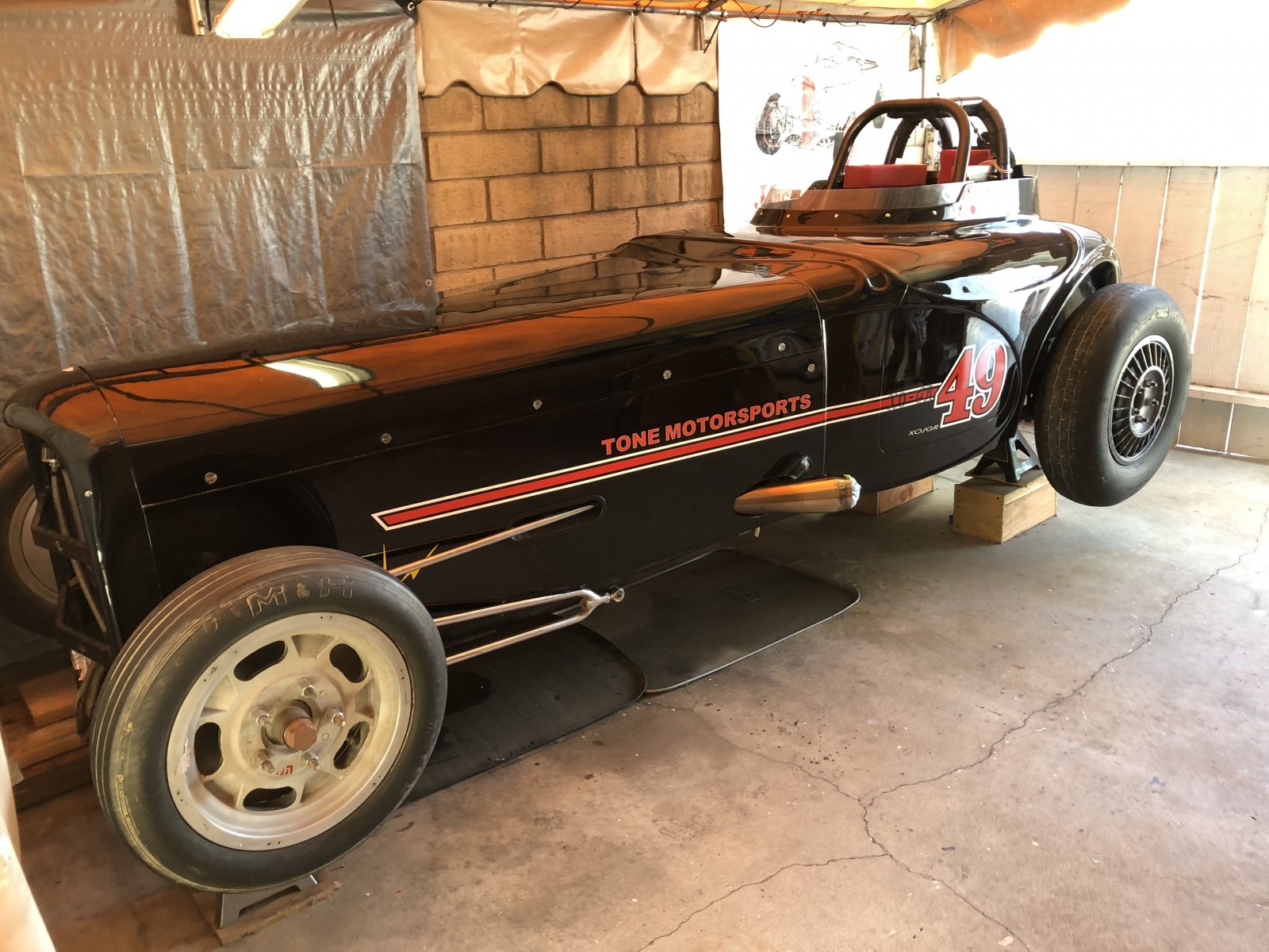

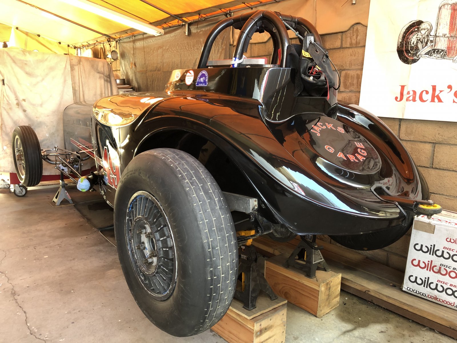

  8. For the Bonneville car I made a couple NACA scoops and the nose
    [​IMG][​IMG]

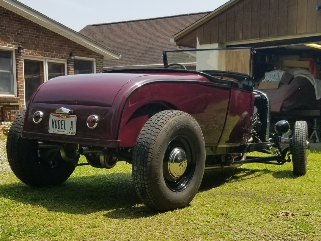

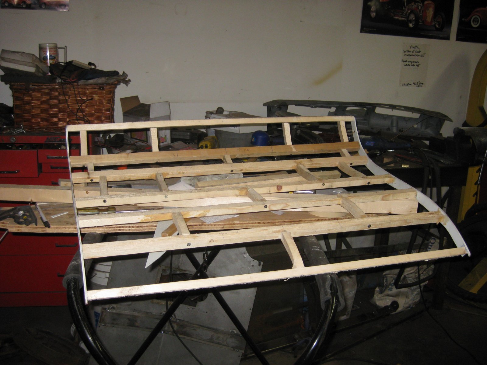

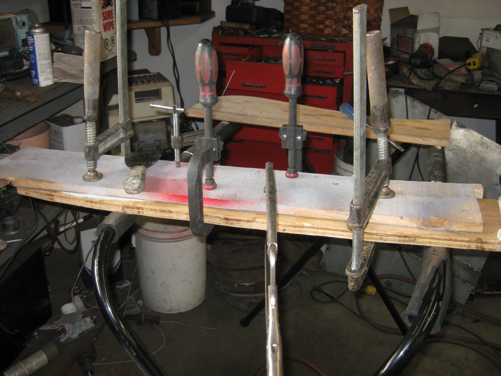

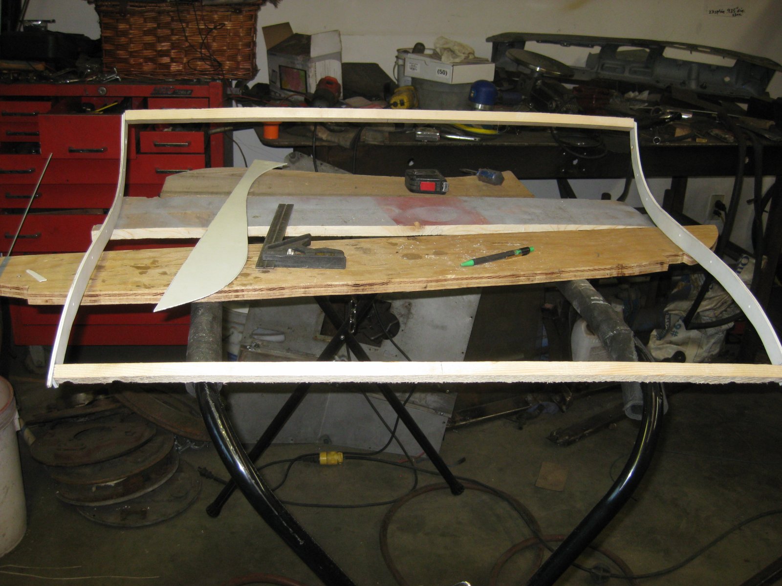

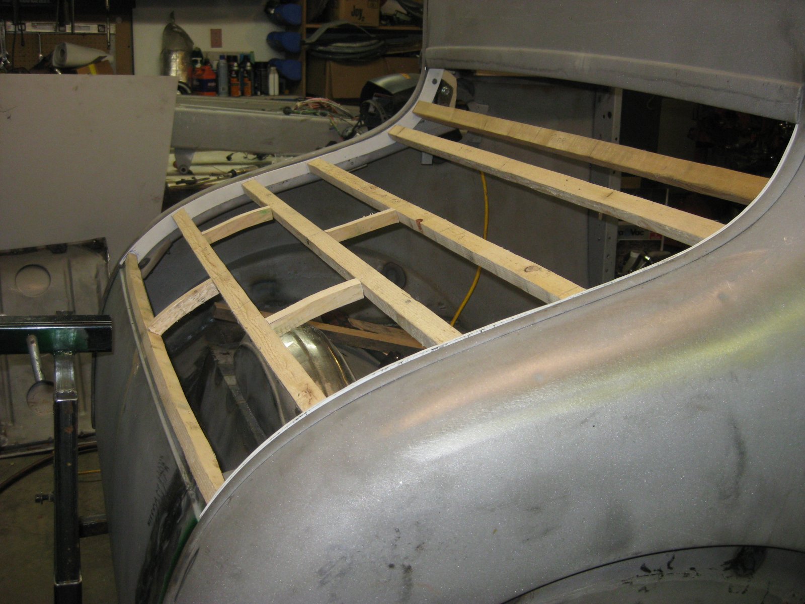

    I didn't have a good trunk lid for my T coupe or a good one to borrow to make a mold from. However, I had some fibergl*** reinforced sheet left over from skinning my teardrop trailer and a bandsaw so I used that. Added a bunch of wood screws, more fibergl*** matt, etc. and hope it works. IMG_1376 - Copy.JPG IMG_1376 - Copy.JPG IMG_1377 - Copy.JPG IMG_1377.JPG IMG_1378.JPG IMG_1379.JPG IMG_1380.JPG IMG_1381.JPG

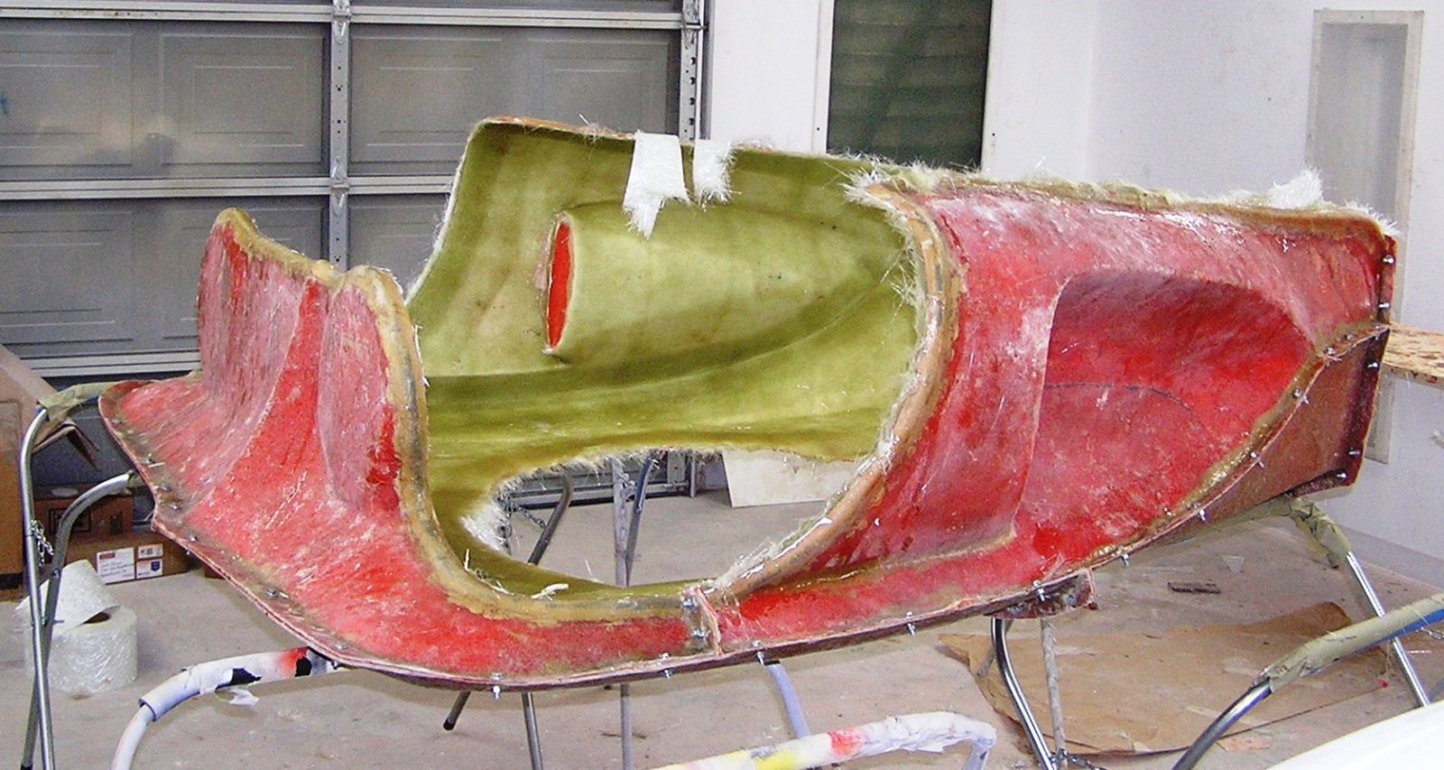

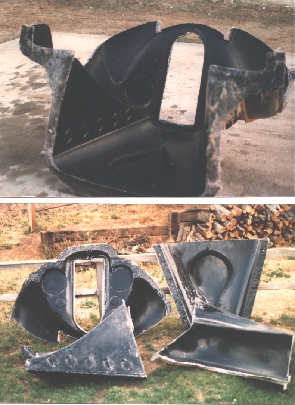

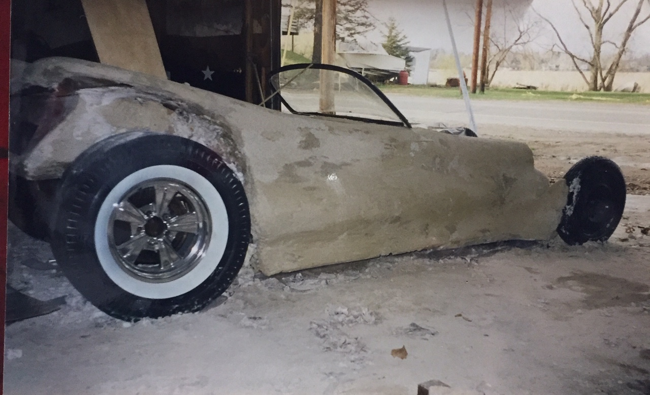

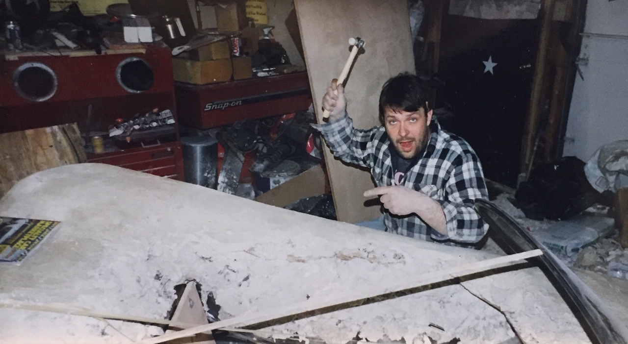

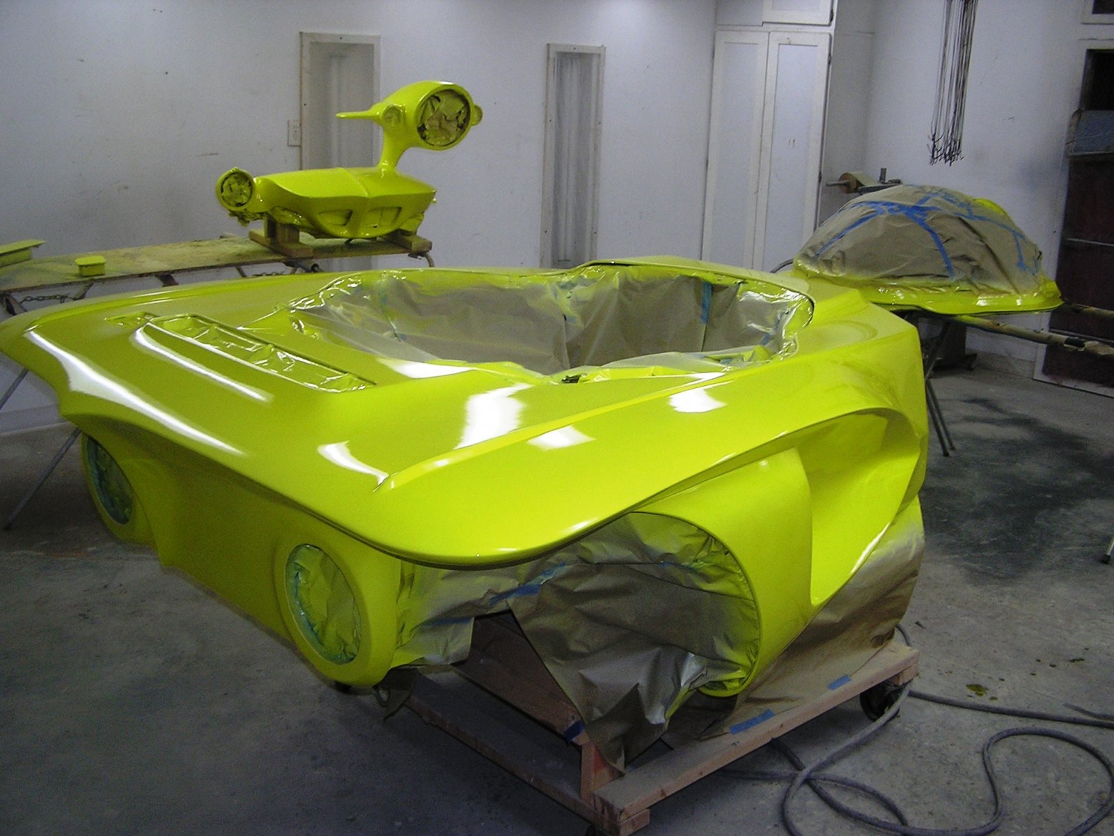

    I made a gl*** body for my Ed Roth tribute car the Futurian. I did not make a mold though. I built a plaster buck as Roth did and gl***ed over it and then ground and sanded it smooth. futurianbuild1.jpg futurianbuild2.jpg november22.JPG

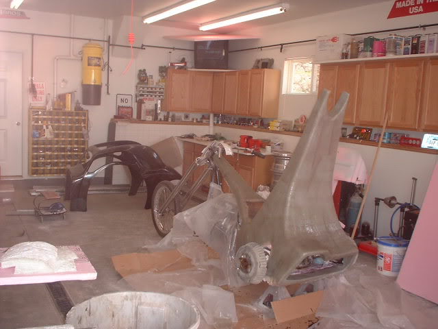

    I also built a fibergl*** body for the chopper trike I built. It is off topic here but here is a link to the thread in the antiquated section
    https://www.jalopyjournal.com/forum/threads/the-public-nuisance-trike.1106007/ trikeconst4.JPG
    I also pulled a mold from a steel Fiat Topolino dragster body that @guffey bought and we produced and sold a few bodies. this is the only pic I have of one of the bodies

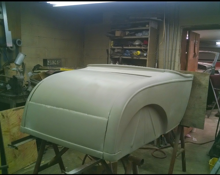

    I also helped my friend Paul make a gl*** 29 Ford roadster body and we used the body I had to make the mold.
    It turned out nice, we built rectangle steel frame but it really didn't look that good and then i suggested that we could make a mold off a pair '32 frame rails I had and we did that, no one could tell they were fibergl*** and it really improved the looks from the side.

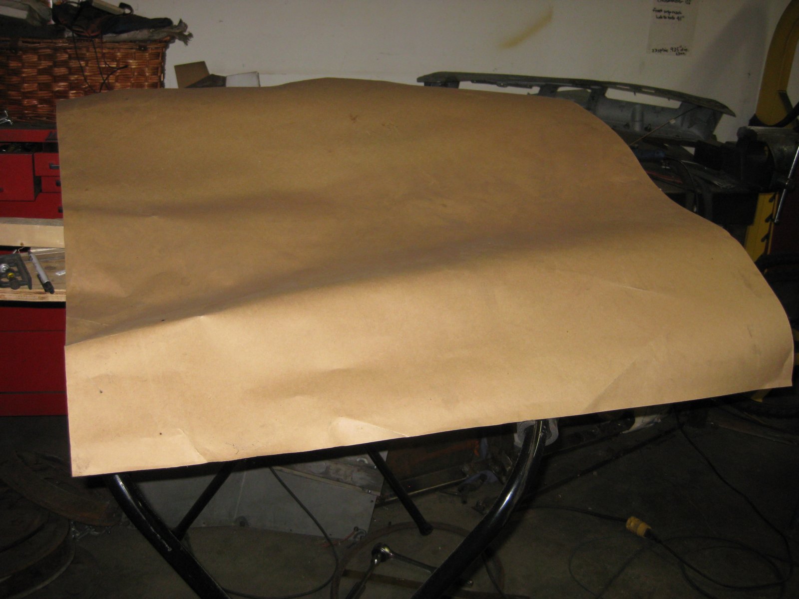

    When I was about 16 years old. Very technical stuff. Rebuilt the rusted out rocker on our family's 12 p***enger Econoline van... under the double wide doors on the p***enger side.
    Of course, first filled the boxed section with wadded-up newspaper. Then I mixed up a whole lot of tiger hair and piled it the full length of a 1 inch board that was as long as the rocker. Took the whole deal and pressed it against the damaged area. Before the tiger hair set up completely, I peeled off the board. Perfectly flat and straight. Sanding primer and paint and it lasted quite a while before chunks started falling out.

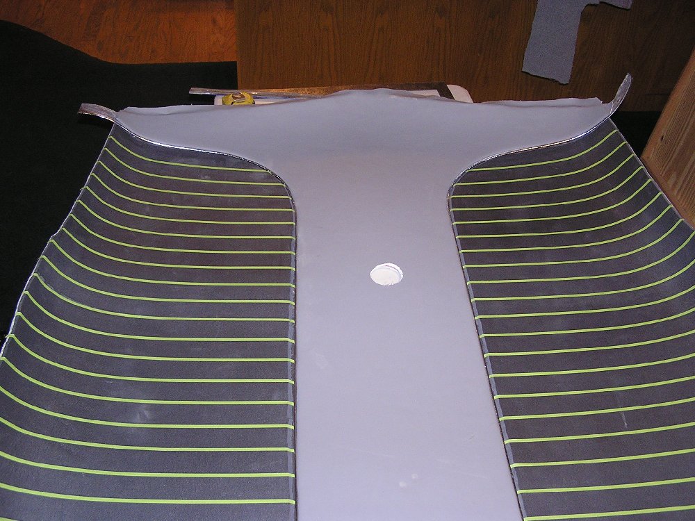

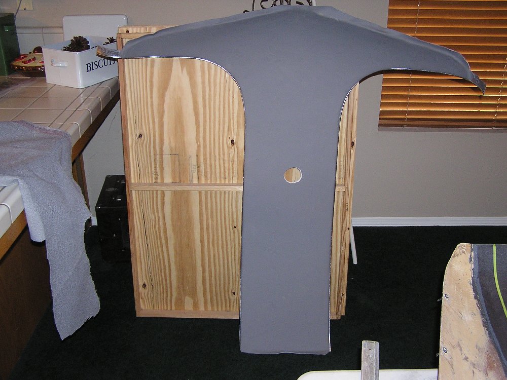

    One small part I made was for my '36 Pontiac sedan. The factory had made formed cardboard covers for arm rests for the rear seat thaat covered the rear whrrl well. They were pretty dseteriorated but I was able to piece them together and put on a couple layers of resin and mat and get a great reoproduction.
    That brings to mind a great tip. Duct tape, aside from preserving civilization as we know it, makes super 'gl*** forms. I streched 3 layers of tape for a sort of smooth surface over the steel tubing skeleton of my Mysterion interior, then put 3 layers of resin and mat over that. When the 'gl*** cured, the tape stripped easily from the back of the part.
    interior panels duct tape 1 - Copy.JPG interior panels duct tape 2 - Copy.JPG interior panels duct tape 3 - Copy.JPG Seat buck 6.JPG seat buck back 1.JPG

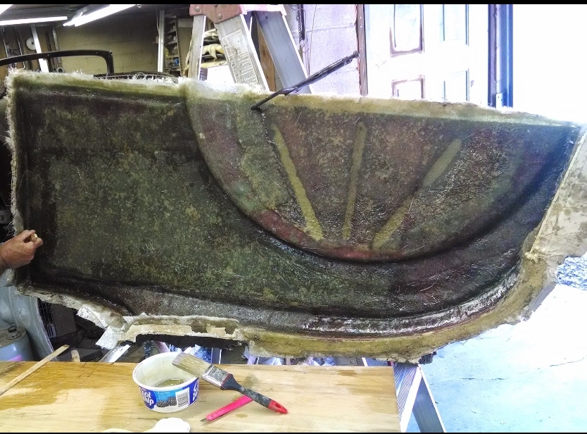

    I had the cowl and doors to a Model A roadster but not the back half so me and my grandpa made it out of gl***. Screenshot_20220120-152909_Photos.jpg Screenshot_20220120-152929_Photos.jpg Screenshot_20220120-153312_Photos.jpg Screenshot_20220120-153353_Photos.jpg Screenshot_20220120-153448_Photos.jpg Screenshot_20220120-153540_Photos.jpg

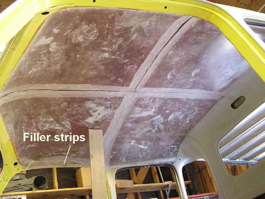

    Just remembered another fun 'gl*** project I did a while ago. I king-cabbed a '53 Chevy pickup and needed a headliner.
    I made a 'glas panel on the top of the finished cab that had been painted with single stage acrylic and waxed with mold release. Also sprayed on a coat of PVA to insure it would come off!
    3 layers of mat and resin yields a little less than 3/16".
    I built a support grid of 3/4" steel tubing to support the extended top and to attach the headliner.
    Obviously the resulting panel is way too big to fit inside the cab. I cut it into 4 pieces.
    peeling off the PVA was awesome! I buy electronic stuff just to peel off the protective film.
    I screwed the 4 panel sections into the top making it easy to mark how much to remove to make it fit.
    This is the finished liner. I eventually split it front to back so it would fit easier and made a center panel to cover the joint and add more interest. All was upholstered.
    Here is the center panel being laid up. It is only 2 layers of mat.
    Here are the parts being upholstered and the final installation. 22 headliner insert.JPG 23 one last test.JPG Headliner- door finished.jpg

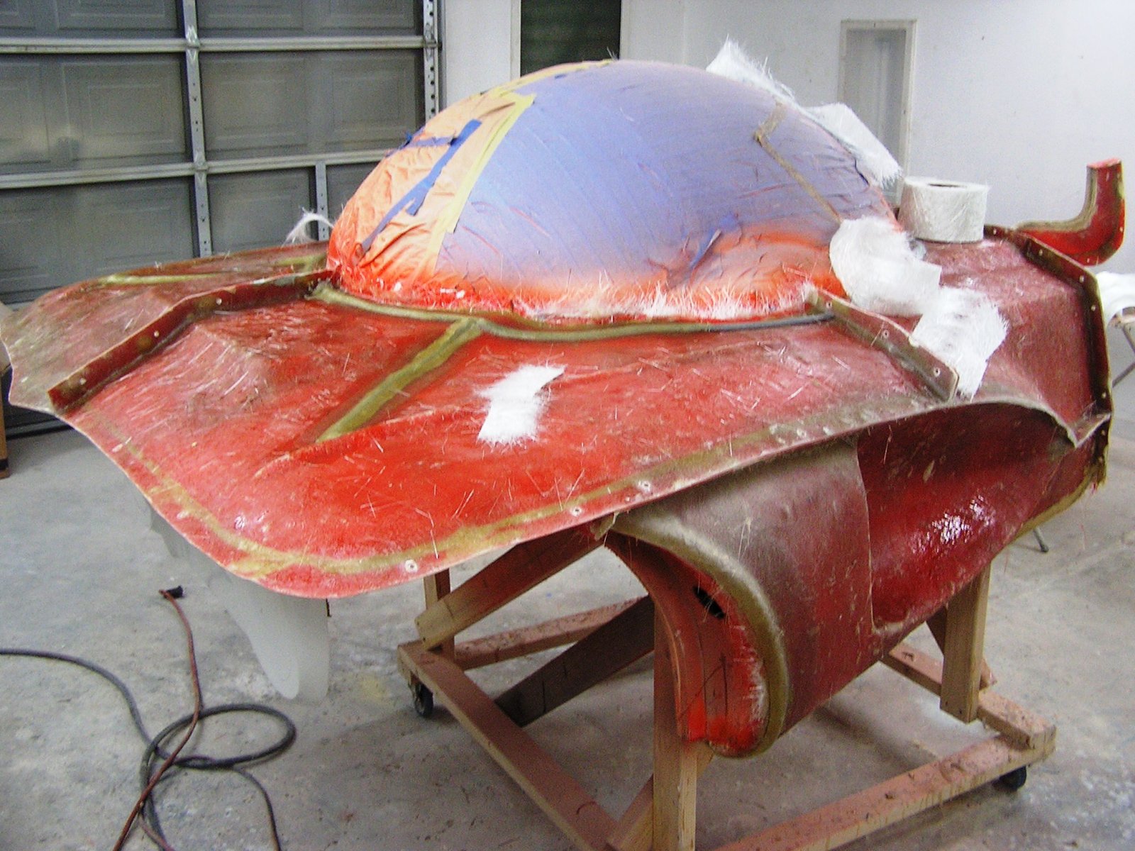

    F461050D-8B41-4657-9783-808D8C9AC932.jpeg 93B90599-B0EF-4D46-B093-4BA35F328541.jpeg The shroud the windshield attaches too and the driver surround on my LSR roadster. Was flat when I bought the car in 1981. The inner rear fender wells too.

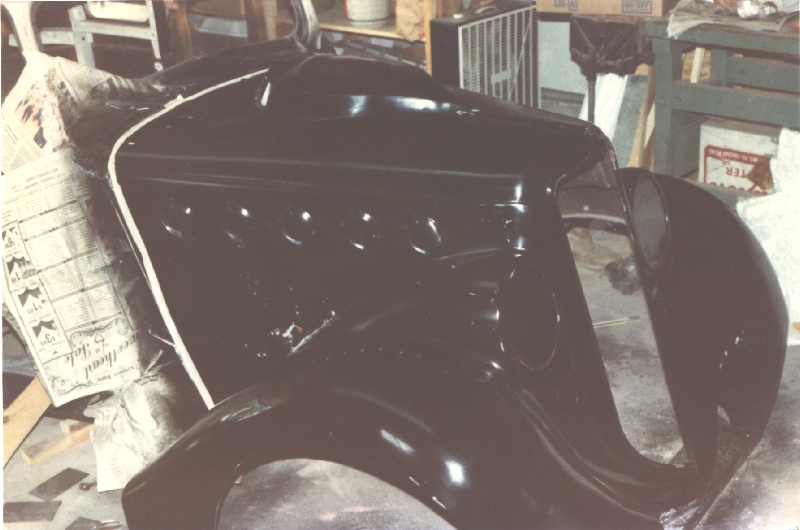

    I made the gl*** nose for my shoebox back in '76 the same way Mark did, mold release, gl*** lay up with wood re enforcing. Was a ***** to make the wheel opening run-offs to get the radius lip for the final mold. Was so hard for me to make the mold I took it to a boat manufacturer and had them lay it up; chopper guns are great;) and 2 hrs of a Saturday morning. Made a plug [Body filler and screen] and a mold [body filler and wood] to make the Fibergl*** rear rolled [layed up] pan which bolts in.. Fan shroud and engine cover [Styrofoam/duct tape] molds layed up over and spatter painted to smoothen cloth texture ..And a few other ducts and tanks and covers; few things for other people but by then I was Gl***ed outo_O.

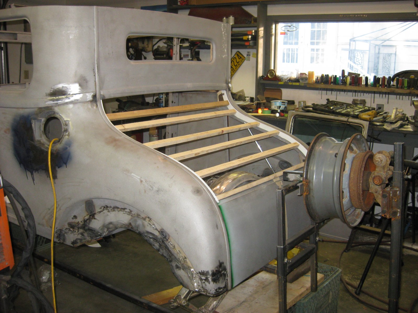

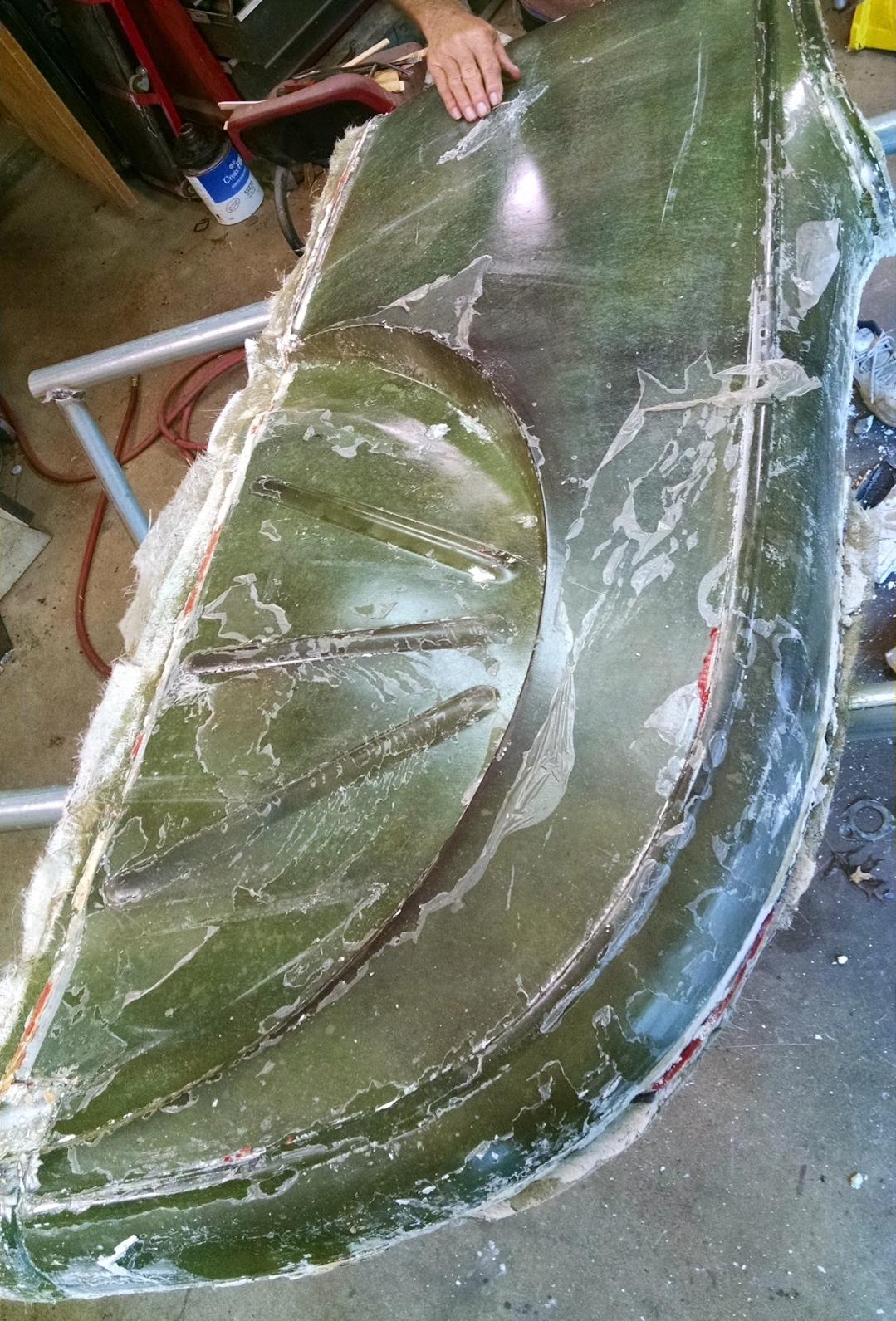

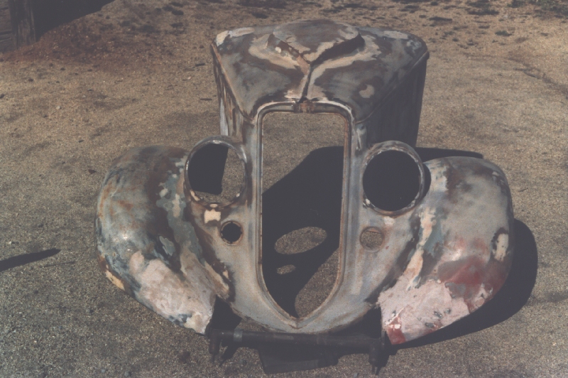

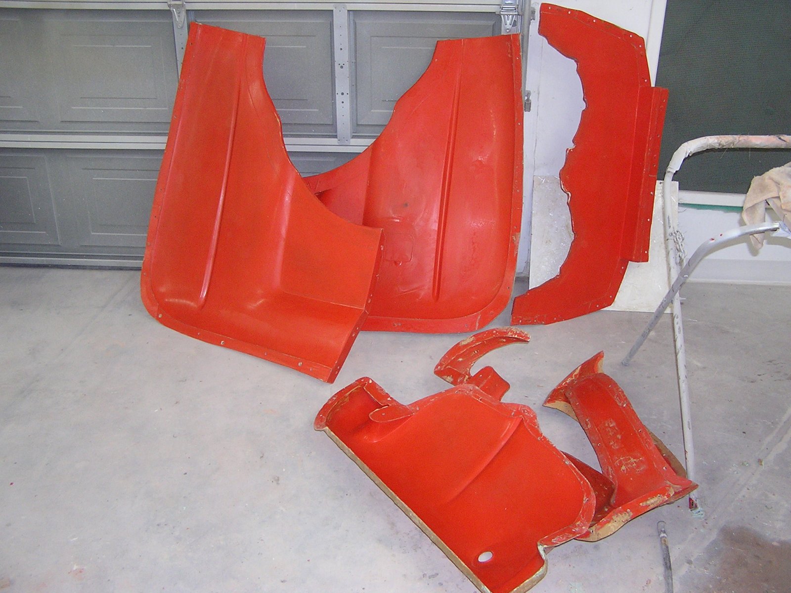

    We made several parts on my son's '38 Dodge the sides for the lower grill, pieces to eliminate the original headlight mount and lower hood panels. The process consisted of shaping pieces from foam, making plaster molds and laying the parts. We chose to go that route as we did not have a good way to make the tapered body reveal along the bottom of the lower hood side. It turned out well.
