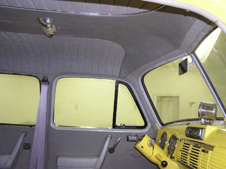

    My question is perhaps a little O/T for a fibregl***ing thread, but what vehicle was that dome light taken out of please?
    Got me curious as I have one in my avatar. They were used in the Aussie extended wheelbase GM Holden luxo-barges in the late 70's.

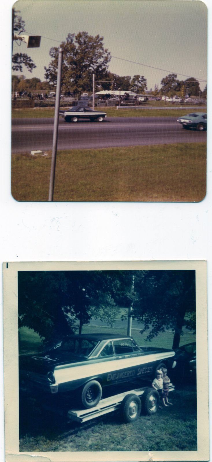

    Bumpers for my '65 Falcon sprint and a bug catcher for my T roadster

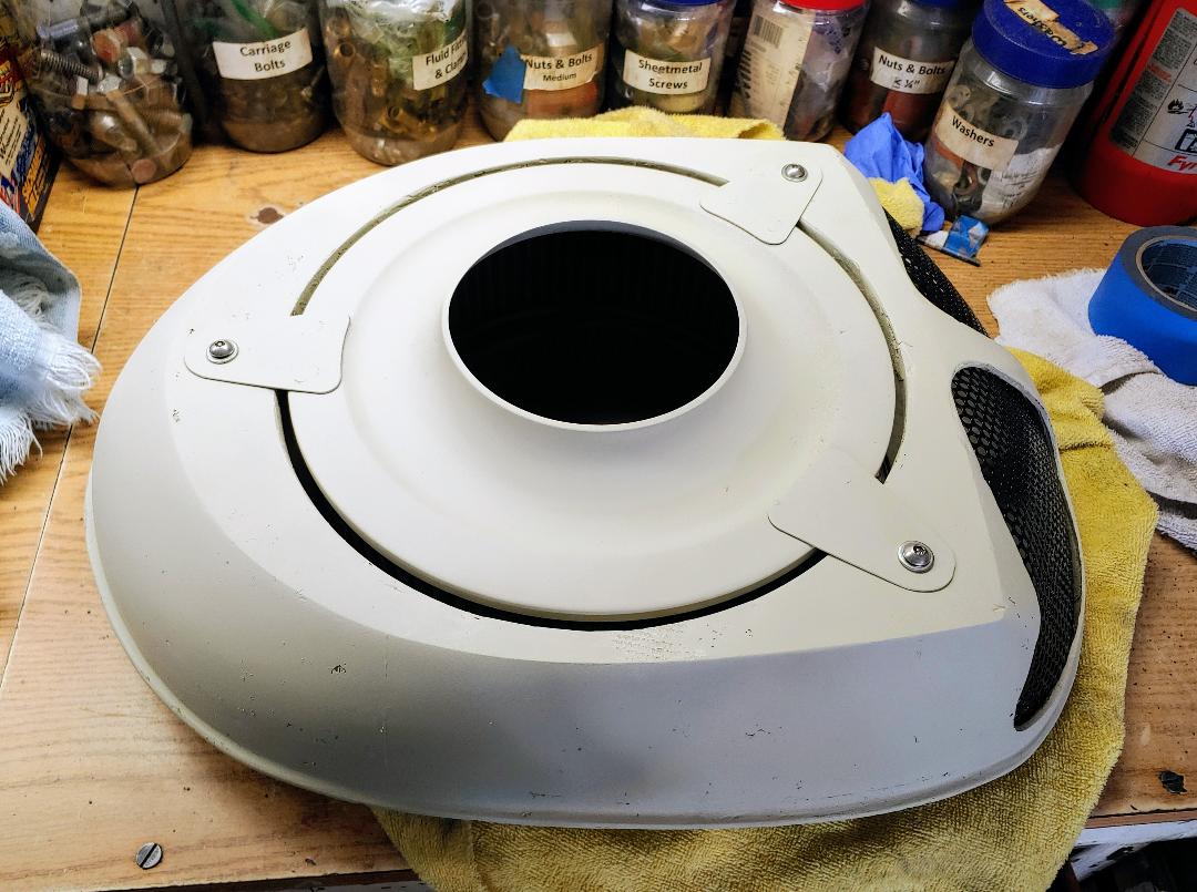

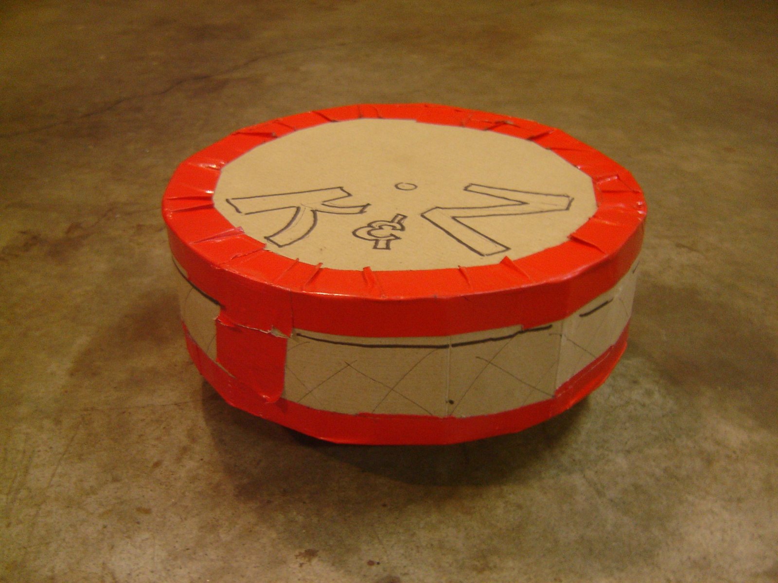

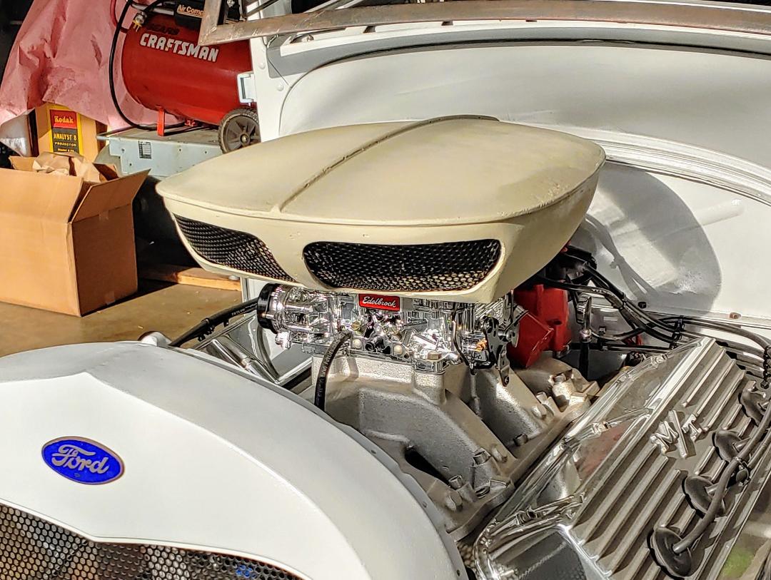

    I made a Greer/Black/Prudhome -style dragster scoop that fits over a K&N air filter.
    First a metal, plywood & 'gl*** buck. Then top & bottom female 'gl*** molds. Finally, the scoop itself.
    gbp 002.jpg gbp 005.JPG gbp 020.JPG gbp 065.JPG gbp 070.JPG gbp 080.jpg gbp 110.jpg gbp 130.jpg gbp 145.jpg gbp 165.jpg 20200310_171010_2.jpg 20200310_171246_HDR_2.jpg

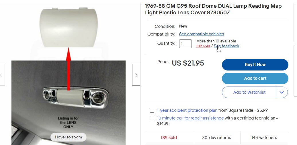

    A junk yard part, I use them in all my cars. Never paid attention to what year they come out of but I do know they were used in all upscale GM cars 80s - 90s? I looked on ebaY says '69-'88.

    78 Trans am used them. I have bought many :cool:

    Oh man, don't say that. My daughter BADLY wants a Screaming Chicken. I keep telling her I can't afford one. If she gets wind that the dome light in the wagon came out of one, she'll lay claim to the avatar :D:eek:

    They were also used in late 80's-90's full sized Fords. Look just like the one in the photo.

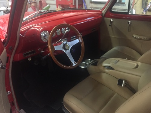

    Here is a poor shot of the interior of my wife's 1954 Chevy 0B239CCE-0785-40A6-A326-7F6221B98182_1_105_c-resized.jpeg .
    I made the gauge cluster surround, the fibergl*** piece that replaces the speaker grille in the dash center, and the glove box door. You can not see it but under the dash is a fibergl*** panel that cover the gm steering column and hides all the switches and brackets.
    I usually make the pieces out of foam, then lay up the gl*** on top of the foam, and finally I bust the foam out of that back. This works for one off pieces or plugs to make molds.

    On the domelight, the GM version grounds out at the switches, and the Ford ones ground at the light.

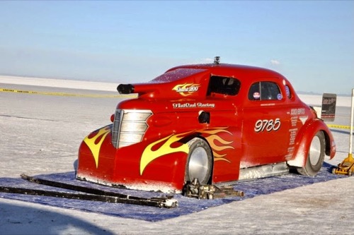

    I built the complete front end except for the hood and hood sides of the Flat Cad Bonneville car. Bonneville cars take on an odd appearance because of the rules that regulate what can be done to modify the bodies for aerodynamic improvements. 165E59F7-0447-4C01-9894-D8A9A2D69E55_1_201_a-resized.jpeg
