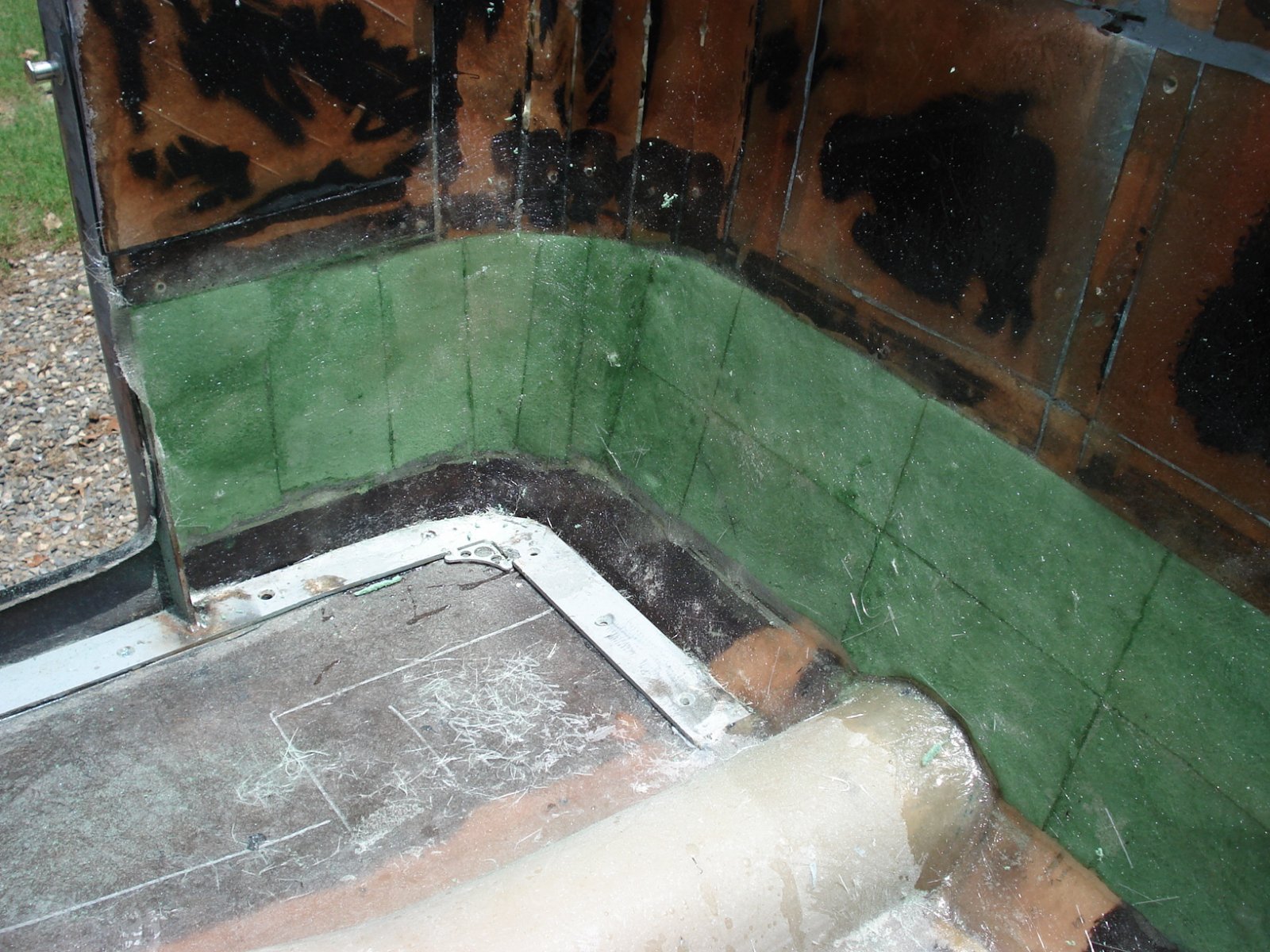

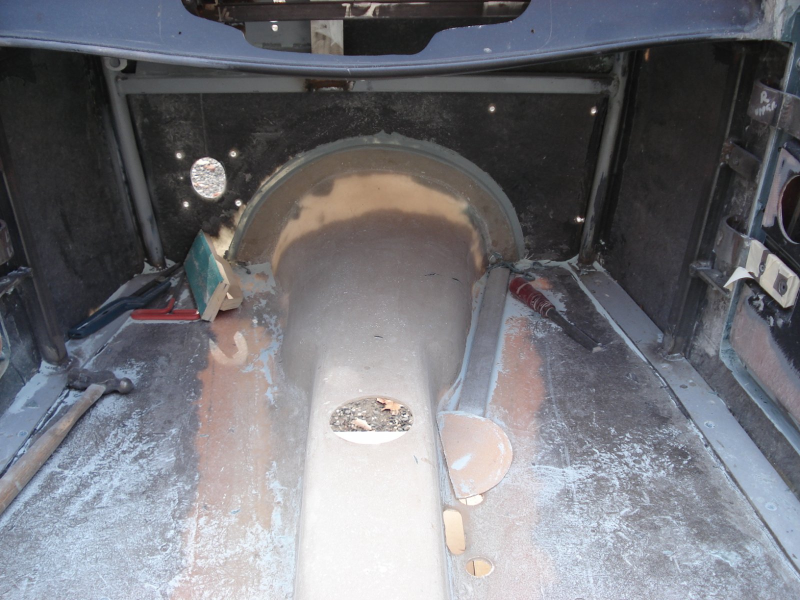

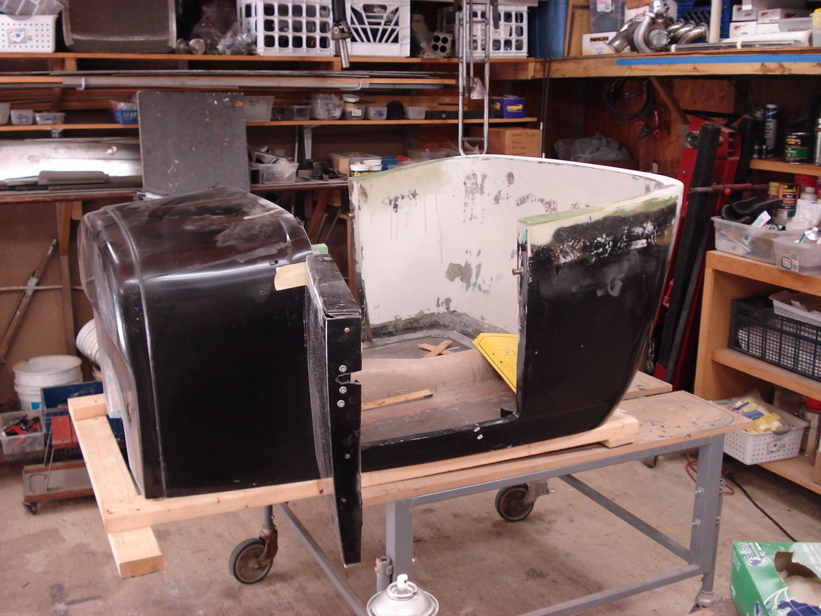

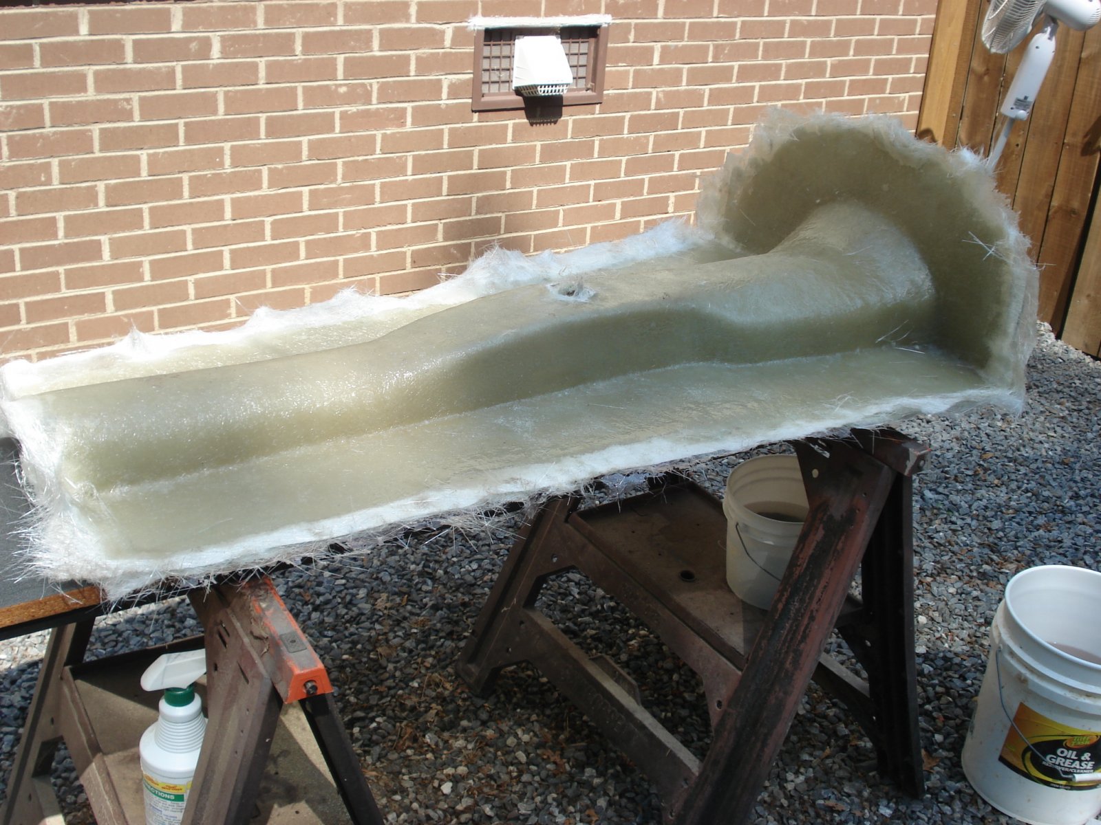

    Floors , Tunnel , Inner rear panel , doors...Itchy-Bitchy...

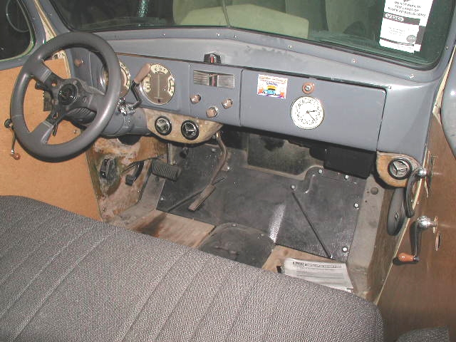

    Just remembered another couple pieces I made forv vthe '36 Pontiac. I fit the speakers, trunk release, emergency brake pedals, etc., to the kick panel area then filled in with styrene board and layered it with 'glas. Got custom kick panels out of it. Photo also shows a couple small AC vent panels.

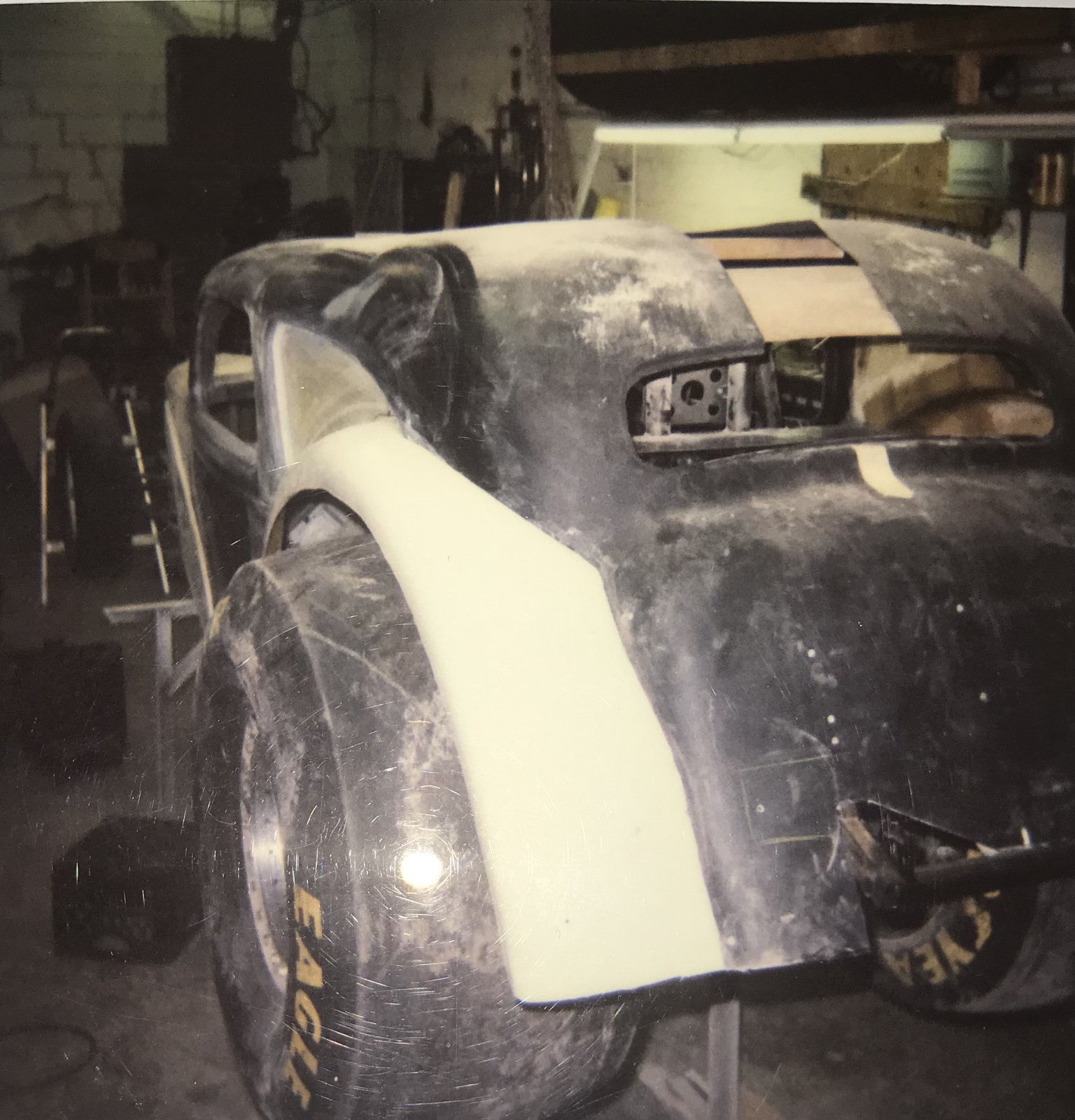

    B5A20294-FA0E-46E3-B4D1-0DACDCBC1A70.jpeg 21E5F7B1-7B98-4340-9B9D-806C48359B40.jpeg 305FA403-AB38-4CB1-BA3C-4775F9CEFC7F.jpeg 0FBBEB09-0E61-4A30-8C42-79455BD7ADA7.jpeg DA0B59C1-705B-47E3-9D6E-BDA83765488A.jpeg The topic is ‘glass parts so I hope this post doesn’t get bounced, the body is on a funny car chassis, but it is a ‘48 Anglia.
    Being a fuel altered we knew the front fenders had to go so we cut them off first and used the grille and front of the hood as part of the mold for a 22” extended front end with panels added to the sides. The rear fender molds started as front fenders from a ‘60’s Peterbilt modified to suit. The front had canards and fire bottles added, that is what the cuts were for.
