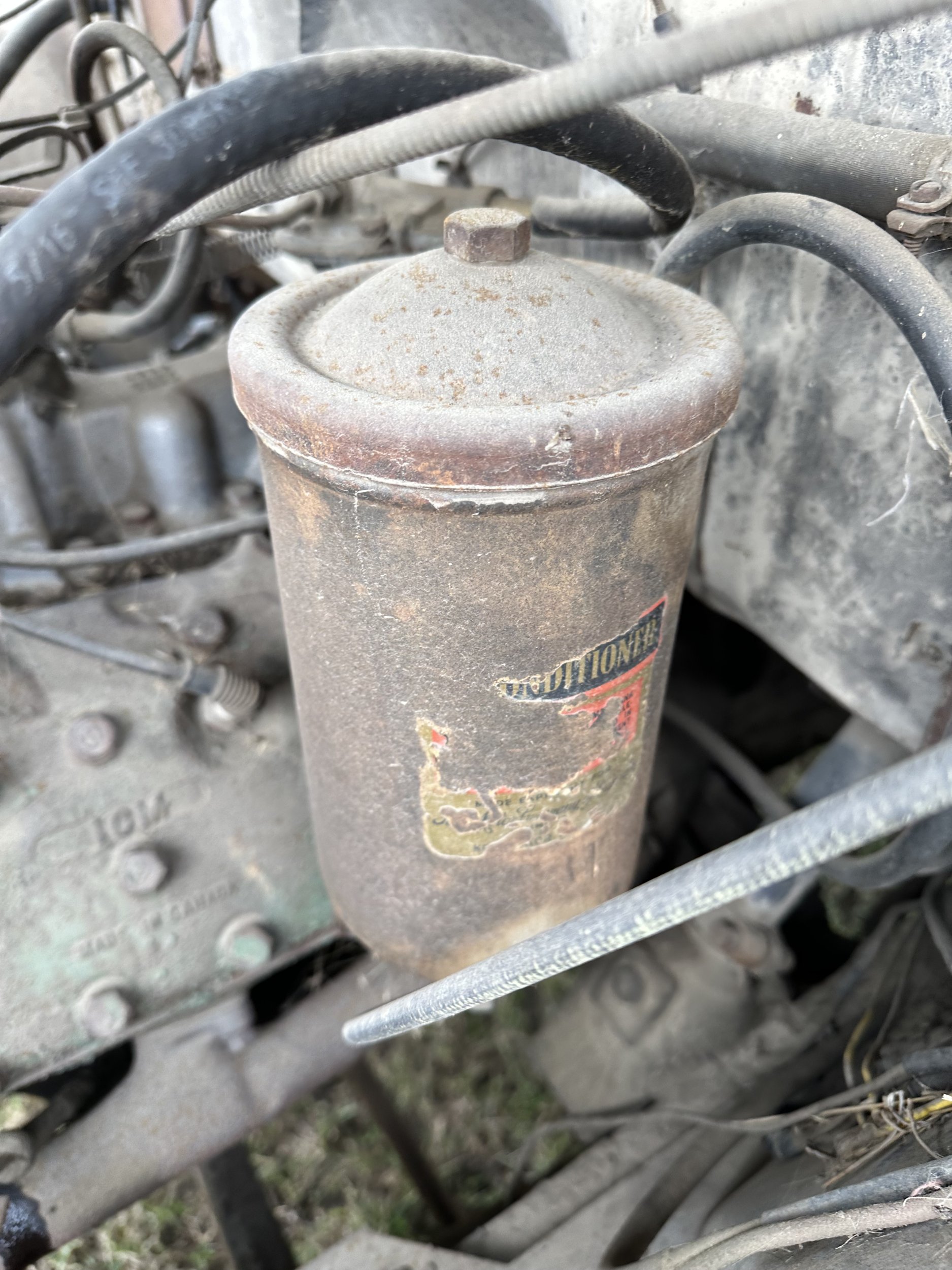

    I’m trying (going) to get my 53 F600 running to haul bales on my farm this summer.
    It runs and I have a video to prove it. Next is hooking up the fuel line and then replacing the master cylinder and hoping that the rest of the brake system is operational.
    I want to change the oil too. What filter element lurks in this housing?

    take it out and look at the number stamped on it? :)
    but it does look like the original Ford filter, which would take a Wix 51006
    do some measuring

    Thank you. Next question… I’m planning to just run Rotella 15w40 in it. Any issues?

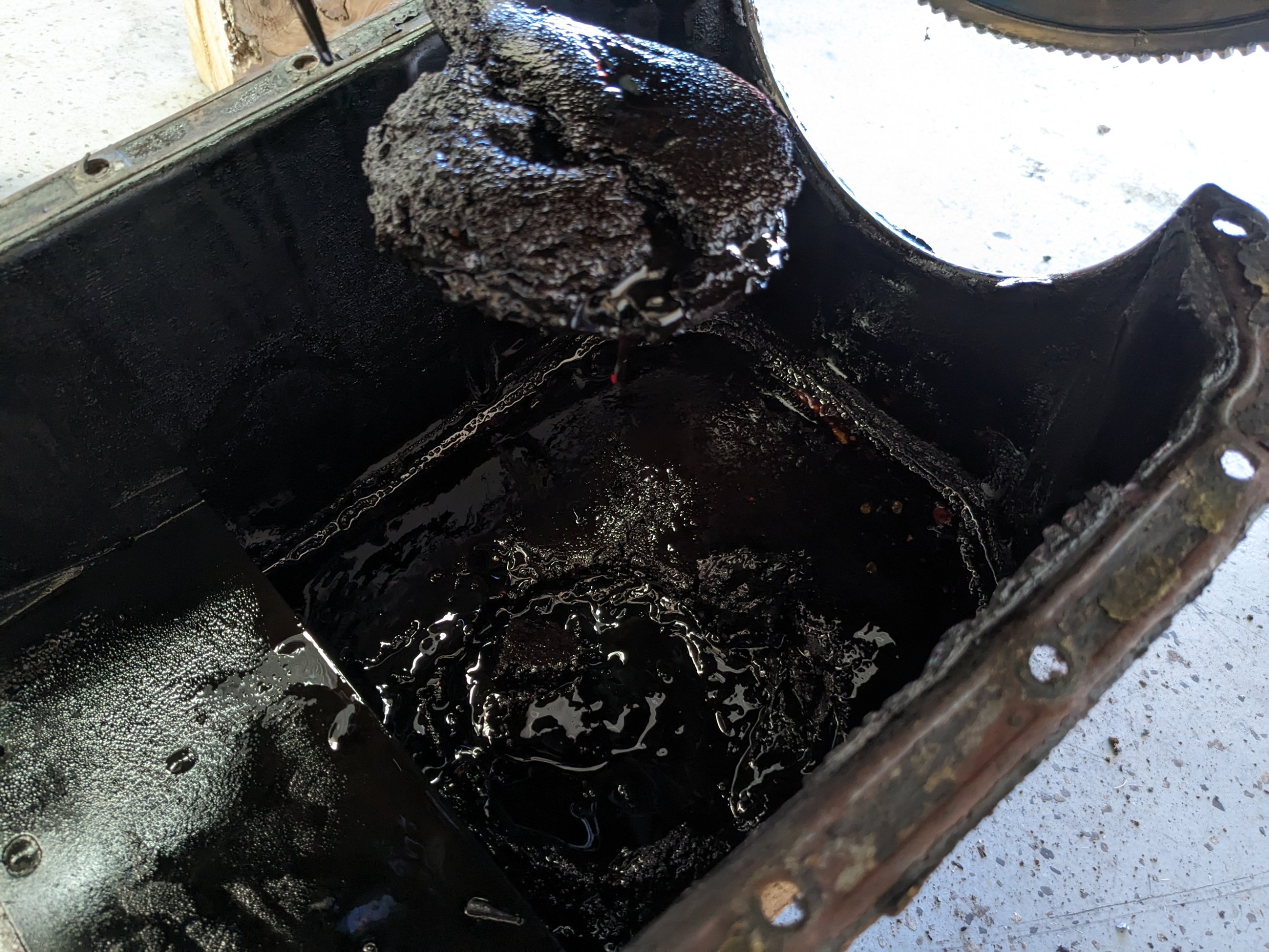

    would you also think about pulling the oil pan and removing all the sludge?

  8. The old **** around here ran straight 30 nd most of the time
    Had old guys running it in the 80s growing up.
    My old 67 ran it. Old owner wrote on the inside of the hood.
    Dang near completely stopped up when I got it

    The engine was rebuilt at a ford reman shop in 1974. Beyond that, I know nothing about the history of the truck. I’m going to run rotella in it, I run this in gas engines all the time including endurance race engines - the car in my avatar had rotella in it in that photo.
    Thanks for your help, filter ordered from Jebediah Bezos. I hope to get a chance to change it this week.

  12. My hood
    You didn’t see it
    Had ND wrote on it
    Probably wouldn’t have beens completely full of sludge had it hadn’t
