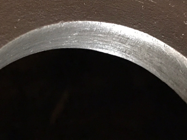

    Picked up what I thought was a cut down A/B flywheel setup for a V8 clutch.
    Was just comparing it to a stock A flywheel and the A pilot bearing just drops thru.[​IMG]
    Guessing this is a cut down flathead flywheel

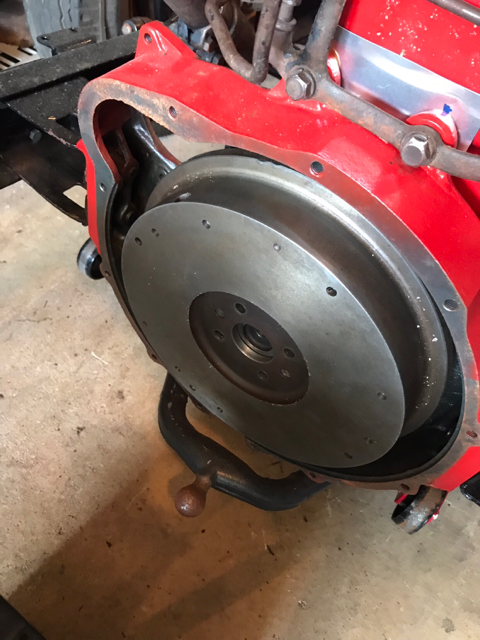

    Here’s a shot from the rear comparing to a stock A flywheel. Certainly looks similar, wonder it someone had just opened up the pilot bearing whole ?

    Looks as though the pilot bearing hole has been opened up for a bigger input shaft bearing.... probably using a different transmission.

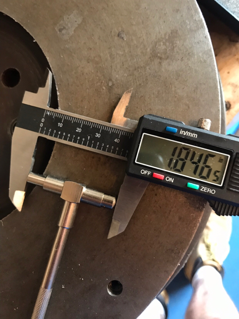

    It does look like it may have been machines out
    Measures out at 1.846
    Fits the crank and if I had the ring gear on it it seems like it’s in the right place.
    Time to find a pilot bearing that has a 1.845 OD, any ideas ?
