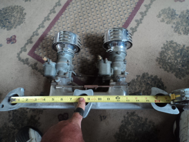

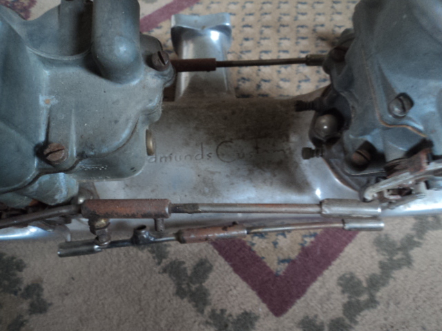

    I have a dual carb set up for a 5 cylinder ford. any hamber know exactly what it will fit?

    whoops I meant 6 cylinder!

    I had a guys 50 Ford car with the flathead six here a coupe of years ago, and there was an Edmunds head and dual intake in the trunk. I don't recall what the intake ports looked like, but if you are sure it is Ford, I bet it is that flat 6.
    Bear in mind what years Edmunds was producing parts...right then, not later OHV 6 fords

    Its not for a Ford, its for some variation of Stovebolt Chevy. All Ford six cylinders (that I know of) have 4 intake ports, the chevy's have three. Thats the quickest way to identify a chevy vs Ford intake.
  6. Yeah,the single bolt hole in each intake port is kinda strange. HRP

    Pretty sure that's because the 'clamp' with a single bolt to the head served as mounting for the lower portion of the intake flange and the exhaust manifold. That's pretty much a Chev intake.

    How about a medium size Dodge truck - DeSoto - Chrysler 6 ?

    Looks like Chrysler Flathead-6, to me.

    Maybe a 49-53 Plymouth or Dodge
