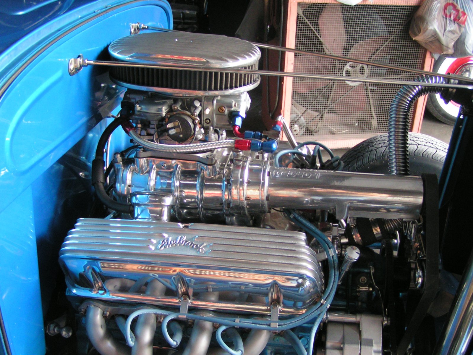

  5. chevyfordman
    Joined: Oct 4, 2008
    Posts: 1,521
    chevyfordman
    I agree with Swifty, if you go to the extra work putting a Ford in a Ford, it's show time. I've been in many rain storms and the engine cleans up easy and the rain doesn't stop a Ford from running. Just saying. PICT1244.jpeg
