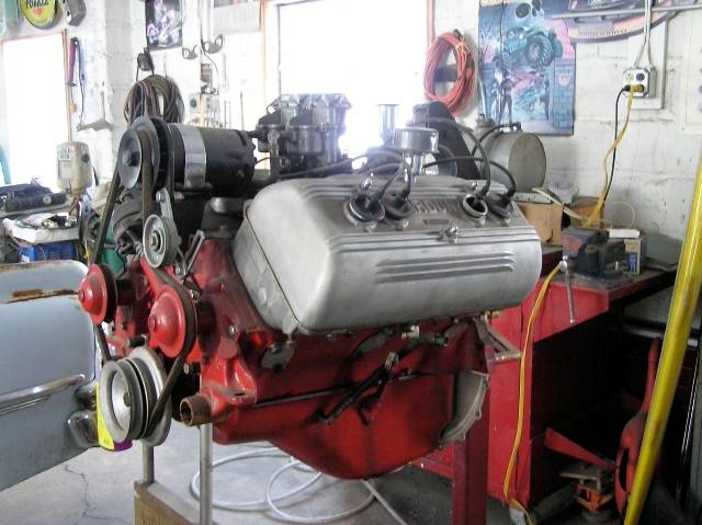

    ImageUploadedByH.A.M.B.1373730184.123653.jpg 1949 331 Cadillac absolutely no cutting or modifying anything except minor grinding on the drivers side exhaust manifold to clear the stock shift linkage ImageUploadedByH.A.M.B.1373730184.123653.jpg
