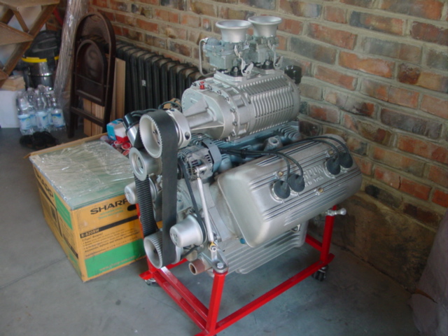

    And as far as my Ardun suggestion, that was totally serious.
    The kids that are too cool to own a SBC usually bring up the fact that they are popular, easy to find, and affordable to hop up as strikes against them.
    Since the Ardun is at the opposite end of all those things, it must be the perfect choice...

    MetalShapes..... LOVE that Ardun !!!!!!!!!!
    4TTRUK
  5. metalshapes
    Joined: Nov 18, 2002
    Posts: 11,130
    metalshapes
    Beautiful, isn't it...
    Not mine.
    Just a pic I found...
    ( but I can dream about having that in an old Allard, or a 3W Deuce Coupe...:D)
