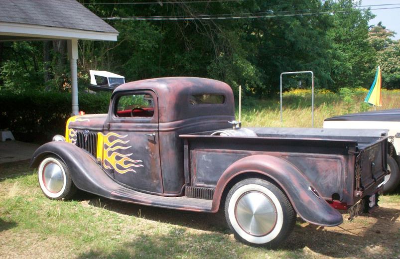

    Posts: 4,726
    big bad john
    ...Thats the way I went with my 36.....after 10 years..no problems

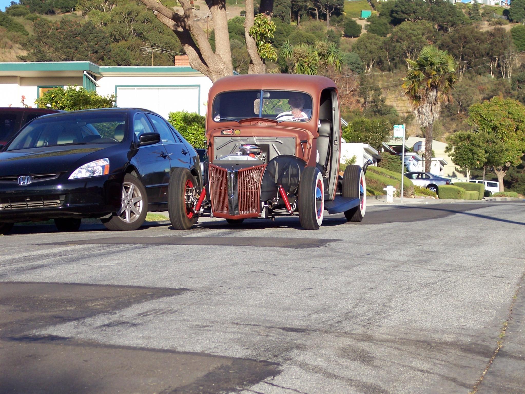

  28. SOCAL PETE
    Joined: Oct 19, 2006
    Posts: 1,204
    SOCAL PETE
    from Ramona CA
    Wise words.
    Hair pins and a drop axle. Simple and sweet. Put hair pins and a 4 inch drop Bell axle over the spring under my 37.
