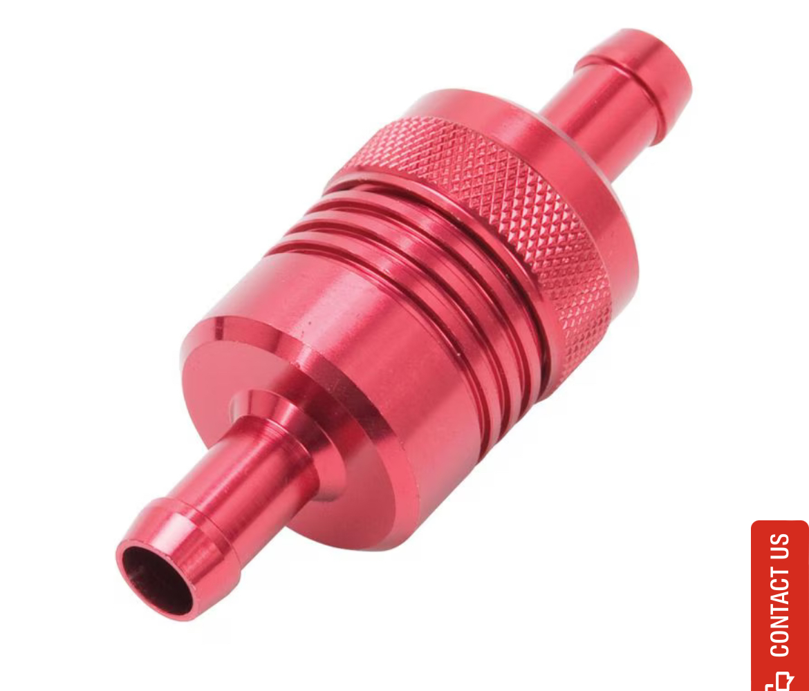

    My choices are aluminum filter housings with reusable SS elements that can be dis***embled and cleaned. They are available in various sizes, colors, configurations, price and micron filtration.

    I use them too, found on eBay in a 5 pack for a good price. The clear plastic ones give me the horrors.

    I have an Earls 85-micron #2302206 filter between the tank and pump,
    and an Edelbrock 40-micron #8129 between the pump and carb. Both can be dis***embled, cleaned and reused.

    I'm currently using one of these from Amazon. Installed between the fuel pump and carb. 30 micron bronze element. Comes apart for cleaning. Seals with an o-ring which hopefully doesn't turn out to be weak point in terms of leaks. I also have a metal can WIX between the fuel tank and pump.
