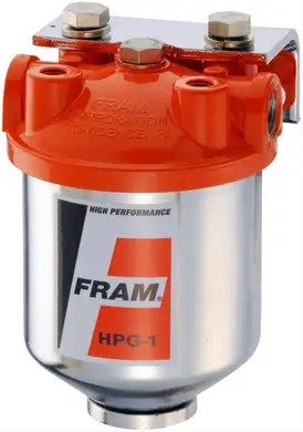

    Nope, nothing wrong with these. I recall that you could put a filter inside:
    The steel cansiter, newer style ones like below are not so good. I've had two fail internally, the filter came unglued allowing all the dirt to be released. When I took them off and drained them, I could hear and feel the element inside clunking around when I shook 'em.
