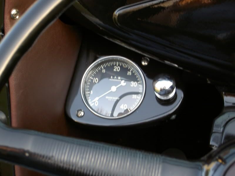

    Koolman

    I relocated the ignition switch to below the seat. I've also done another add-on pannel in a different car that had a tach and one other gauge.. You could put the ignition switch next to the tach in the example above. The picture above shows the tach and a stock Model A illumination lamp like the one in the center of the dash..

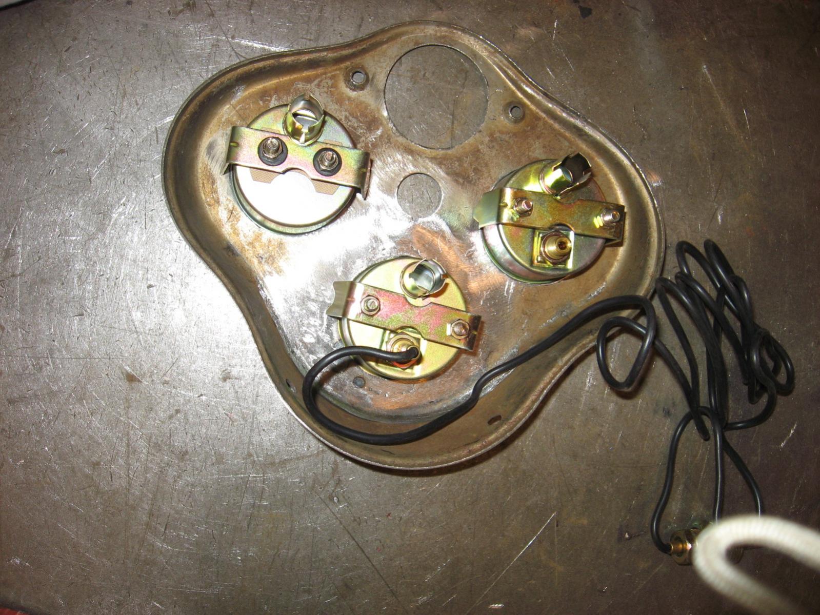

    Here is my gauge panel. I am using the original tank for gas and its original gauge, the center hole is for my ignition switch. The gauges themselves are cheapies for now but there is lots of room for them. I filled the panel and redrilled the holes for the 3 gauges.
    The speedo is mounted on the column in a bullet tailite bucket.
