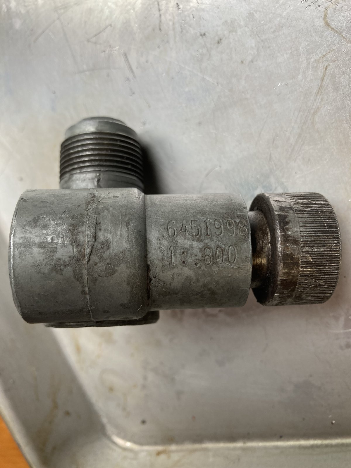

    I have an AC 1 : .800 ratio 90* adapter on the transmission cable. This seems to be an unusual part.
    Recently the speedometer has started erratic needle swinging and is no longer reading true when compared to GPS. I have previously swapped the drive and driven gears in the transmission, and replaced the cable, and had it reading steady within a MPH or two of GPS. I think the speedometer head is ok, just the drive to it isn’t steady. Last time it was doing this erratic needle bounce, a new cable was the solution.
    This adapter has a zerk on it, so seems like greasing it could only help. I can’t find anything that says what kind of grease to use, so wondering if anyone else knows or can recommend something other than whatever is currently loaded in my grease gun.
    I don’t really want to replace this adapter, then have to go back to swapping drive and driven gears again. If I do, I’ll get a 1:1 adapter instead of this weird reduction gear. Better still would be no adapter, but the cable outlet is pointed right at the exhaust pipe.

    Not the cable, the 90 adapter. There is a zerk on it, so it’s clearly intended to be greased.

    I have a 1:1 right angle on my trans. Came with zerk so I grease it along with everything else, half a pump tops. Probably 30k miles or so. I have a factory 1:.5 for use with 4.11 ['70 Mustang] and lower gears that has no ability to grease, 20k and doing fine. At 60 mph cable rpm is 1000 which is standard for speedo's.

    Edit: I forgot to mention the little 90° elbow thing with the zerk fitting I would just push a little grease into it I don't think it really matters which grease It's not like it gets real hot in theory it shouldn't have water getting in it All it needs to do is be a lubricant.

    Putting some closure to this thread, at least for now. Greased the 90* adapter with the same stuff I use on ball joints and driveshaft U joints. Cleaned and greased the cable with syl glide. Still getting some needle bounce, and its reading is about 10% high compared to GPS.
    In PM with Rusty, it seems that my speedo head is worn. The odometer shows 93K miles, which I believe to be accurate, or at least close enough. The magnet part of the head is able to move forward/ backward about 1/8”, where it should have no free play. That’s probably causing the erratic and incorrect readings.
    It’ll do for now. I’ll send it out over the winter.
