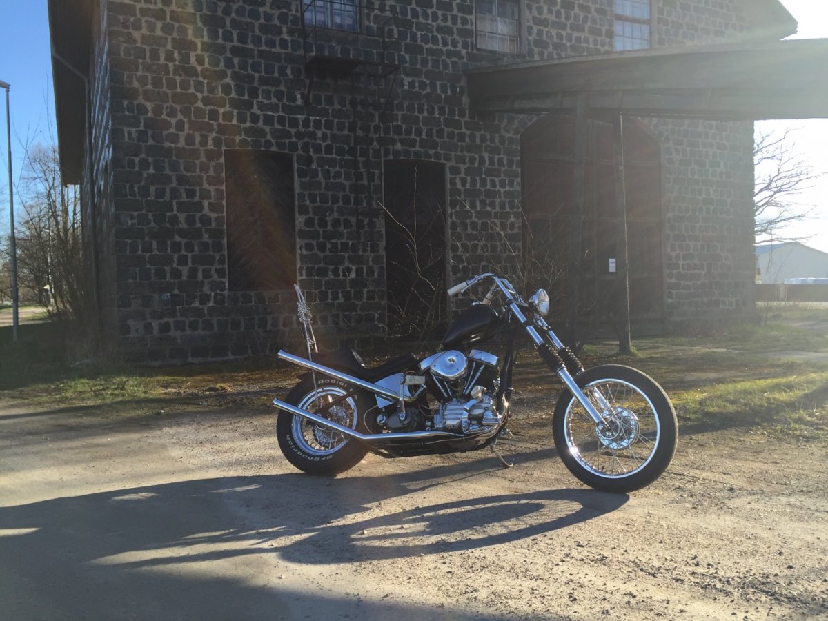

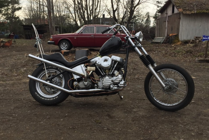

    Well, i did sell/trade the shoebox for a Harley Panhead that i have built this winter in a 60/70s chopper style. I know it is not maybe hamb friendly but i actually love old choppers and it was a great oppurtunity for me to get a Panhead so i could not say no. Planing on build another shoebox or maybe a Mercury but we expecting a little baby soon so time will tell [emoji6]
    The only old Ford i have now is the F1 and its great to haul bikes and so.
    Here is the Panhead as it looks now:

    Thats a clean looking Panhead you got there!
    Usually bikes built in 60's style looks like that owner has eaten wrong kind of mushrooms for breakfast:D

    Very nice panhead!You do good work sir.Is that an electric leg I see behind the trans?Antti except for the -68 type oil pump , electric starter and S&S carb(or air cleaner) that is a very typical early 60s chopper.I think I also see a 65 -69 timer with centrifugal advance. Later in the decade you started to get some really strange ****,but that is a proper motorcycle.Dlandberg if I were you I would either change the copper oil lines or if you must use them put a short piece of rubber hose on one end.If you use them with the flare fittings copper WILL break from vibration.I sat on the side of Nova road at 2 AM in march 1968 from that very thing.

    Thanks guys! That you see and think is a electric starter is the original ignition switch that i have relocated no electric starters on real choppers.... Trans and engine are matching -49 FL Panhead. S&S oil pump and carburator and the ignition is a mallory electronic ignition so not so right there.... And i have used cooper lines for oil on all my choppers i buildt and never had any problem i dont run flare fittings i run swagelock fittings and soft copper pipes never take any damage from vibrations.

    Kickstart only- good for you! I have seen so many of those aftermarket electric start setups mounted there that I made an ***umption.I had to look real hard after you told me to recognize the early ignition switch,dont think I ever saw one mounted there.Your 4 fin timing cover is in very nice condition,is it an original 54-64 style or one of the new aftermarket ones? BTW-what is a swagelock fitting? I have never heard that name.
