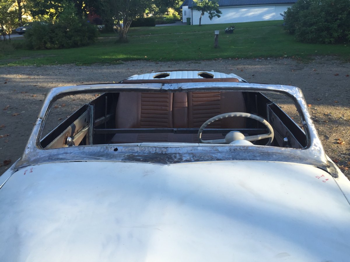

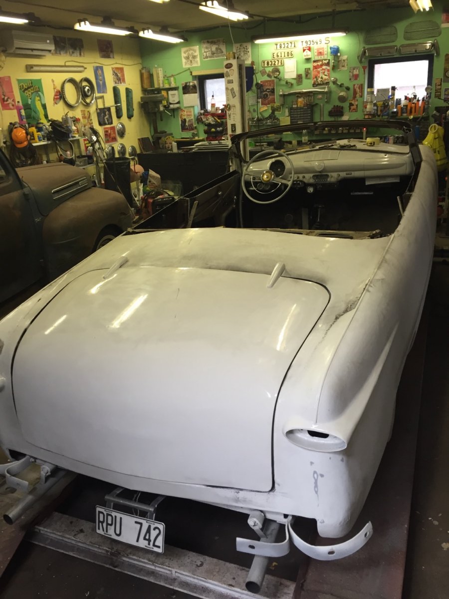

    Little update, have welded all day long, made a support bar between the rear wheelhouse that both stabilise the body and attetches to the catwalk area, made brackets on both sides where the carson top/convertible top is going to rest and made a lip on the catwalk.
    The first pictures is when i stretched out the body before i made the support some things did not line up so i welded a big twing to the catwalk and spread the body some.
    mad mikey, Rui, wizkid and 1 other person like this.

    Welded some more and made some templates to see if rear windows and the roof flow is ok.

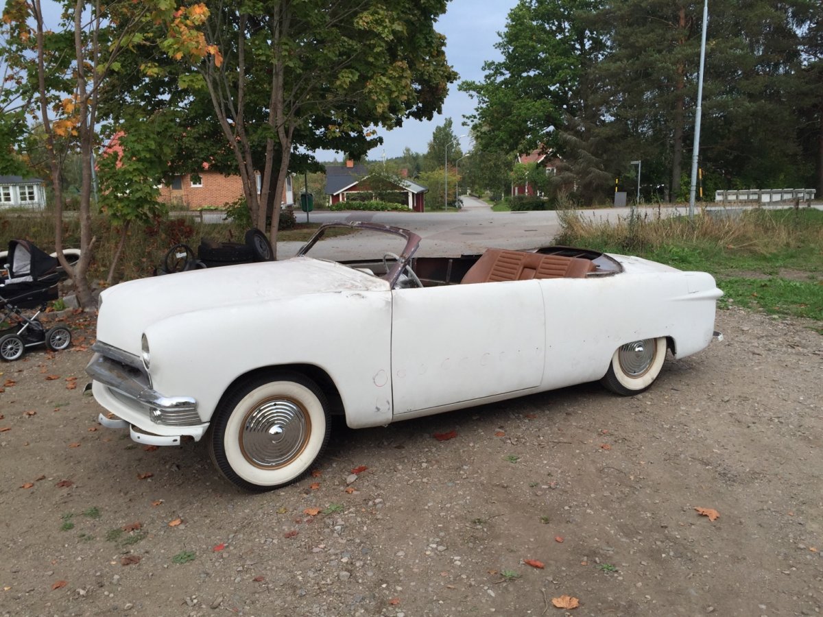

    Hard to find time to work on the shoebox with other bike and car projects and a new born daughter but did some today and took it outside to see the look and a little test drive to!

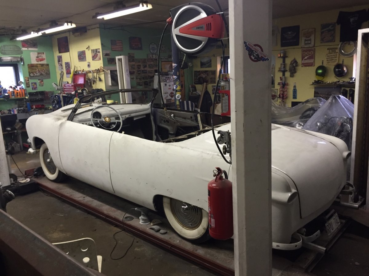

    And here are some pictures where i removed the templates and the last pic is my wife taking it for a testdrive.

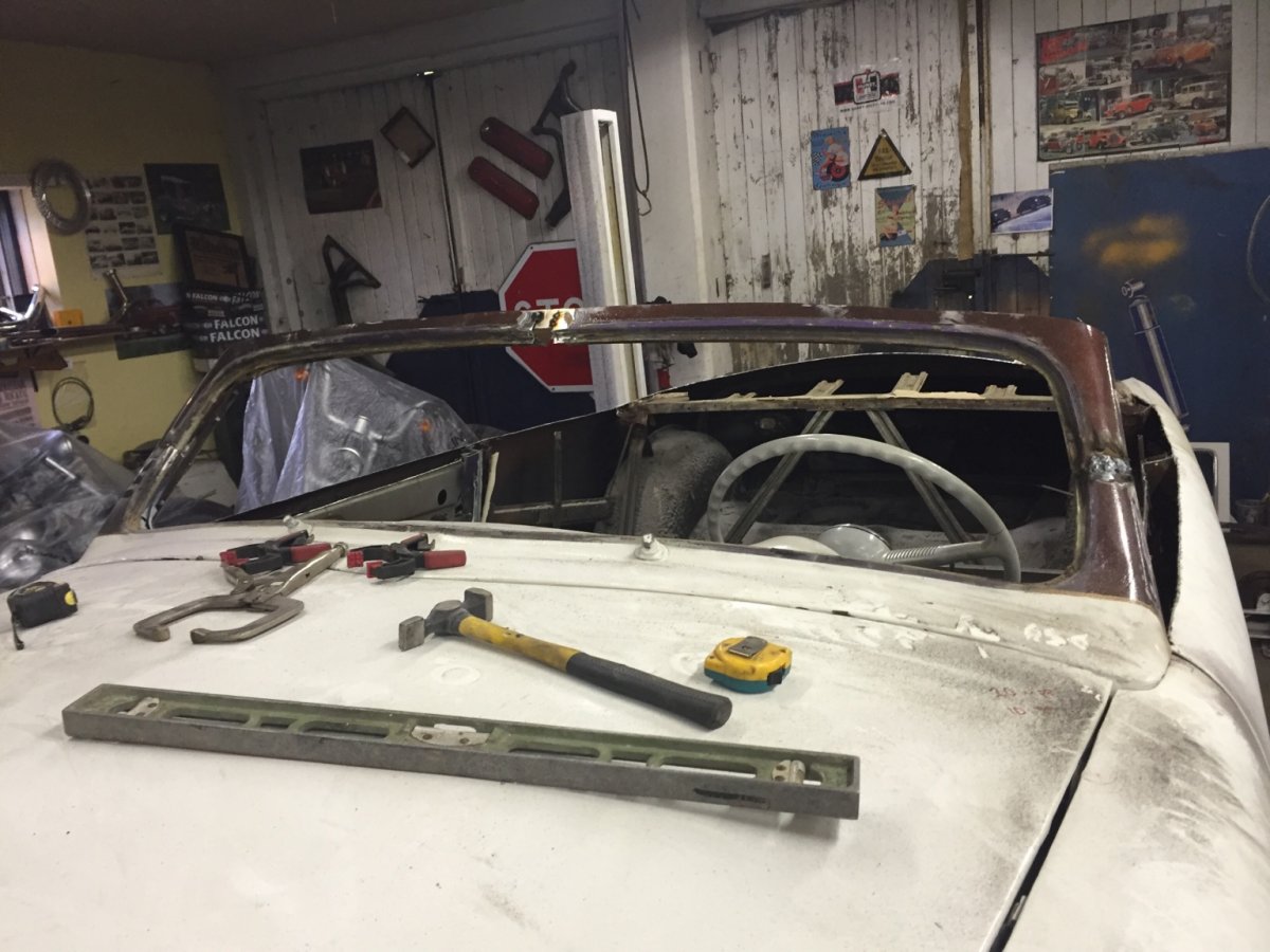

    image.jpeg image.jpeg image.jpeg image.jpeg image.jpeg image.jpeg This is the windshield frame of Octavio's Tudor turned vert that he and Rob Radcliffe have been building. Reshaping and squaring the A pillars makes a major difference in the end. I like what your doing!

    Thanks Eric for solid info and great pics of the window frame, i have been thinking of reshaping it, its only spot welded togheter now so i think i take it apart again looks better in the end like you said when the a pillars are leaning slight inwards. About the frame i think i will do more like a K on the frame and when i do a kickup on the rear frame i will weld it togheter in the top for added support too. The frames feels pretty strong when driving around a little with just my temporary support inside the body there is no flex in the body or movement now.

    Did stripp all paint on the window frame and did small relief cuts in the corners to get it a little tighter and welded up think the base shape is good, now i just got to get it to look like a convertible window frame....

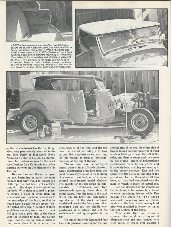

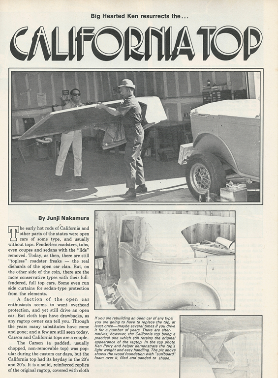

    Here is an article I did on Carson Tops back in the early days.
    You might like the ideas and build process.
