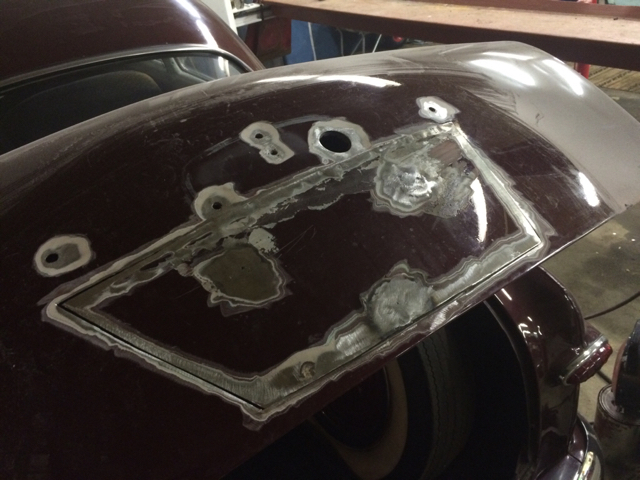

    Made some welding and straightened the plate that i cut out from the trunk lid today first i think i would make a new plate but the old one gets really good with some hammering and welding so it will be smooth when welding it back in place

    Finished the welding today on trunk lid and layed some modern lead :) sanding and surface painting it.

    Todays work was sanding baby smooth, gets really good! Next project is continuing on the hood and shave the trim and ornament before anything get any paint.

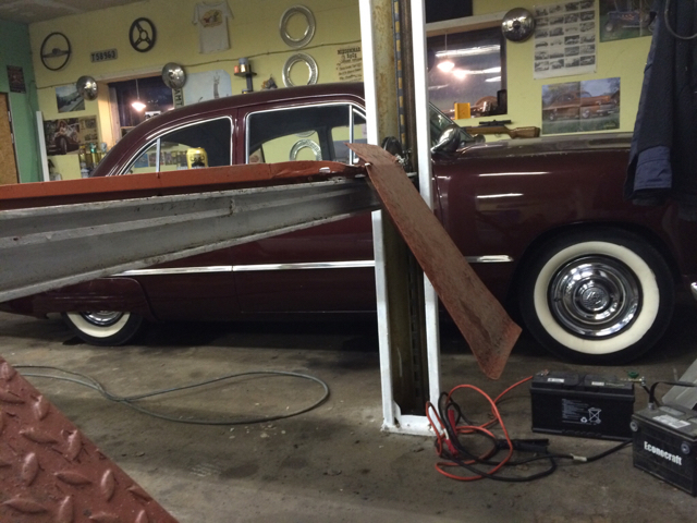

    Something happend today made a teardown to make roof chop :) i Said earlier that i would wait til next winter to chop but i will do it now still have time until the summer is here!

  26. woodbutcher
    Joined: Apr 25, 2012
    Posts: 3,309
    woodbutcher
    :D Shoebox is looking good.Slow and sure will get you there.Keep the updates coming.
