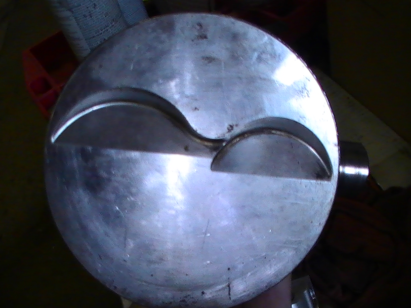

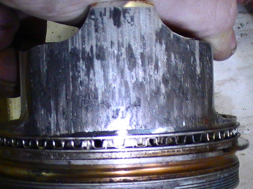

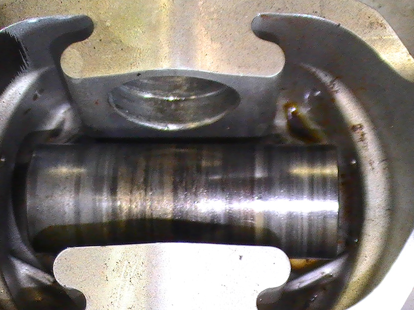

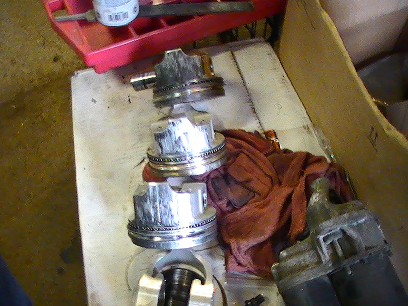

    Thought I would show what happened to an Injected Alcohol engine when it was severely overheated.
    This is actually the third time this has happened. The one piston pictured had the bushing eat into the piston as can be witnessed.

  9. 2x^, that was not a lean run condition but poor oil quality.
    I ran a 377 on alky for 5 years and never had a oil problem like you have. I ran kendall 50w.
    It is not a lean condition as the piston tops are not burned. Our 327 burned a piston due to a lean out but did not gall the piston skirts. (kendall oil)

    Bearings after the burn down could actually be used over if I wanted to use them. Crank and rods all mic. up fantastic. No problems with the cam and lifters. Is Kendall oil still available? Haven't seen it on any shelves in forever.
    The last time it did this was because of no coolant left in the system and the temp gauge went to 240 plus.
    I couldn't tell you the oil temps as I can't get them to put an oil temp gauge in the pan, and yes the pan is set up for it.
    I have made many suggestions but they only fall on deaf ears. I hate seeing engines I rebuild come back for things like this. The last time warped the driver side head .009. They have to run a spec head from Brodix.
    I know a lean condition will melt the center of a piston right down. Had a guy do that to me once in only 6 laps.
