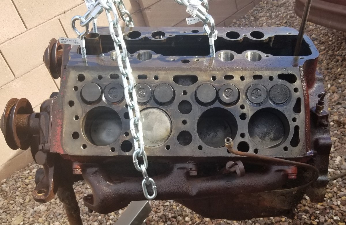

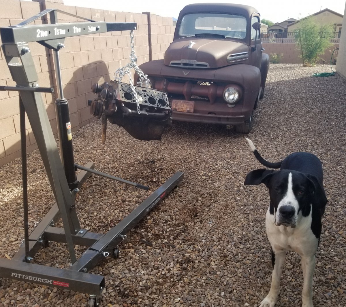

    20191206_140558.jpg 20191206_173853.jpg What I did today

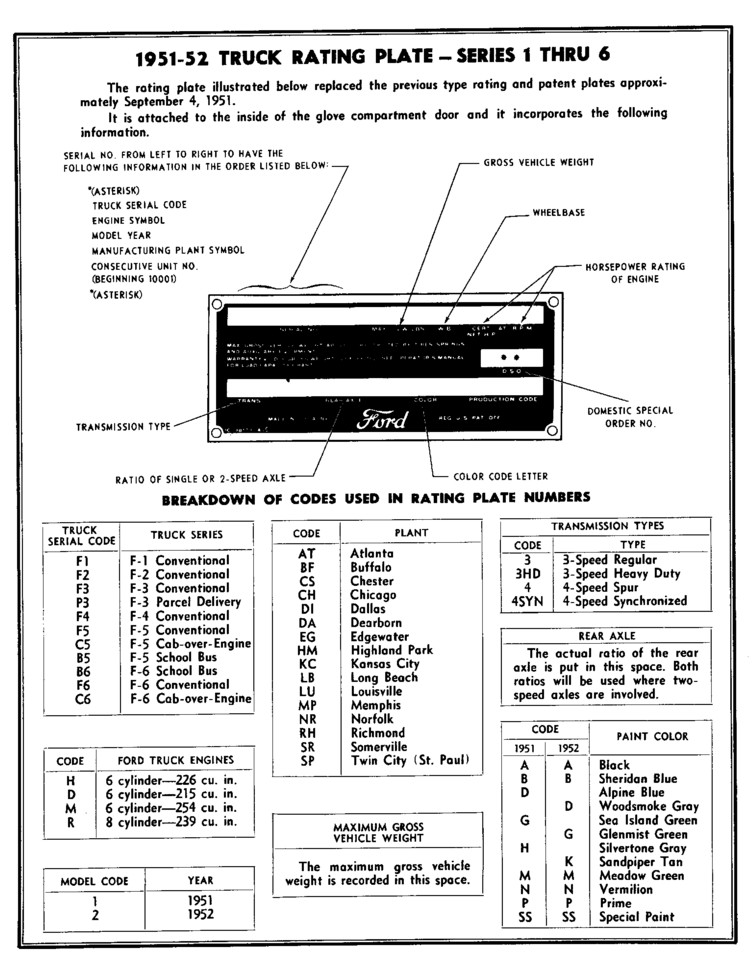

    Because VIN numbers were not standardized until the 80s. Most online readers are wanting 17 digits for that system, but your old Ford just used a serial number. Some identifying info can be decoded using that. Just going to have to search for your specific application. fh_vinchart_51-52trucks.jpg
