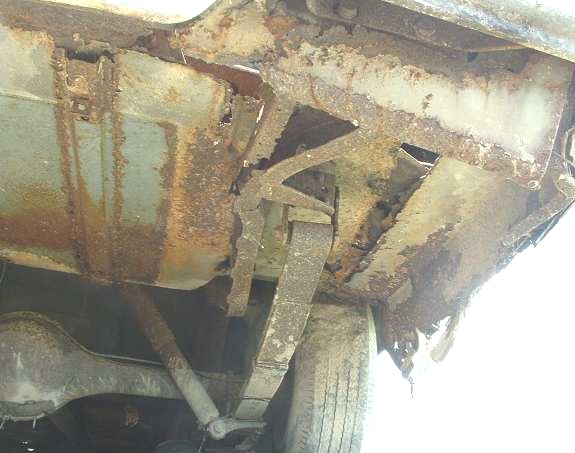

    The '57 Plymouth is one of the best looking '50's cars. The reason more aren't fixed-up is the rust problem. Have you checked out the frame? Many frames rust in two at the rear wheels. My parent's '57 Savoy is still out at the farm. The only way I would consider it would be with a late model frame swap. You could do a full channel in the process. I love those tail fins.

    Let's put it this way: the floors rust out leaving no frame structure and or body integrity. All unibody cars have stamped steel reinforcement panels at (at least) the suspension attachment points. Those old Plymouths had problems from the get-go. I can get you photos and more info later. I stand by my opinion that you will have a hard time finding one that a hot Hemi couldn't tear out the rear-end.

    Hmmm.. well I'll take a closer look and see if anything looks failure prone, like cracks in the frame rail, suspension mounting points, etc. and shore them up. I may actually do a frame swap if it's bad enough. Hard to get those torsion bars low enough with good suspension geometry anyway. [​IMG] But there goes the budget.

  21. Rand Man
    Joined: Aug 23, 2004
    Posts: 5,207
    Rand Man
    photo #1
  22. Rand Man
    Posts: 5,207
    Rand Man
    photo #2
  23. Rand Man
    Posts: 5,207
    Rand Man
    Yes these look extreme, but they are typical.
  24. Rand Man
    Posts: 5,207
    Rand Man
    I'm not puting down your project. The '57 Plymouth would make a way-cool custom car. You just have to find a good one. Maybe yours doesn't have the problem.

    The '57 Savoy 4dr Sedan is at my parent's farm about 100 miles from my house. I may be up there this weekend. These photos where of a '57 Belvedere that I copied from e-bay. I guarantee my rust is as bad or worse than this.

    LOL, no kidding. Those pictures are downright scary.
    If I have to throw a chassis under it, it will probably get (gasp) an S-10 setup. Cheap, plentiful, strong, holds a V8, discs, rack and pinion, etc and a huge aftermarket to lower it.
