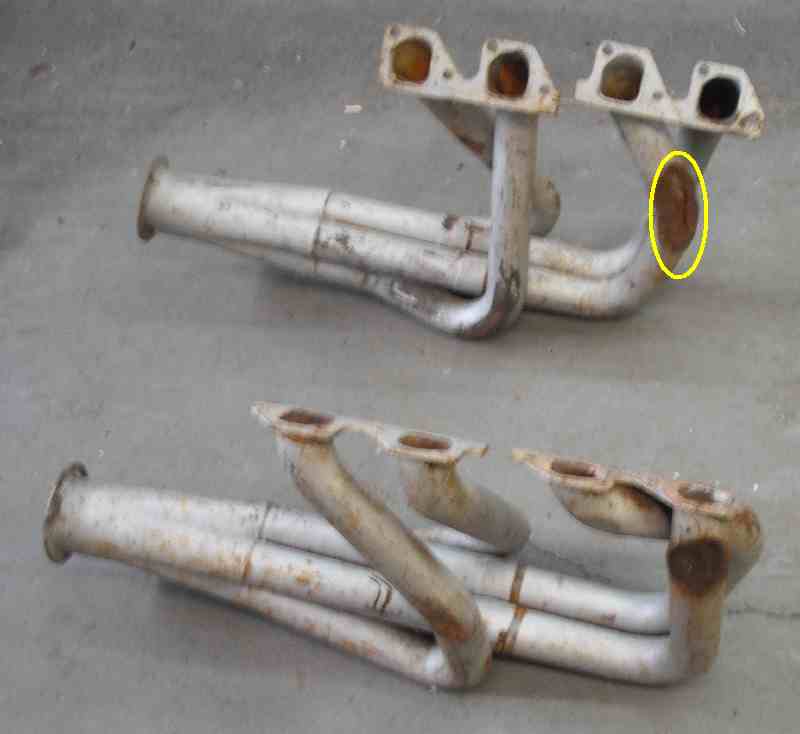

    Havent done anything since last week, left for Deuce days on Friday, leaving the country for five weeks tonight, no time left to work on cars. The last thing I did was pound the dents out of these...
    But I think I will have to replace about 6" of number 6, its pretty fugly...

    Mmmmm 4 BBL Cleveland

    yea, old timey solid lifter ford goodness...:) I got these used, pretty sure they are Kustom Headers PN#3305. The main companies that used the round 4 bolt collector flange were Douglas, JR and Kustom. The JR 1 7/8 Cleveland headers have a one and three split on the drivers side, and I don't hink Douglas made Cleveland headers, so process of elimination, I figure these are the Kustom pipes.
    4v Cleveland is going in my '67 falcon coupe. These were on a '65 with un-notched shock towers, they aren't designed for the early engine bay, but instead of notching the towers, he just hammered the ever-loving **** out of them.:mad: Other than that, they are in pretty good shape for 40 yr old headers.

    My friend would have bondoed them up, painted and sold at swap meet....Its a wonder that nobody came looking for him..

    Its funny, I didnt really set out to be, I am ending up with a vintage header collection.:D It started with a cherry set of Doug Thorley fenderwell headers for my chevy II, then I got a drivers side Belond for my olds, and now these.

    117harv's comment on the "how to participate in a thread" thread inspired me to re-visit this. I tend to take it for granted that everyone knows how to do basic stuff. Heres how I pound dents out of header tubes from the inside. I take the box end of a combination wrench that is just a little larger than the id of the collapsed area of the tube, push it down the tube to the inside of the dented area, and pound it past the dent with a hammer. Then I just move up to the next larger wrench size, until I get the dented area back to its original id. If the area is really hammered, I will used a little heat witha rosebud tip to help it along.
    If the area is way down the tube in an area I cant access, then I use a steel ball the size of the tube id with a hole drilled in it, p*** a cable through the hole, and weld a washer on the end of the cable. Then I feed the cable down the header tube until the ball comes up against the dent, heat the dent with a rosebud, and yank the ball past the dent by attaching the free end of the cable to a slide hammer.
