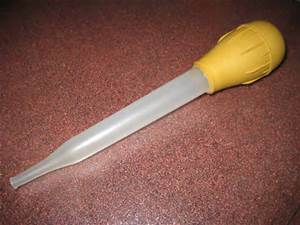

  2. Since we're on the subject of turkey, :D I've used turkey basters many times to evacuate fluids like from master cylinders, ps reservoirs, etc. th.jpg

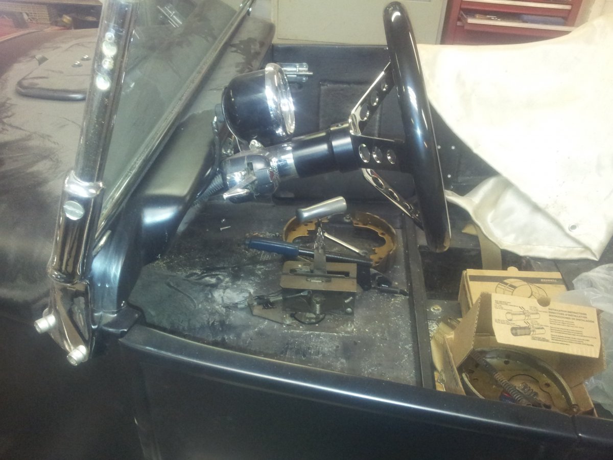

    I've used those pop in hole covers you get at an Electrical supply house before...but I think thats pretty common.
    Needed a steering wheel mount to fit the steering column I made last year.
    Used a 3/4" keyed shaft "weld in hub" meant to be welded into a chain sprocket for agricultural use...which in itself puzzles me...but it worked slick. Welded a piece of exhaust tube (a touch bigger than the column tube) to the rear to hide the bearing and drilled/tapped 3 holes for the wheel to bolt up.
    The key itself extends from the bearing retainer to the end of the shaft and I drilled and tapped the shaft for a 3/8th bolt and washer to make sure the assembly could never loosen and slide off.

  28. That's pretty slick! HRP

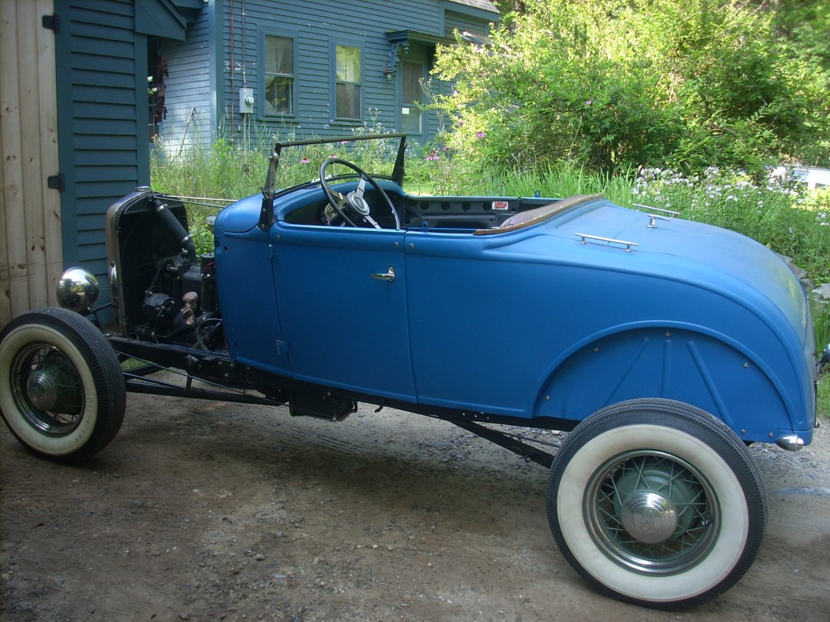

    Covered the side curtain mounting holes on my roadster with push -in stainless "plugs" I found in the plumbing section of the hardware store. Nice and neat.
    (Hard to see- 2 on the door, 1 behind.)
