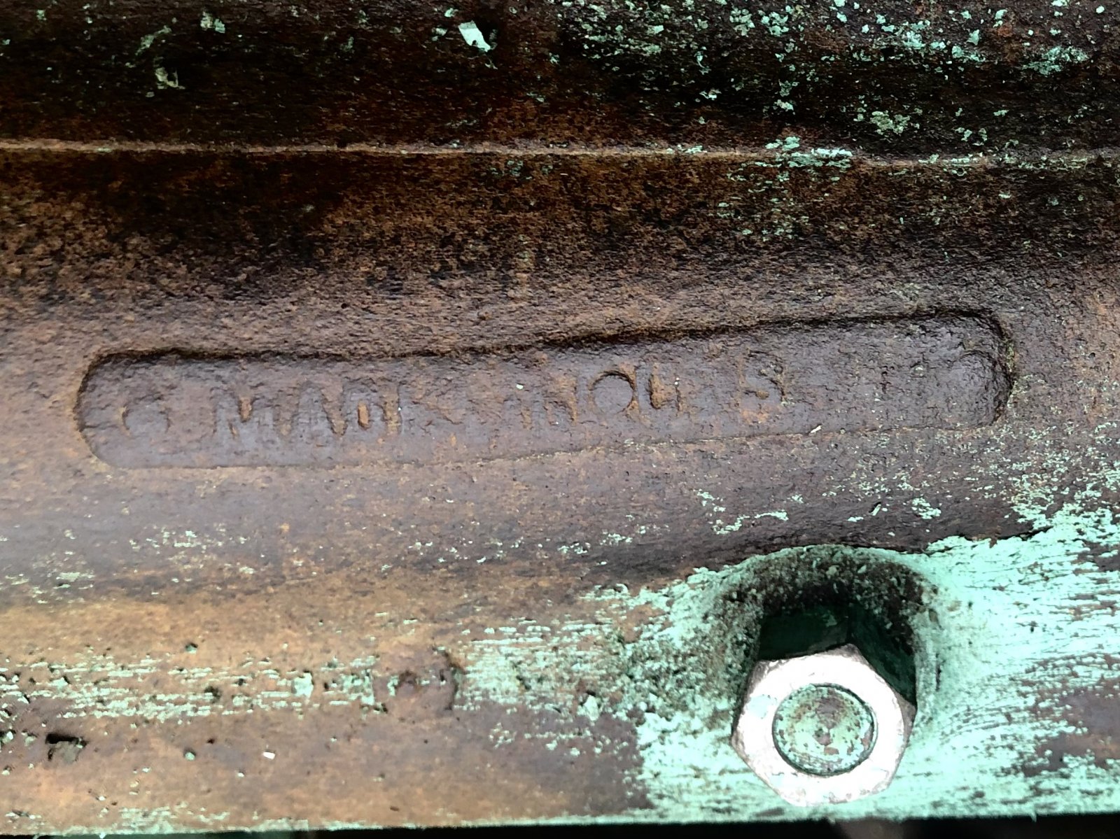

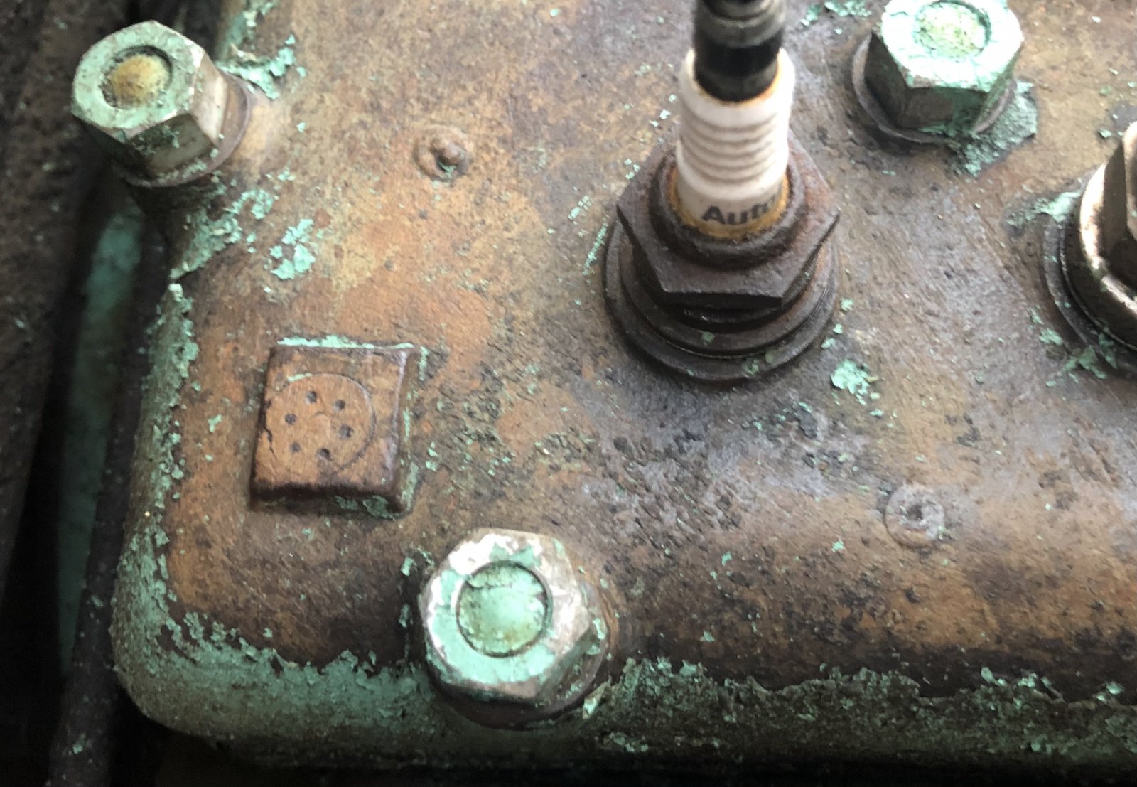

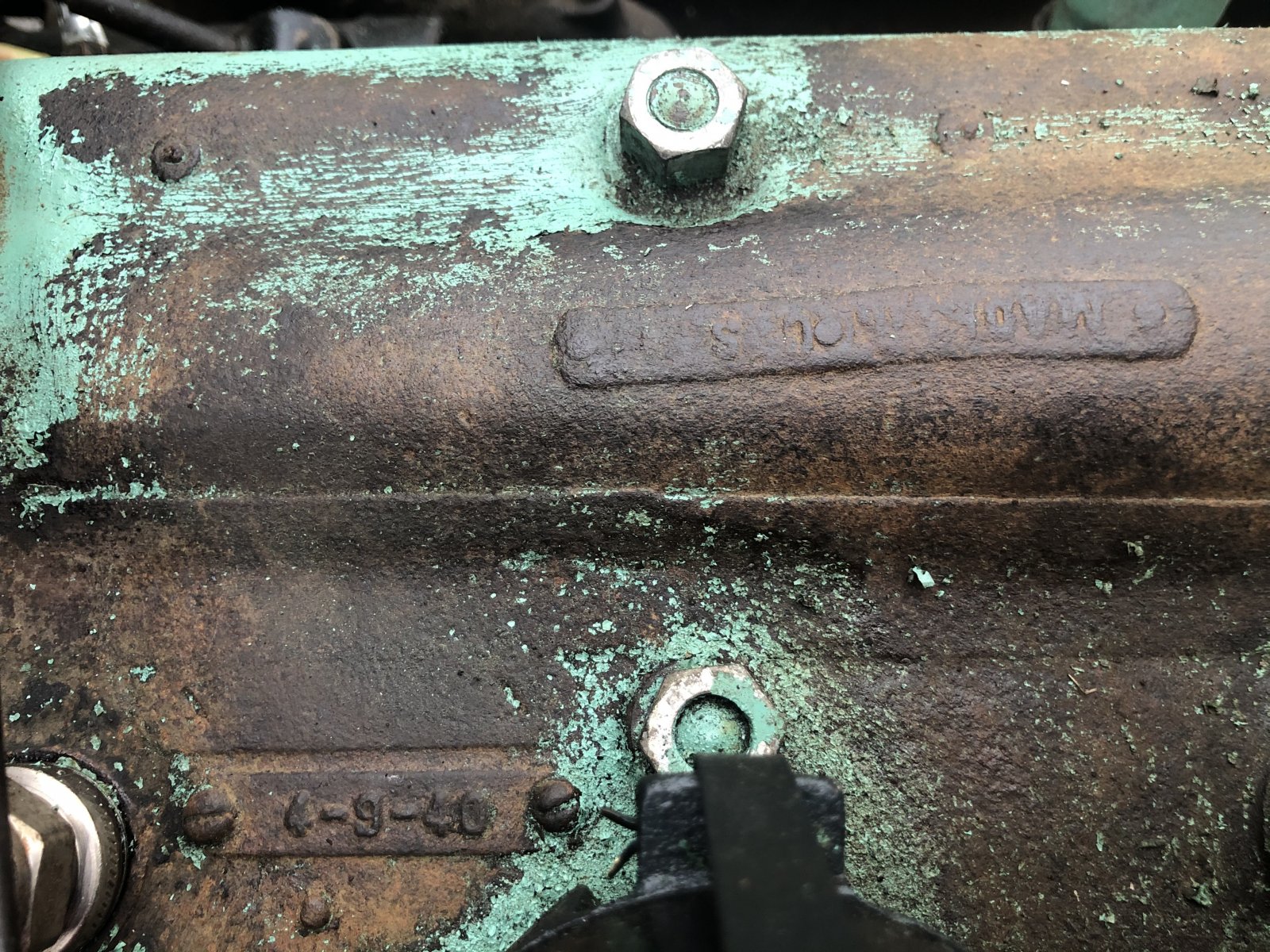

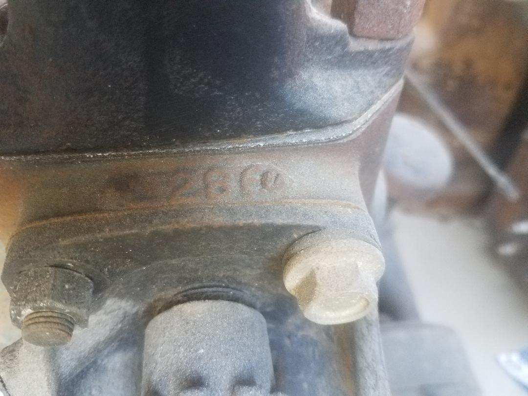

    This head is on a 1929 dated Model A banger motor. It looks different from the others I’ve seen? Anyone recognize this?

    could be early aftermarket, maybe higher compression, or different combustion chamber design. Try here at the ford garage http://www.fordgarage.com/

    As far as the German theory goes, I believe it is stamped ”Made In USA”.

    Model A heads were made by contract foundries for years after production ceased.they were sold by Ford,who mandated the made in USA casting mark.The date code is correct on yours,I have B heads that date to 1944...and generally the quality of the post production outside foundry stuff was better than the rouge stuff,which is why the 'diamond' B block is in high demand.

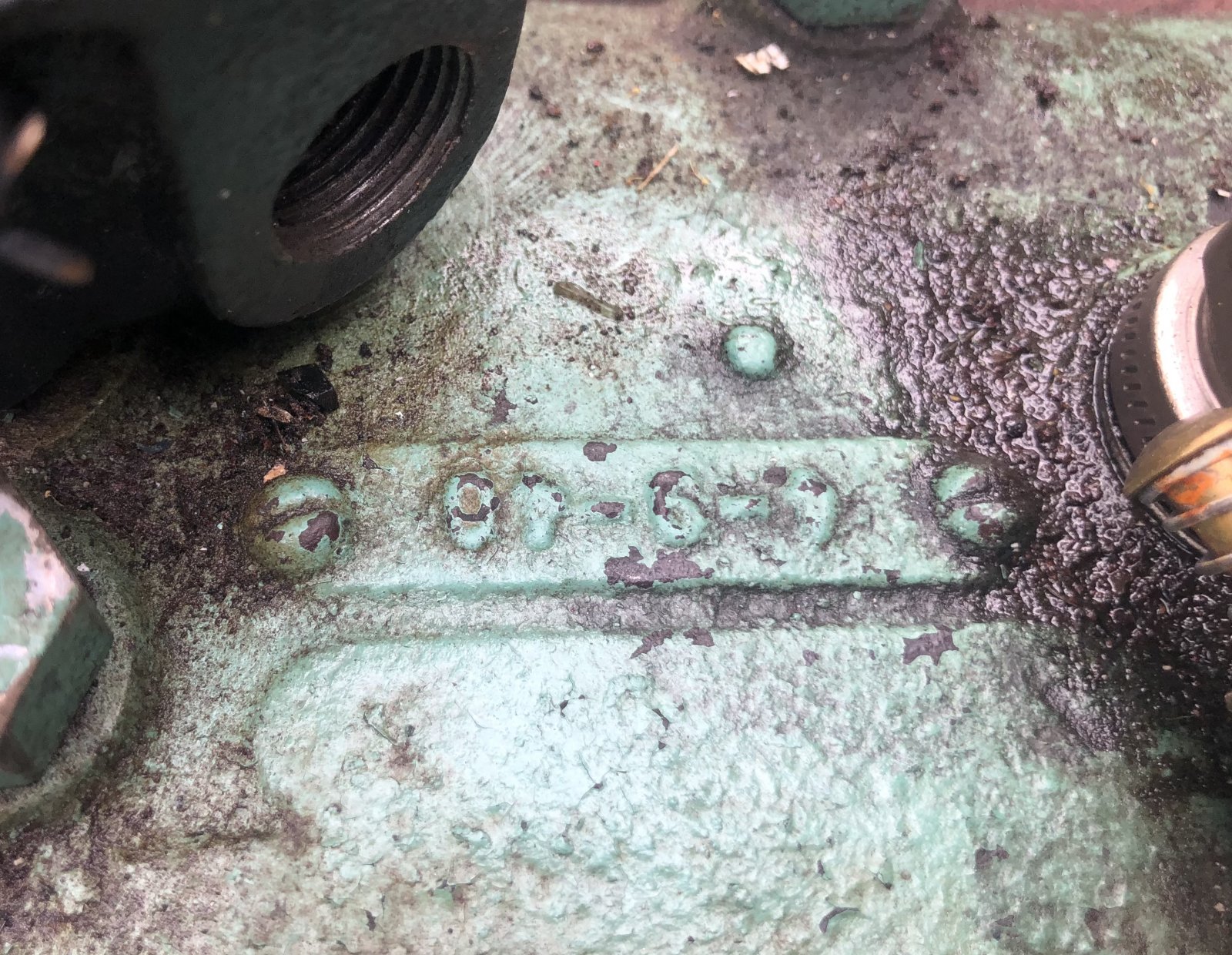

    This one is a November 28th 1936 A head..its a beauty next to a production head

    Saw this head at Hershey. Has the same markings as mine. Date was 38. The guy didn’t know anything about it. CCDB3A04-757F-4A5E-ACEA-D323EA981A9D.jpeg
