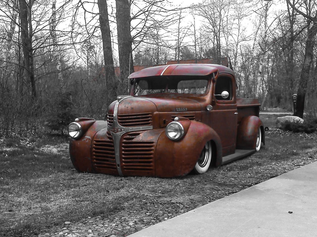

    Can any of you identify which year and make headlights these are? Thanks in advance

    41 - 46 Chevy truck.

    As said above Chevy truck. 46-7 probably a few more years .

    Actually ‘42-‘46. The ‘41 Chevy and GMC trucks used a parking light cover ***embly borrowed from the 1940 Pontiac cars.

    I'll split the difference with you. Actually/specifically it's '42 - '47. The 41 Pontiac parking light ***embly also went into early 42 and the late 42 and 46 parking light went into early 47.

    Those years Dodges have a bad rust problems in the headlight buckets. So, the Chevy lights fixed the ugly and the rust

    So fitting these things, the curve is a bit different, as i figured, but not terrible. I've never done anything with metal of like this, as far as making 2 different radiuses fit nicely. I'm thinking
    Cut a hole about 1/2" smaller than the GMC headlight ***embly. Hammer/dolly a nice curved inward until I get the fit I want. (rolled in) GMC ***embly should rest nicely on top. weld new bracketry on bottom of fender. bolt up and wire.
    Am I way off?
