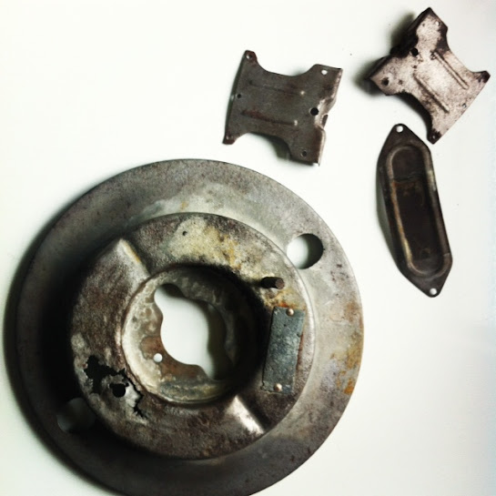

    this is the rest of the parts and what I can make out of the tag...looks like the number 45....other than that the rest is pretty hard to even figure out

    if that tag above was legible it would have the date on it. if it turned out that was a 1945 I'd be suprised.
