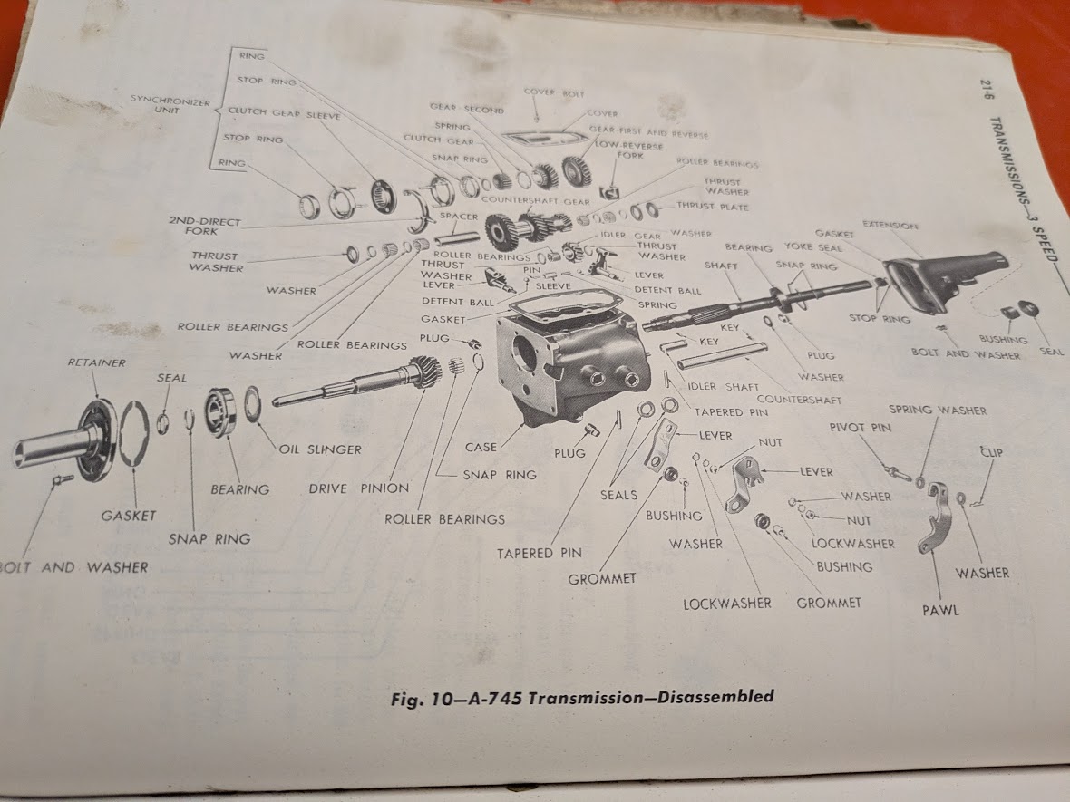

    it's a Dodge!
    this is the 1966 version, after they got rid of the drum parking brake in the early 60s.
    Notice it has no low gear synchro. My wife had one like that in her 70 Dart, one of the very last non-synchro 3 speeds offered.
