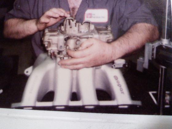

Here's a prototype I worked on in '01??? That's "yours truly" in the picture... I brought in one of my Holley carbs to check the bolt pattern..

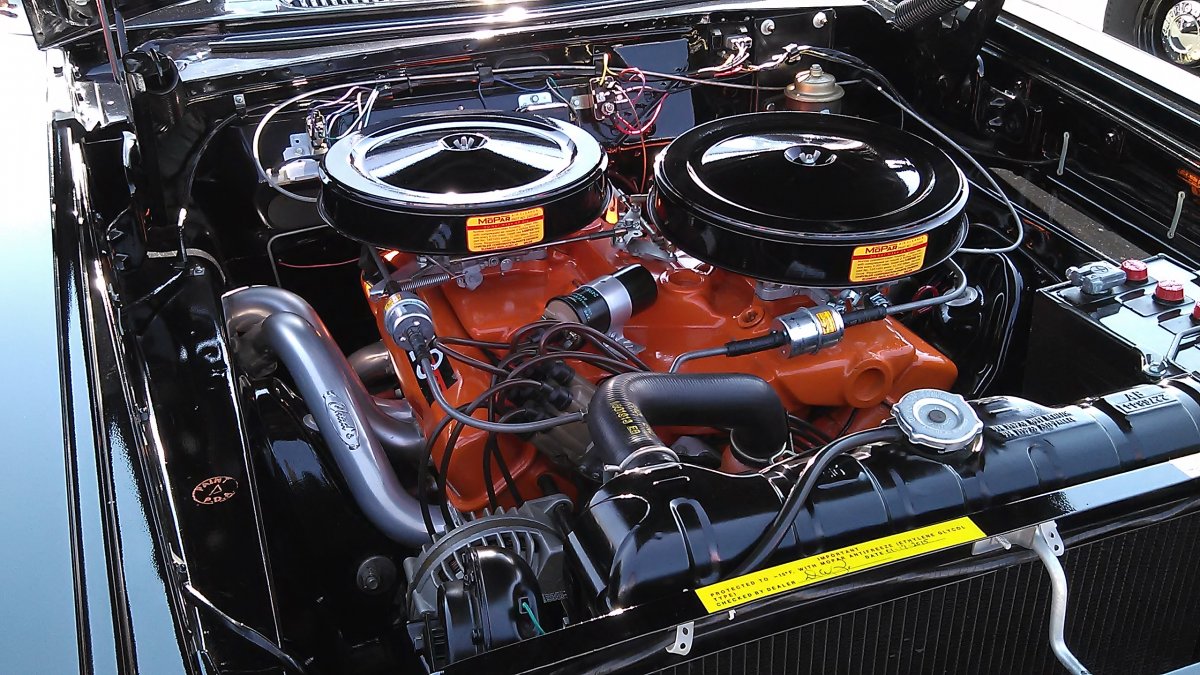

guys its easy to get dollar signs in your eyes over a 426. unless it has on the id pad in real big letters mp 426 its just a street wedge. the max wedge blocks also had a 1/2 inch oil pick up tube. they came with a deeper pan that had a special shape in the front to clear the k-frame. special rods and cranks were also used.deep groove pullies were part of the package also.3447 carbs for 62 and 63 3705 for 64 the rear ends 8 3/4 were more narrow than regular rears. there was also two different compression ratios available this was done with the pistons. all cams were 3-bolt. iron upswept headers were also on these monsters. other little known parts like the water pump and balancer were also different. all these parts have part or casting numbers on them. so if this engine does not have all these parts it may just be a street engine with heads and a manifold thrown on. if that is the case the price just went way down. its rare to find one all intact. to find these parts separate is very costly. most people see the intake and heads and wrongly ***ume they have a max wedge. sure 440 parts interchange but its the real deal that brings the real cash.
I was givin a (426 st/max wedge) 2532**x-2 #'s are ground off the block..Why don't know..Has a 1/2 pickup tube..And the rods look bigger than a 440..very rusty so will take some time till I get at the rods..Date 0n the block is 9-21-64 a 7R on the p-side front of the block and a R3 on the back d-side..And 5..5 stagered on the top ID block..This thing has been sitting for 30+ years..Any help would be great..Thanks and is there any were else the #'s are stamped
It's funny you mention your block has last bit of numbers ground off...my 64 block has them ground flat also. And has factory paint down in ground down areas so looks done at factory. Have had a few older guys say sometimes if they dealer replaced engines they'd grind off numbers to show was replaced (original engine). Who knows?
I have a street wedge block sitting in my shop..Easy tell is if it has reliefs notched into the cylinders..thats a max wedge thing and not done on the street wedge. Date will be casted on the side of the block and raised pad will be stamped. AAQA has been casted on the front of every 413/426 wedge I have ever seen..max wedge or street wedge..My block is a casting date of 1963 and the pad is stamped V for 64. Street wedge is turquoise and Max wedge is orange. Street wedge will have chrome valve covers and a large unsilenced chrome air cleaner for the single 4bbl. A 440 will not have the AAQA on the front of the block..
