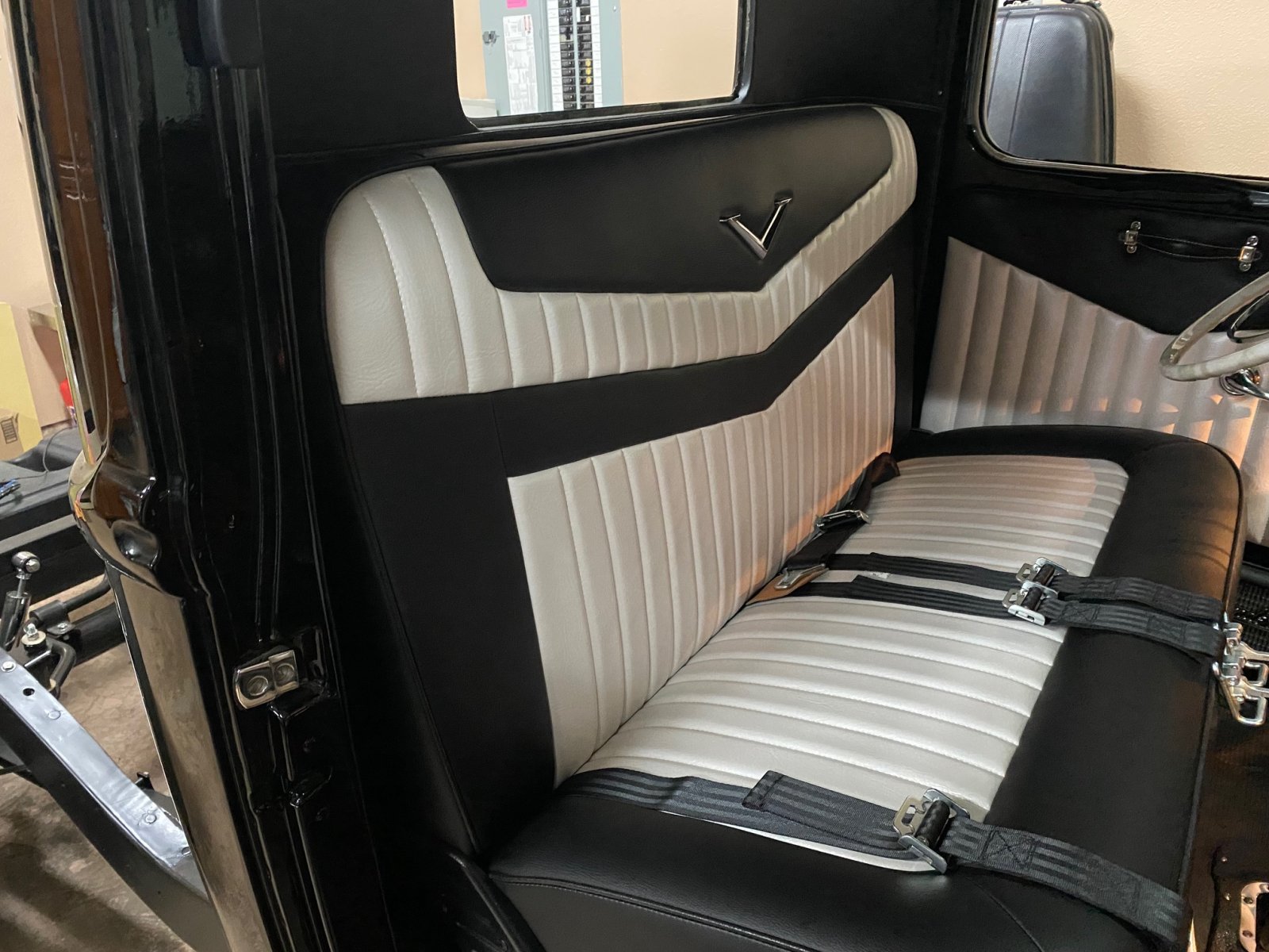

    This is a Glide seat in my 41 Ford pickup. Very comfortable

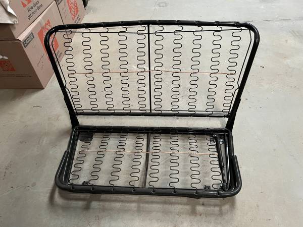

    When I had my '40 Ford big truck I used a seat from a Chrysler mini van. Think it was the second row but might have been the 3rd row. Fit ok but not all that comfortable. The stock seat in my '39 was OK but I finally bit the bullet and sprung for a Glide. Bought it at LARS and got the show discount. Not cheap but no shipping since they are just down the freeway. If you do go that route, my upholstery guy wanted to use his own foam not Glide's. Came out really nice.

    Build one from scratch. Plywood and shaped foam covered by some good quality vinyl or leather. Work with the upholstery shop to fit your contour. I have a seat like that in the deuce pickup and it's very comfortable. Also cheaper.

    And that is the key on these truck seats, thin backs. We cut the foam down quite a bit to achieve a skinny seat back, left he bottom foam full for comfort.
