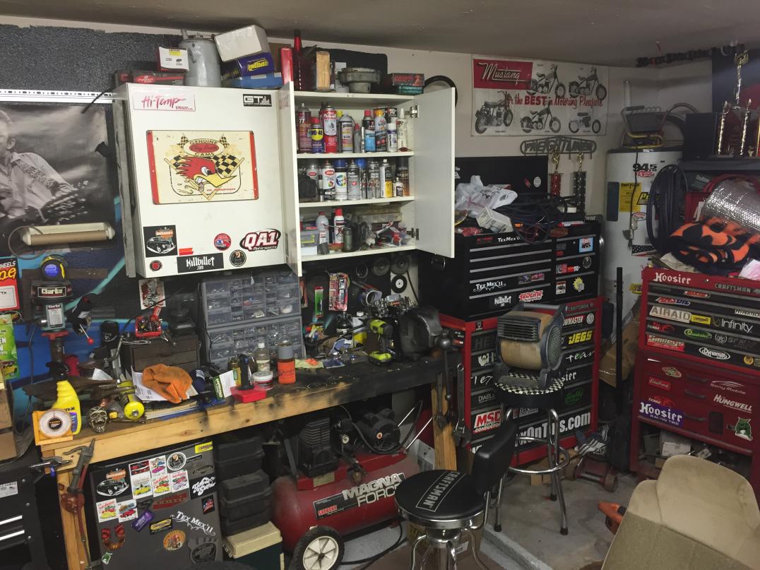

    This old compressor was a a gift from Dad back in the day and it managed to offer air to cover a few cars and plenty of air tools in it's service. You have my vote, go for it.

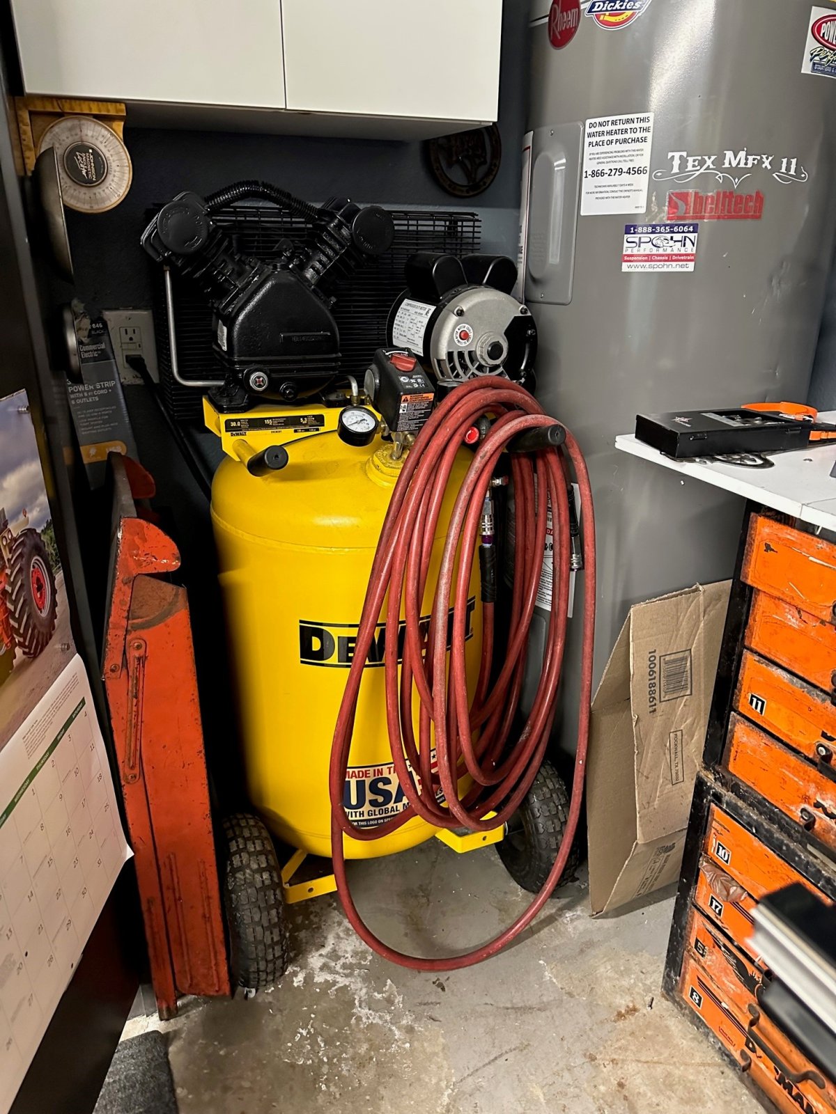

    Ive painted a **** ton on a horizontal 20 gallon. Normally you could spray a complete panel and move and reposition and let the air catch back up, HVLP is low enough pressure as long as your able to provide the scfm it should be ok. I battle the condensation with 2 oversized decadent driers, this keeps the air clean and clear going to the gun. With larger driers even with warmer air you should be ok.
    I upgraded compressors after years to a 30 gallon Dewalt 2 stage and its been wonderful.
    Old sandborn worked many years for my grandfather and then myself. Still ran fine till I upgraded... If you have the room for a 40 and the electrical supply then I say do it, if you are 110v limited and budget limited I would say this dewalt is a good bang for the buck at tractor supply. If you want to go full tilt and get the best out there, Id go Quincy then.

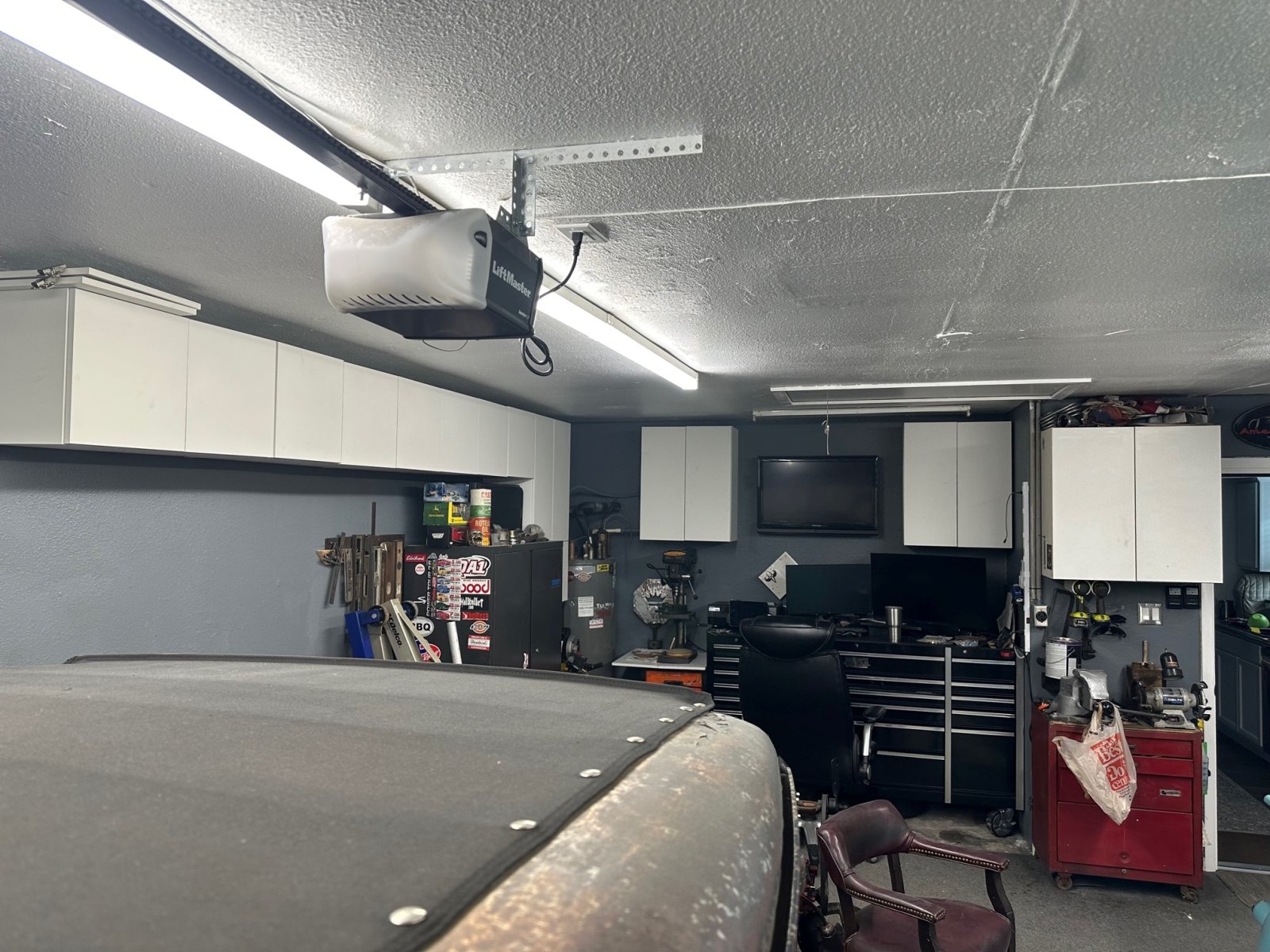

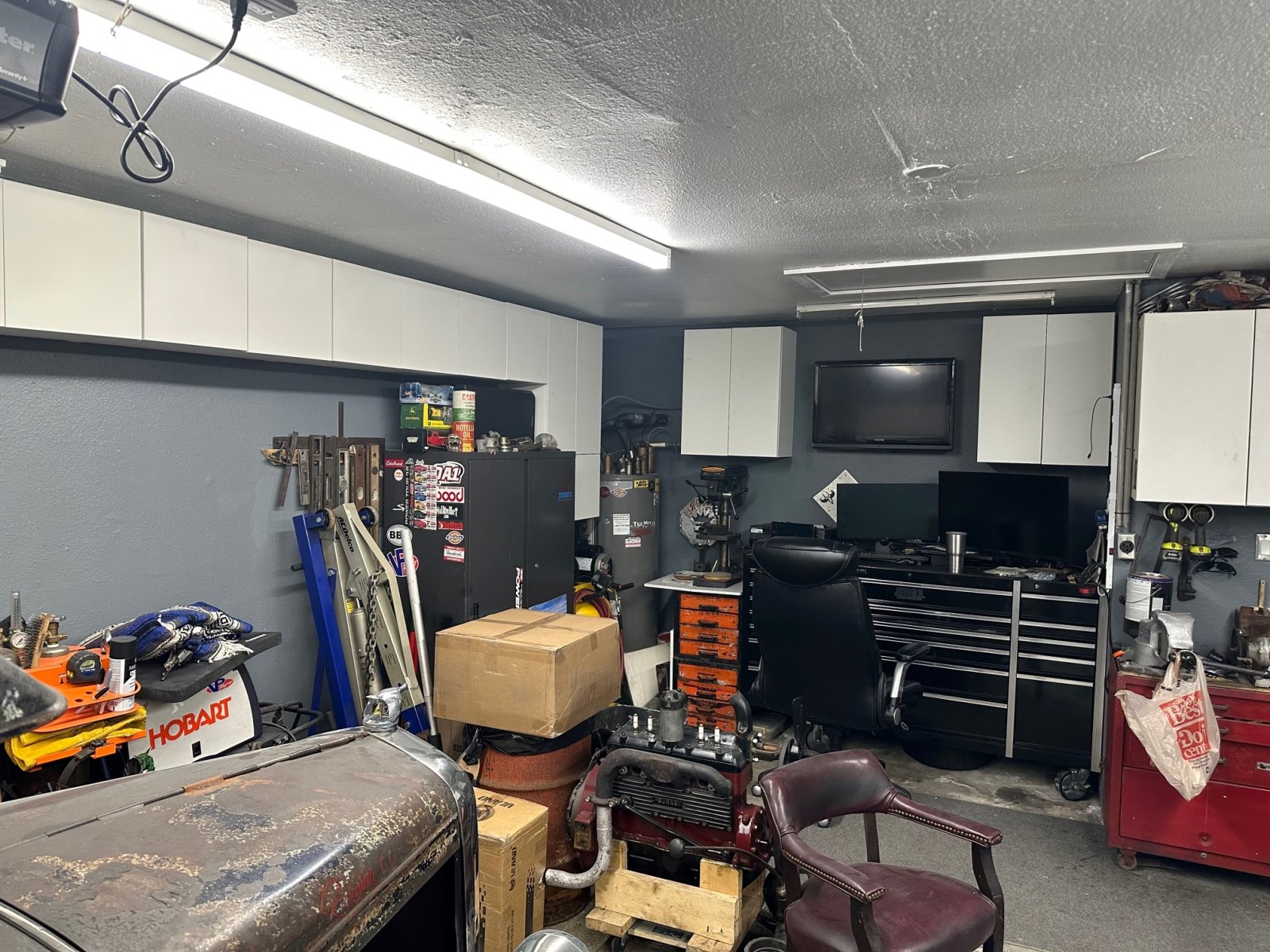

    Here is the new garage layout and compressor.
