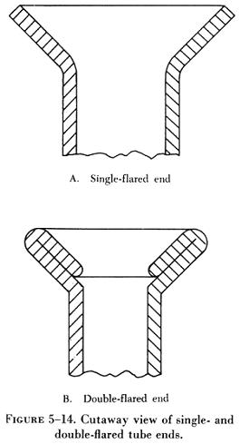

    There are three flares. ***uming this is for your 1953 Pontiac, it is safe to ***ume that it isn't the bubble flare. That means it is either single or double flare:

    ALL Brake lines on older American cars are double flare.
    Single flare is used for plumbing, in houses and such.
    Bubble flare is for the most part used on foreign cars in earlier applications. I understand some American cars are using this stuff now but never on earlier applications.
