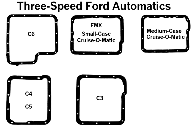

    Thanks for replying, I don't have the chance to post pics today sorry, I did take a look at it and found this out
    1. 2pc unit,tail housing an main body
    2. 14 pan bolt pattern like the med case c.o.m but the shape of the pan doesn't match
    3. # C2OP-7006-D on the main body
    4. C2OP-404-D on the tail
    5. found a tag (covered in grease) PCNB 221 2K19C4 seen C4 here an thought ok thats it but pan bolts don't match up
    I tried searching these numbers and didn't find anything conclusive
    6. the fill tube connects to the case just above where pan bolts on.
    Thanks

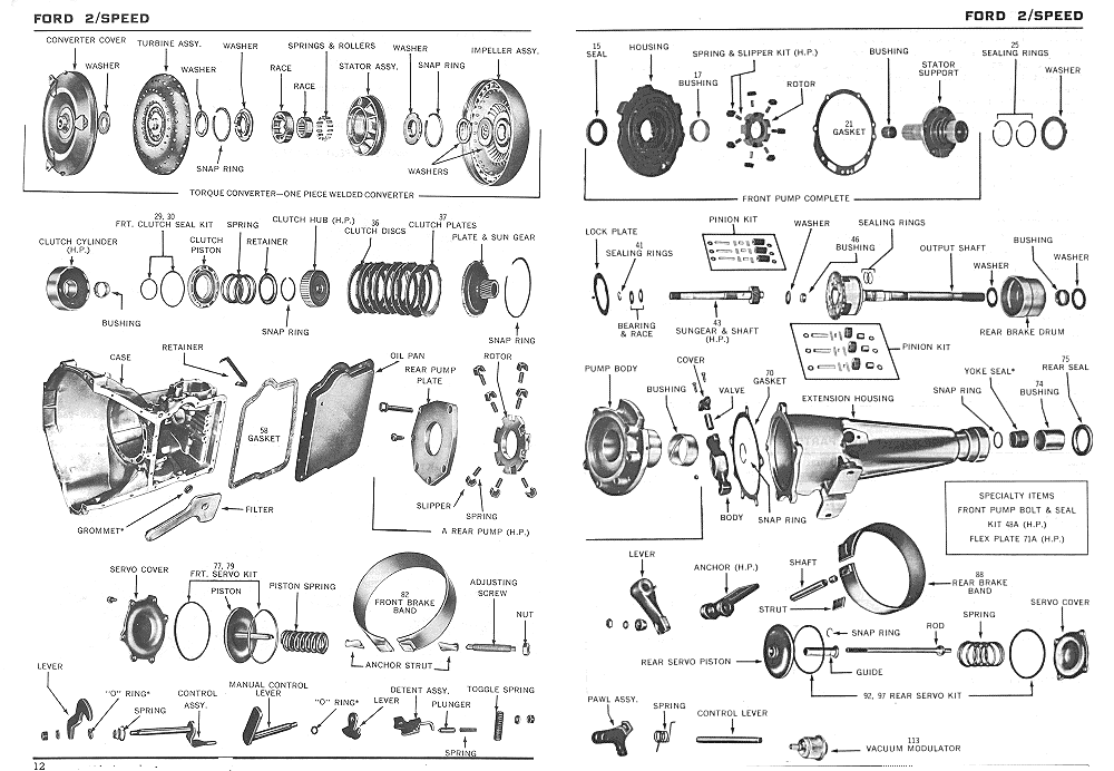

  5. The C2 casting number could be a clue, as in maybe it came from a 221 and it could be a 2 speed fordomatic. Same 5 bolt pattern as 260, early 289.
  6. squirrel
    Joined: Sep 23, 2004
    Posts: 59,186
    squirrel
    that's my guess, Ford O Matic 2 speed. Aluminum main case with integral bellhousing, removable tail housing, looks like this when you take it apart

    Thanks Choffman41,it is the 2peed fordomatic I found some pics of it on line and everything looks the same.

    thanks for the input but with help from others it is the FM2 trans, at first I thought it was the C4 because of the 14 bolt pan but the shape is different,I wish it was the C4 instead,oh well some one somewhere will want it.
