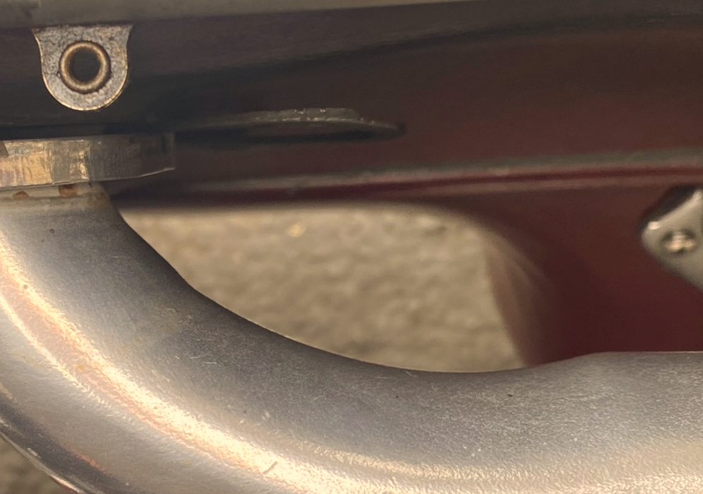

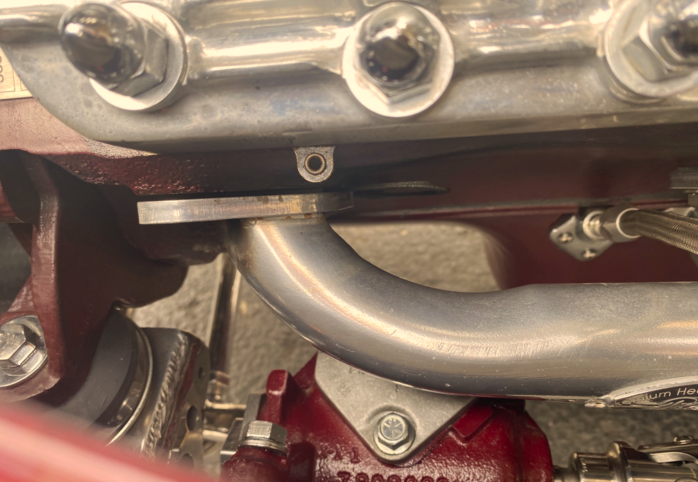

    I jumped in the roadster and drove up to get a haircut this morning and I noticed an odd backfire between gears on the left side. Then I noticed on my way to work that the car under heavy acceleration sounded funky, like an old lady walking on a foggy pier p***ing gas, again driver's side. I pulled into work and saw this
    No bolts, no gasket on the front header flange. I remember at least one of those bolts is 3/8 x 16, they both may be. The others are 7/16 x 14. Can anyone confirm that so I can buy a couple of SS bolts and locks on my way home?
    I just noticed when enlarging that picture, I think the gasket is still hanging there. It needs to cool off a bit before I go check. That would help.

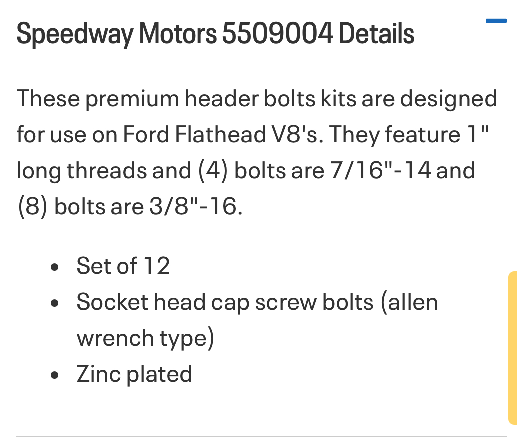

    This is according to the Speedway catalog

    That is what I recall. I think the 3/8 bolts go on the leading flange and the smaller ones on the back tubes. My buddy Kim had the day off and he is on his way to my office with a gasket, bolts and wrenches. Flathead buddies got to stick together.

    The front bolts on both sides are 7/16"-14.

    This is correct. 7/16-14 threads on front exh port bolts. 3/8 feel like they fit but fall out later....;)

    Well I got the top bolt in and a gasket. I cannot get the bottom bolt to start. I likely need to loosen all of the header bolts on that side and kick it around to get the bolt started than snug them all back down. I tightened the top bolt so it has a gasket for the trip home. Then it is up onto the lift for a proper repair.

    I took it to another show tonight after work and the one bolt is holding for now. I have another show in the AM, then I will get it up on the lift and get those bolts back in. I need to loosen all of them I think to find the happy spot on that front bottom bolt.
    The gasket was indeed hanging on the block so that was cool. My buddy Kim had a copper gasket that slid in, I couldn't fit the one that fell out. I will take that copper one out tomorrow and put mine back. Old cars... drive 'em, bust 'em, fix 'em, repeat as necessary.
