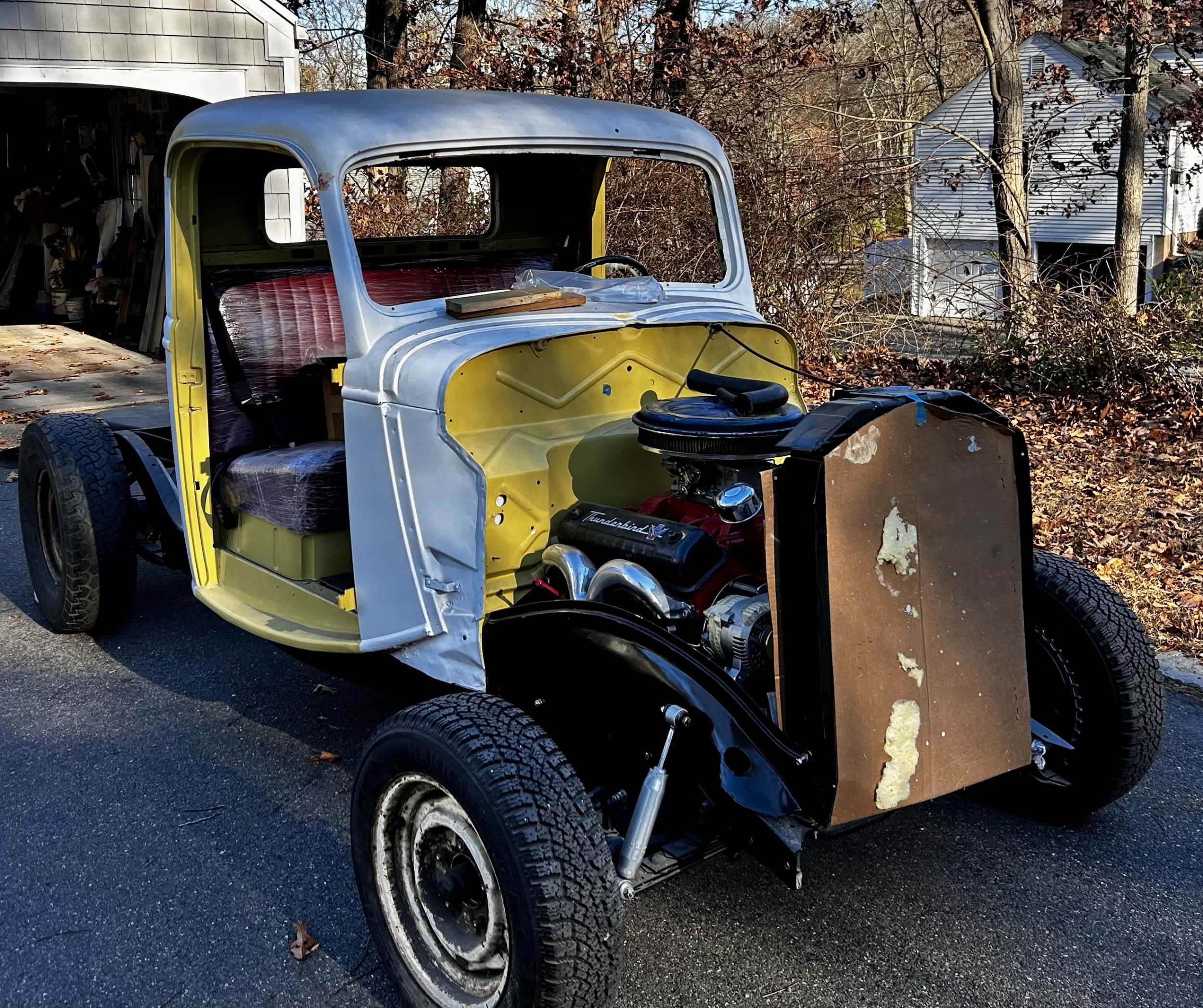

    IMG_3987.jpeg I installed a 292 into my ‘35 pickup project. Whole lotta work for a novice like me. Taking me a long time. Some quick points:
    Made motor mounts engine a bit off center towards p***enger side. Totally removed existing ch***is x center piece and fabbed up a new transmission mount lower and upper cover to emulate what was removed. I cut the firewall such that the distributor could clear it. Thankfully, I had a section from another firewall to graft in. I’m using a F100/150 3 + 1 ******.
    As I said, a lot of work and time spent just looking at it to figure out how to get it done. To make things a bit easier I’m using ram horn exhausts from a ford COE truck of similar vintage.
    Iirc, you will want a truck oil pan.

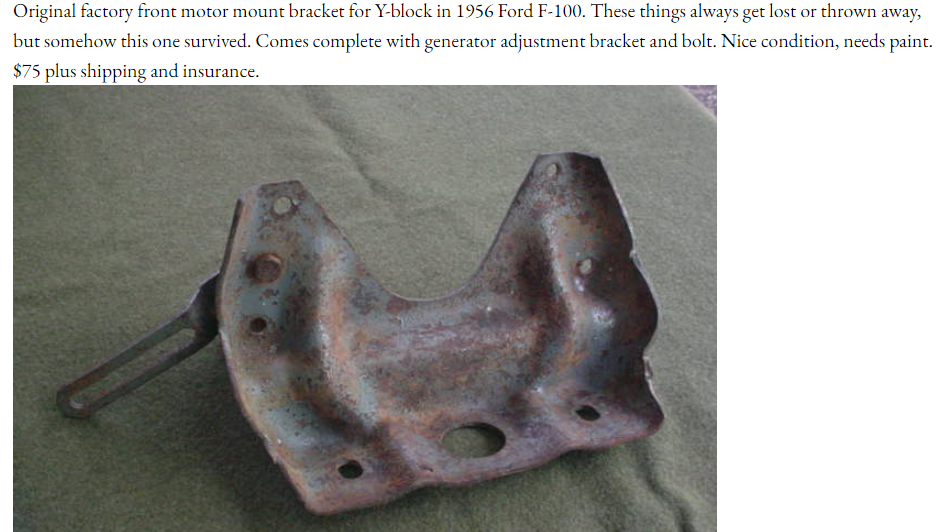

    From an old HAMB ad. '56 F100 front mount. Should open up a lot of room on the sides. If you decide to go this route, I've got one I'll give you.
