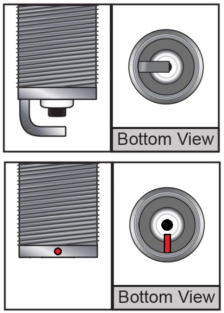

    He mentioned he had a lot of trouble with a certain type of Champion plug, which was never gapped correctly out of the box. The plugs are a weird design - the ground electrode is not the normal ones I've seen, nor anything that Champion lists on their site:
    ChampionIridiumPlugs.com: Champion Ground Electrode Designs
    The ground electrode looks like a small steel pin that pushes in from side of the plug. It is not captive - you could push it all the way in until it touched the centre electrode, or pull it all the way out until it fell out the side of the plug. He had both a set of plugs to show me, and the Champion branded tool that will push or pull the little pin to set plug gap. The pin is an interference fit, so the tool is like a miniature press. I've tried to draw what that looks like using the diagrams from the Champion site:
    The top image is a standard plug, and the bottom one is the plug type he had. The ground electrode is shown in red to make it easier to explain. I didn't note down the plug part numbers, or the Champion part number stamped on the tool. He made me interested though, but after lots of Googling I cannot find any reference to this plug type. Anyone seen them before?

    Yep, those are the ones. Some parts number Googling shows the design dates back to the 30's, still perhaps used in the 60's. The intent of the "buried" electrode was to prevent a hot, protruding ground electrode from causing pre-ignition. I guess better head design and fuel octane lead to the more common ground electrode "strap" we are familiar with.
