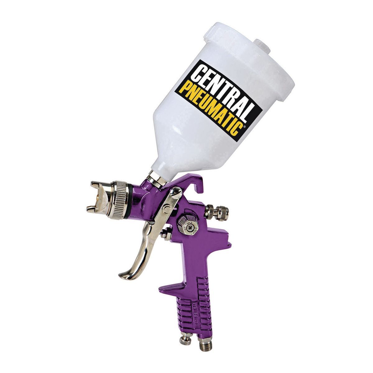

    The purple one

  7. I used the purple gun for etch primer and filler primer on one of my cars, as per the previous post figuring it was going to get sanded. Both primers laid down well. Painted some garnish moldings later with their touch-up gun, in which I was surprised how well it did.

    I’ve only done matte and primers with my Purple guns. Probably works better than my self taught skills show.

    IF, you get the purple gun make sure you dis***emble it and clean it well.
    I was amazed at the junk (***embly lube) inside it.
    It doesn't come with a wrench for the nozzle and none are sold separately. I made one from from some 1/8" flat stock.

    This ^^^. Mine was all sorts of ****ped up out of the box. I also replaced the o-ring (got spares too) where the reservoir attaches. I got it for around $8 back in 2015 and was ready to chuck it after I was done with it, but was able to clean it to my satisfaction.
    I did all of my interior with it, Duplicolor white for the floor pans and GM metallic black for the dash and garnish. I did the primer with spray bombs, wet sanded all that and used the HF gun for the finish. I was surprised how well the paint went on.

    The $15 HF purple gun can be used to lay down a really nice paint job by a good painter. My main complaint against it is that the trigger is stiff compared to other guns and that can cause some old guys like me with arthritis in my hands problems.
    I bought an Astro for less than $100 that has a trigger that is smooth as gl***, a wider pattern than the HF gun, uses less air, and is easier to clean (smoother inside.)

    Ha! I tried to clean my first one, after 20 minutes of putzing around I thought “what the heck am I doing “?
    The next time I was close to HF I stopped in, saw they were marked down on sale for the 10 dollar or so price, bought three.
    I do clean and keep the cups. Have to look in another drawer to see what other parts I keep also, I don’t spray very often, but after sanding, masking, spraying…I’m done. Pretty much all of the gun goes in the pile. My grandfather would whack me on the head several times with his cane if he were around and saw me do it.

    most of my friends and I see alot of you tubers will buy the cheap purple one, they have good luck with them for a one or two time use. Even bad chad uses them. his girlfriend brought him 50 of them one time when they were on sale. Cheaper to throw them out after each use then it is to spend the money on cleaning them.
    That is the problem with them, paint guns don't get cleaned out right. You can buy a thousand dollar gun but if you don't clean it out right, it will work just like a $10 gun then after 1 paint job and poor cleaning. .

    I agree, but why spend time and effort and money to clean a 10 dollar gun, when you’re done, it’s still a 10 dollar gun, you could have been cleaned up and ready for dinner by then;)

    Oh, I totally agree why clean a cheap gun and if you are not going to clean it out right then don't buy an expensive gun to start with. .

    I used the cheap purple gun for all my primer and epoxy sealer. But when it came to painting my car I bought the $150 Spectrum. Not their highest priced gun, but it worked extremely well for me.

    I have bought cheap HF guns in the past to shoot glue out of. I usually knock paint guns off the table and break the neck. They never need to cleaned out, just put more glue in them and shoot. I use it often. Sometimes, a few days go by or even a week. The last one I bought (a couple weeks ago), it shot the glue in a 45 degree angle from the tip. Tried a couple things and chucked it. Went to the parts store and bought a 75 dollar gun. HF has failed me more often than not. Like 75% of the time.

    The cheaper guns are built with unhardened, low alloy easy to machine aluminum.. This erodes away faster than the tougher conditioned surfaces in your premium guns. The accuracy of the machining of any guns should be consistent regardless of price point. The ability to provide a consistent spray pattern with adequate paint atomization will go away faster with use. Cleaned Initially and trial adjusted, the cheaper guns will get it done with the skills of the average hobbyist and last for the occasional paint job as well. A fine painter will get annoyed compensating for wear and a production shop will go through them quickly. Paint is more abrasive than you would imagine..

    I follow a guy on FB who treats the purple ones that he buys by the case on sale as consumables. Says outside of pre use cleaning he never cleans one. Uses it for a painting session and tosses it. He will do a room full of body panels at one time though. On the other hand I follow along on a group that quibble over what 500+ gun to use. The paint jobs they do go for more than the trucks he builds do though.

    That makes a lot of sense. You get the quality you pay for. I figure the HF guns are good for one or two complete jobs, where a higher quality gun like a SATA or DeVilibis should be good for several jobs before it needs rebuilt. That being said, for a hobbyist like most of us, a mid range priced gun would probably meet most of our needs a long time.

    I use a purple gun a lot, but I also shoot a lot of single stage enamel for non automotive stuff. I ran thinned latex thru one last month to do interior house doors, yep, worked fine. I've never had an issue getting a good spray pattern out of them. Have drilled the tips for more flow - works fine if you lap the needle in with a drill and valve compound - wanted to see if it would work
    Automotive paint, I use nicer guns.
    It only takes a few minutes to clean a gun.
    Purple guns, I just clean with gasoline :D
